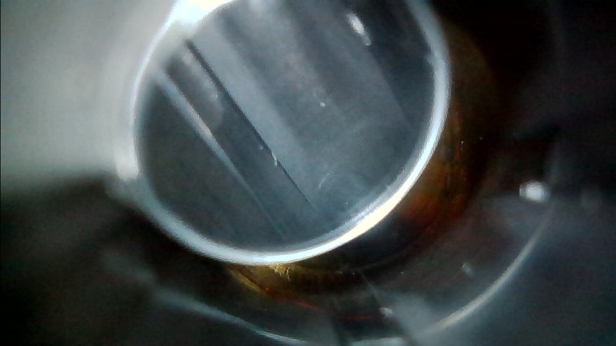

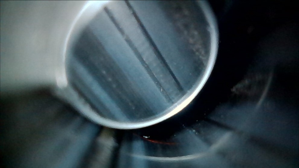

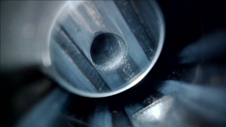

The ARC has a very good barrel life, it rivals the .223. It is said that the ARC will get 10,000 rounds plus out of a barrel. I have one with 4000 rounds through it with no real signs of wear or erosion, fire cracking.
Buy the one you can get ammo for and know you made the right choice. If there is an intrinsic accuracy difference, most shooters won’t be able to shoot the difference. Over the life of a barrel, you’ll spend an order of magnitude more money on ammunition ( regardless of the choice).
After 4000 rounds of fire.
Barrel life. A barrel can “look good” and shoot like crap. A barrel can look like crap and shoot well. Some guys will have a barrel go from 1/2 to 3/4 moa and call it shot out. Others are happy with sub moa, or sub 2 moa. Barrel life claims are all over the place because there is no agreement on the meaning of ”shot out.” I mean everyone can agree that a barrel with no rifling left, and that throws fliers into the next county is shot out.
