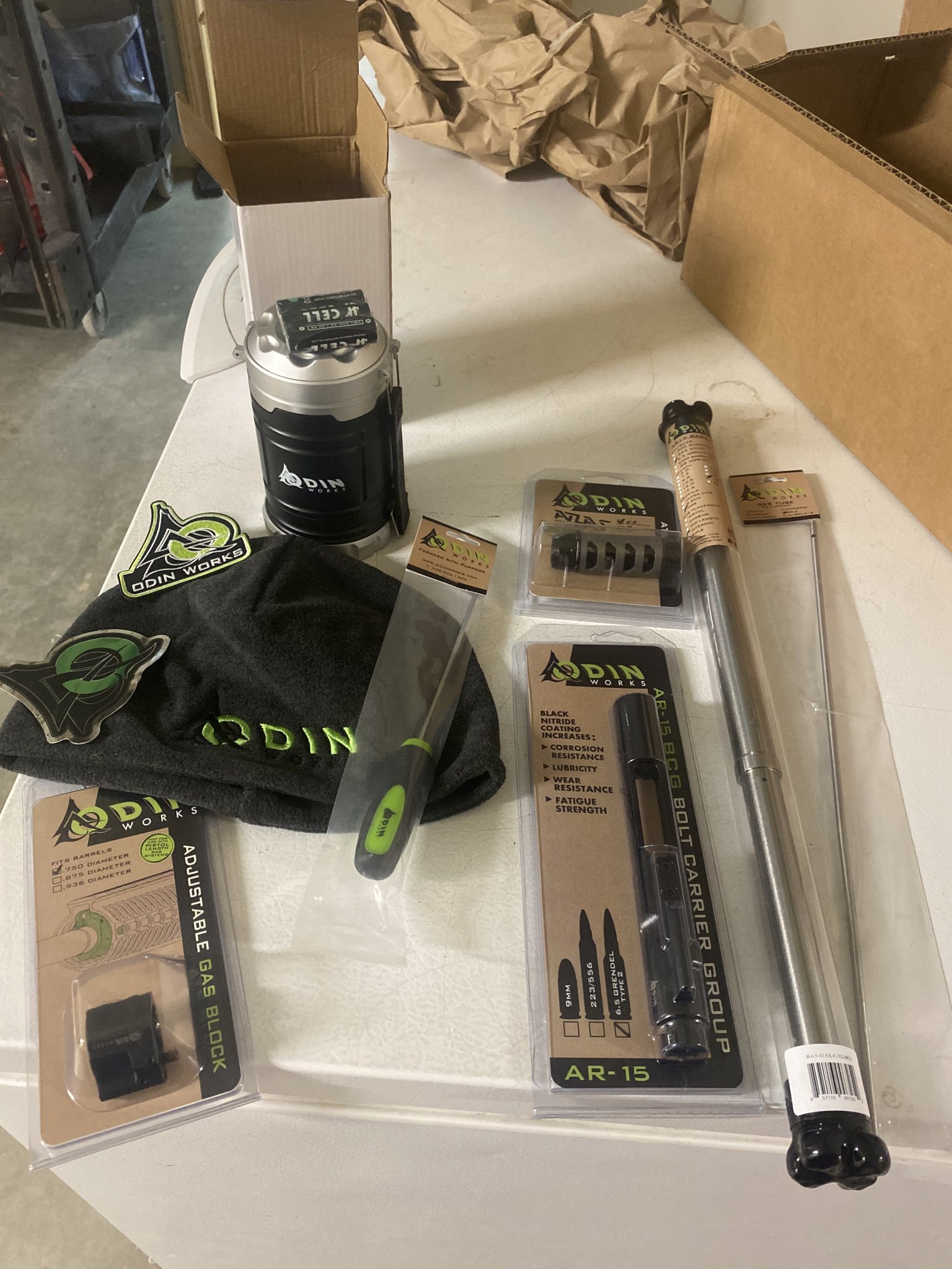

That little brown truck showed up with my barrel, BCG, and some other goodies...:p:oops:(y)

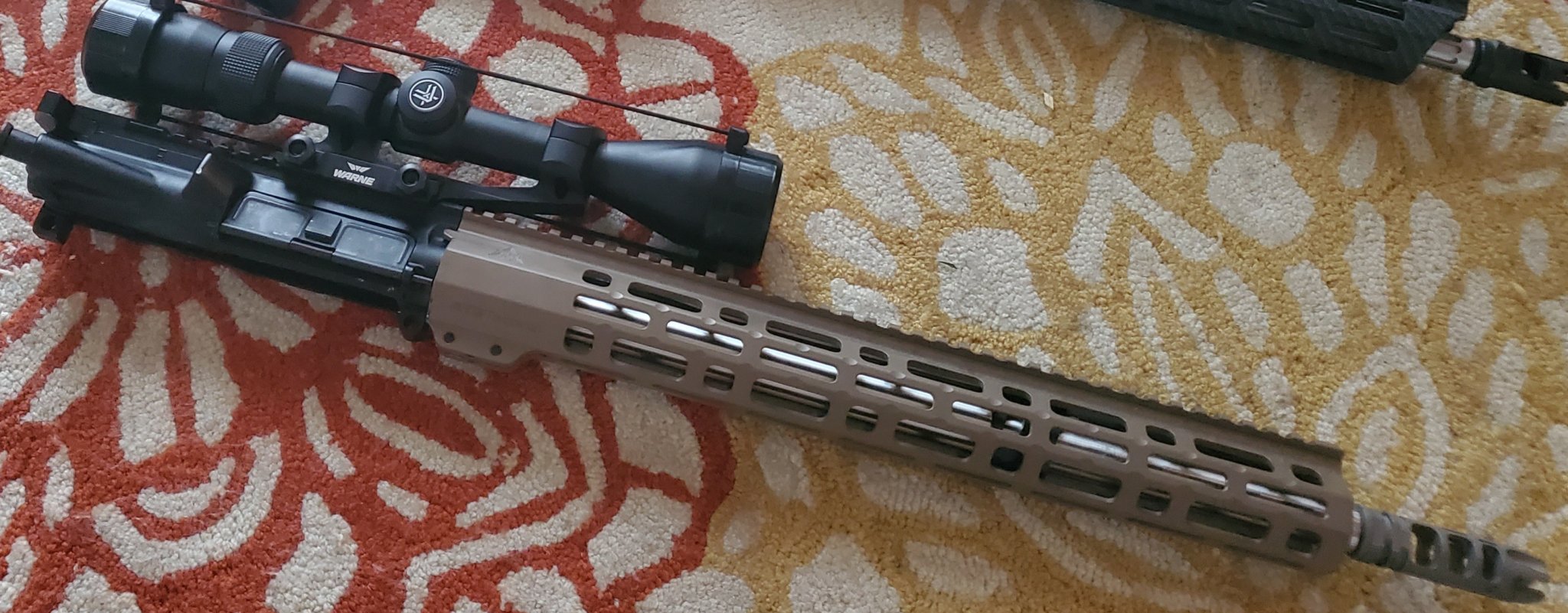

I got a Black Hole Weaponry 16" barrel in .264 LBC (type 1 Grendel, uses a 7.62x39 bolt) put it on a BCA upper that I lapped, with a Wojtek adjustable gas block and It's been great. When I first sighted it in at 100 yds It took me a mintue to find my 3rd shot. This was 120 gr PPU.. the last of the one box I had.
