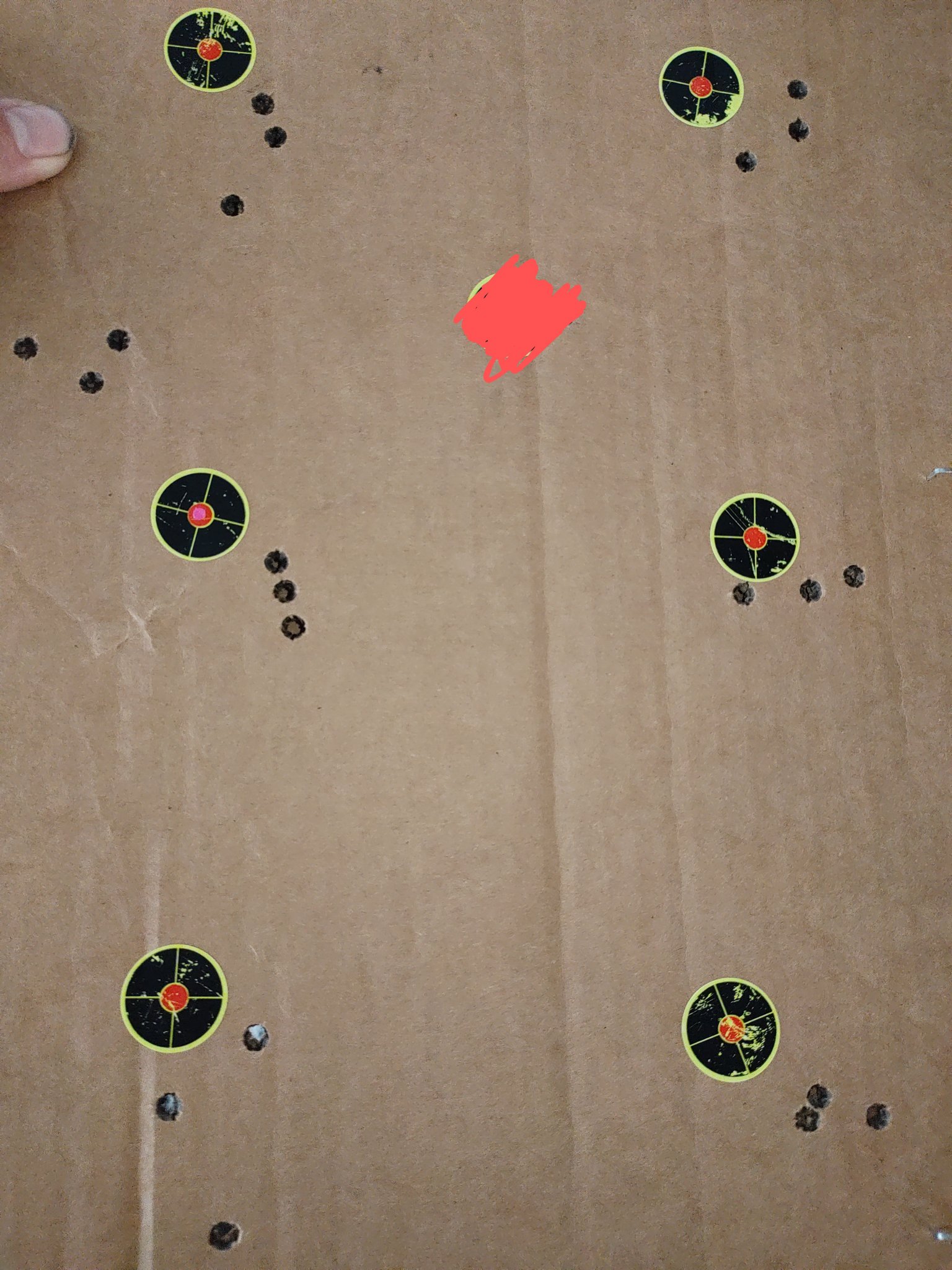

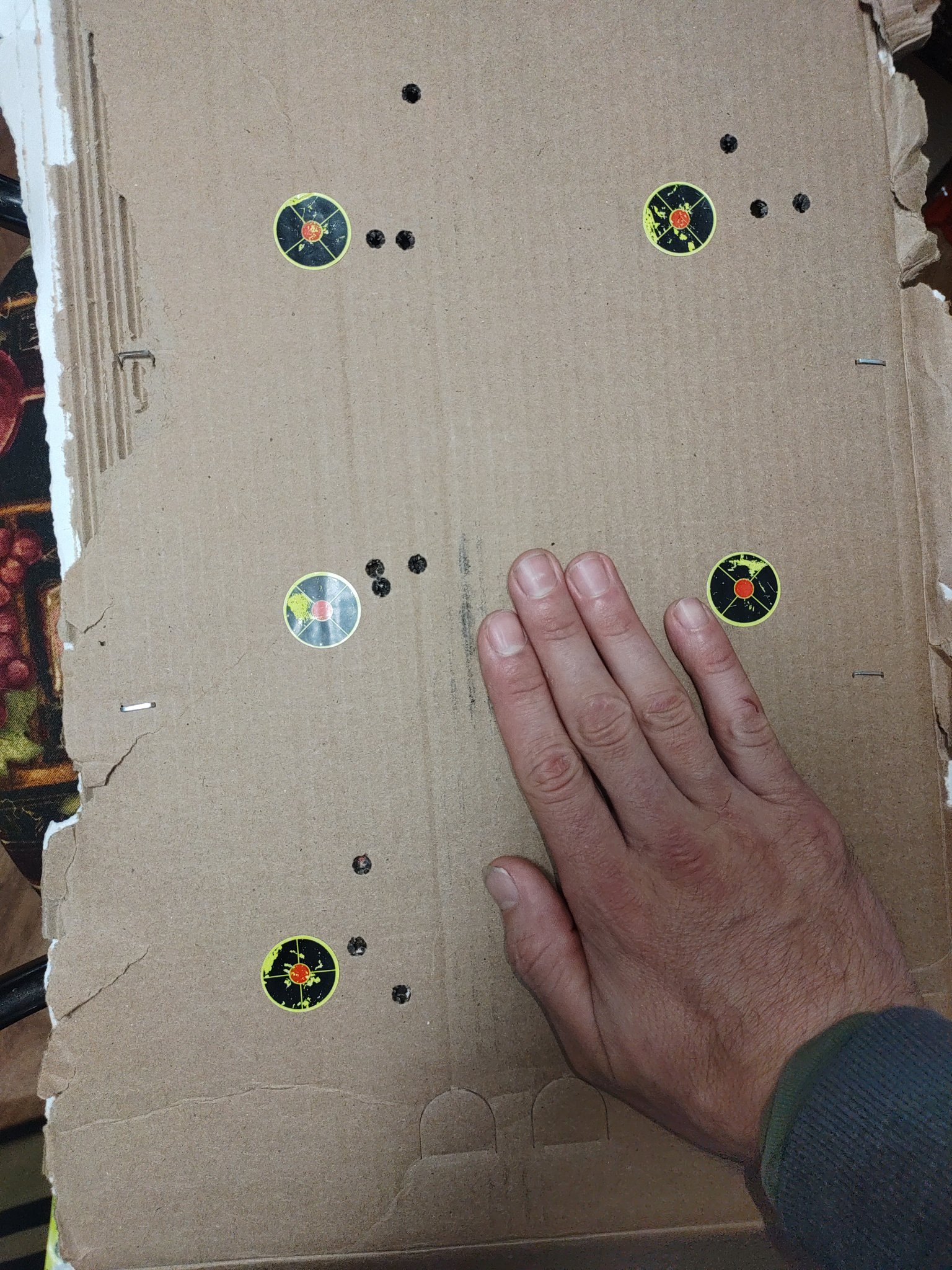

    So... I have a 6.5G. Criterion 22"Hbar and CMC 2.5lbs trigger. Everything else is pretty AR standard. Shooting off a bipod and rabbit ear protektor rear bag off a bench.
    I'm trying to keep my loads as consistent as possible, powder charge, neck tension, seating depth etc. Using Hornady brass, H-335 powder and 120 grain ELD-M. First time I took it out, I had them loaded to the jamb point, groups were
    .247., 875., .454, 1.241 1.35 etc. Pretty much all over the place.
    took the gun home refusing to assume it was me. Found a really bad carbon ring with my bore scope. Cleaned it. Loaded some rounds .01 and .02 off the lands. Took a week off and just dry fired/worked on fundamentals, until I was confident. Went to the range today and I felt all the shots felt good and below are my groups.
    Questions: is this me and my fundamentals?
    is H335 better with bullets in the 80-100 grain range? Any suggestions on how I can make this load more accurate?
    anything anyone can tell me by looking at these groups, other than how horrible they are? The 3 groups that are more consistent are the ones loaded .01 off the lands.
    thanks fellas
    What charge weight and what velocity?
    Have you tried factory ammo using either the 123 ELD-M or Sierra 120 Match King?
    Reactions: Dildobaggins
    27.2gr. I haven't tried any factory ammo other than federal 120gr OTM. It was sub MOA. It was last year. I'd say it was around .75. I just ordered a Chrono, should be here next week. I also noticed the brass is ejecting at like 5oclock.
    Gas system length?
    Buffer weight?
    Velocity?
    OAL to be at lands?
    Pretty sure 120 ELD-M at 0.040-0.060 is going to work really well. Zero reason to be at lands, 0.010 or 0.020” off lands, IMHO.

    The Federal 120 is a Sierra and the "barrel tester" bullet for 6.5 Grendel. It shot that fine so isn't a bad barrel at least.
    As @FCS is pointing out a little slower velocity may be the answer, 26.6 gr should put you around 2443 fps but at a 1.2 ms barrel time.

    That sounds good to me. I'll try backing off the charge weight. I don't know why, but I feel like when I'm reloading (which I'm still new to. Only a year in.) That I should try and archive max velocity without seeing pressure signs. Funny you say that. Some of the best groups of my life were in my .223 with 21.6gr of H-335 and the bolt wouldn't lock back or cycle got great groups with pretty much every powder charge though. That's with my WOA barrel.
    The problem with Grendel is by the time you see one of the classic pressure signs (smears, flat or cratered primers) you are already way way past a safe pressure.

    Great info man. Thank you. I'll be hitting the range Monday or Tuesday. I'll try loads in the 26gr range and seating them a little deeper.
    So tomorrow I'll be going to the range. Lower powder charge and bullets seated further back. However, I think I've found a problem with my fundamentals. I've left out a rather large detail. I'm new to the range. Every time I've ever shot, it's always been prone in my back field and I'm able to load the bipod. When I was shooting off the bench, the bipod was infact jumping and I was not loading it. That might explain the small and large groups perhaps?

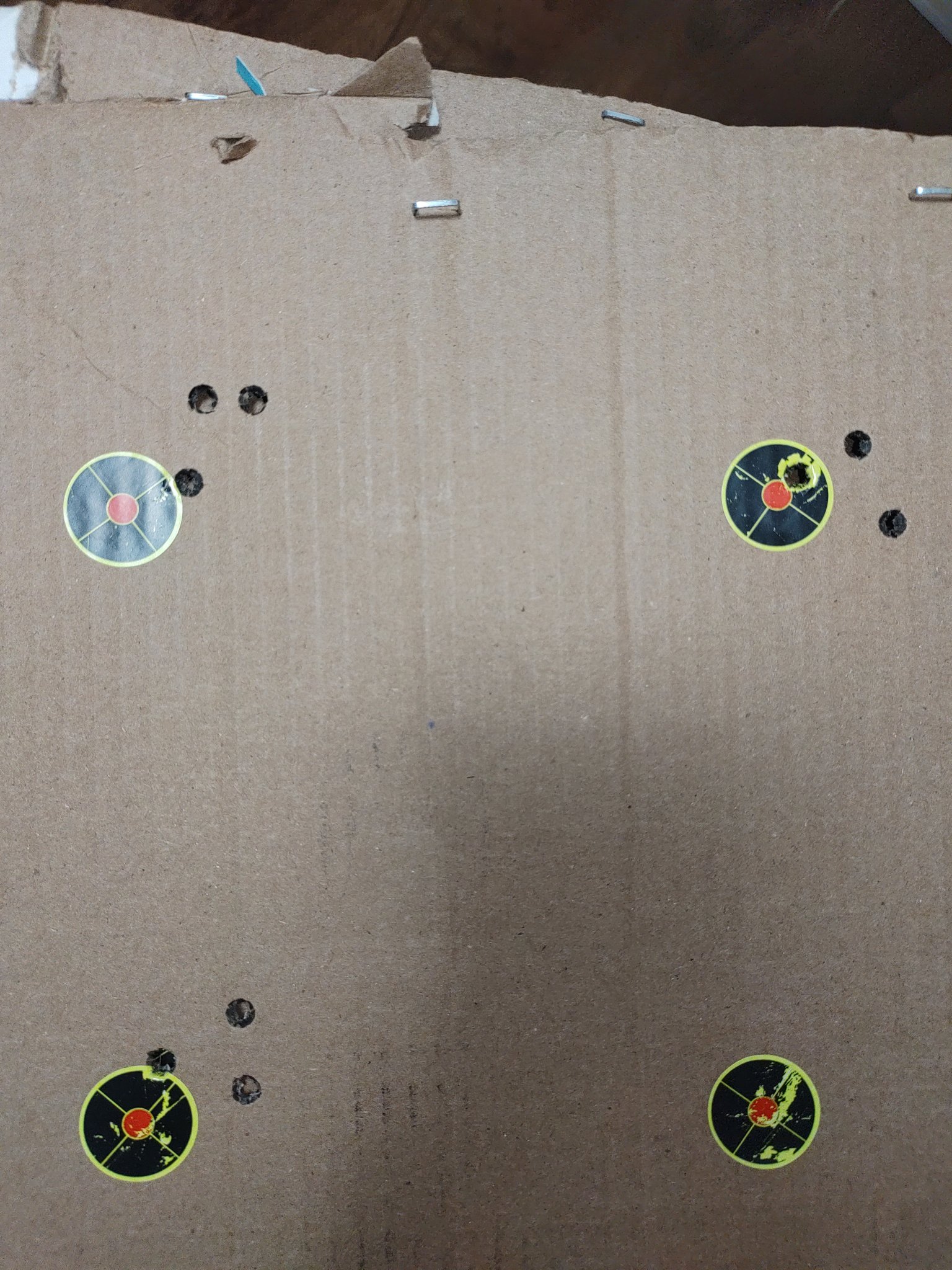

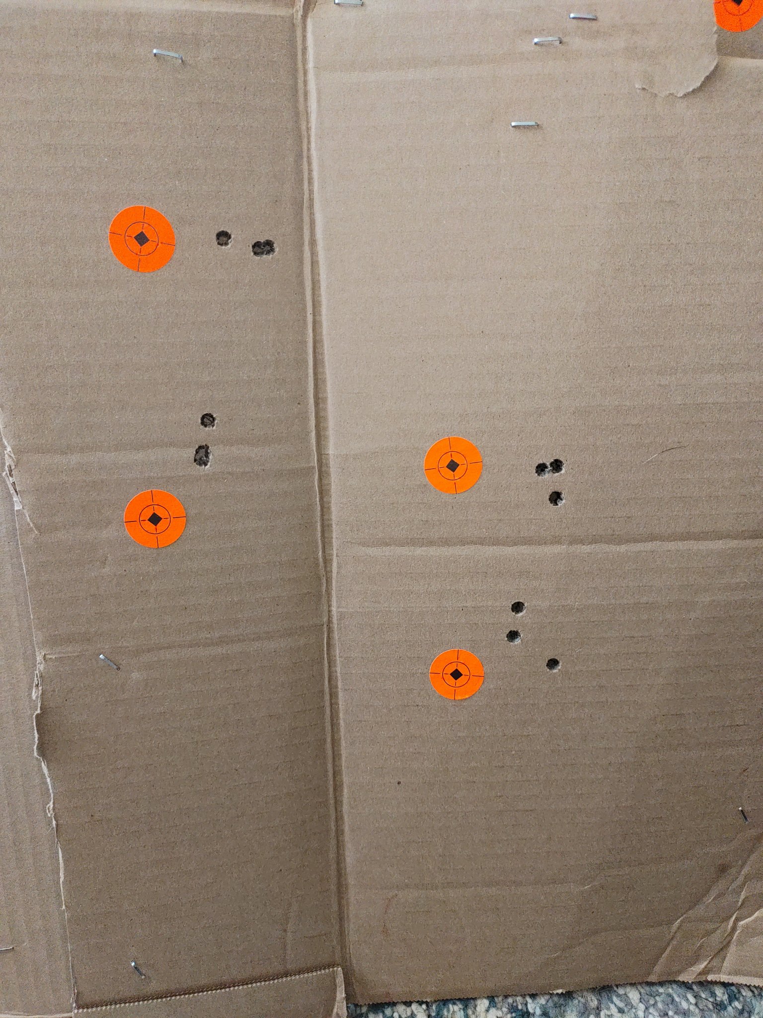

    So the crappier of the two groups was with my old load. The other one was with backing off the powder charge to 26.6. I suppose the groups were smaller, and about half are sub MOA, but I'm still not happy. I'll be ordering different bullets tonight, and give the H335 another shot. Perhaps my gun just doesn't like the projectile or powder? When I shoot my 223 with a WOA barrel 99 percent of the groups are sub MOA, and half are under under 1/2 sub moa. wish I knew what was going on here.
    2 comments:
    - Primers are a crappy estimate of pressure. They can be affected by headspace just as much, causing false pressure signs. And different primers will show different levels of flattening or cratering. Don't rely on how your primers look, that's amateur hour.
    - 3 shot groups are fine to show when a load doesn't shoot well, but if you start seeing tighter groups you need to put more rounds on target to know what it's doing. And don't just shoot 3 (or 5) shot groups at a bunch of different targets. Shoot them at the same target.

    Try some WAY off the lands. I load mine mag length and and pretty pleased with the results.

    When I think I've found a load I will do more shots on the same target. To be honest. I wasn't even going to shoot three. After seeing two, I knew the group couldn't get any smaller, but I wanted the data.

    I just ordered more bullets in 95 grain. And 120 eldm. I am going to go .06 off the lands like @FCS said. I loaded a dummy .06 off the lands and it was very short. Measured my jam point 10 times with a Hornady OAL guage. CBTO Longest was 1.8640 shortest was 1.8620.
    .06 off the lands is very short, but I can't see how it could possibly hurt.
    Should I stick with a certain powder charge and test seating depth and then play with powder charges?

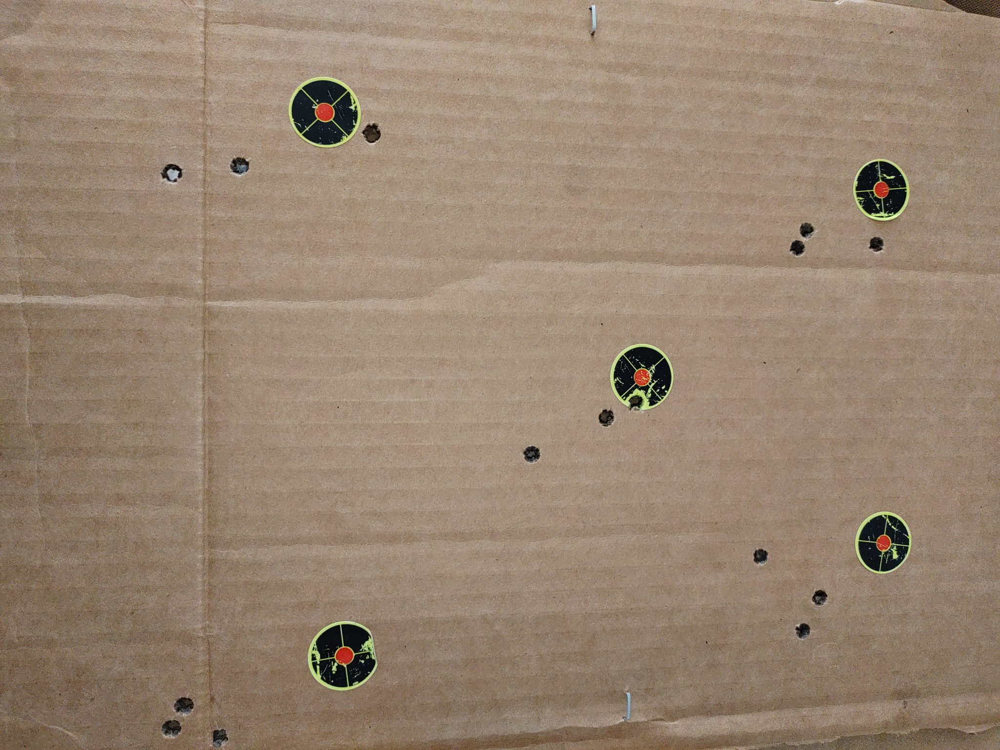

    One of the last pictures I posted had more consistency that was with a 26.6 charge. I only did 3 groups with it though because I ran out of bullets

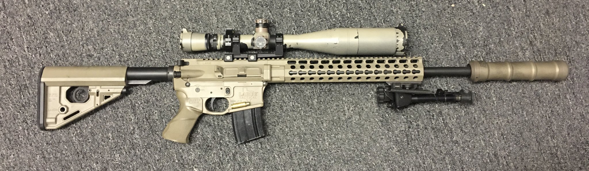

    120 Scenar
    Slightly slower burn rate powder than H335
    5rds @ 100
    6.5 oz buffer
    18” LaRue upper w/TranQuilo attached
    Mk4 6.5-20, TMR, FFP in NF Unimount

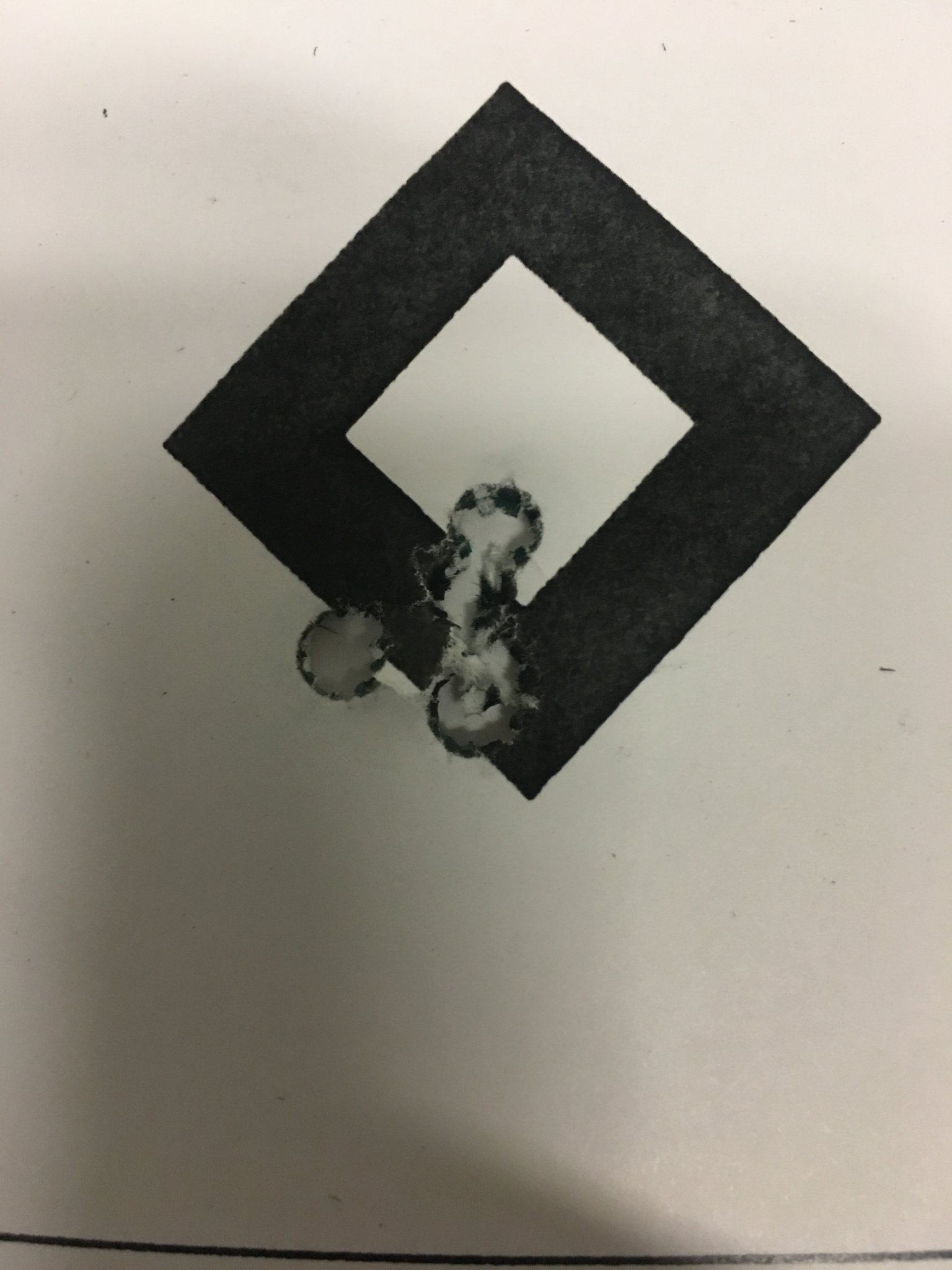

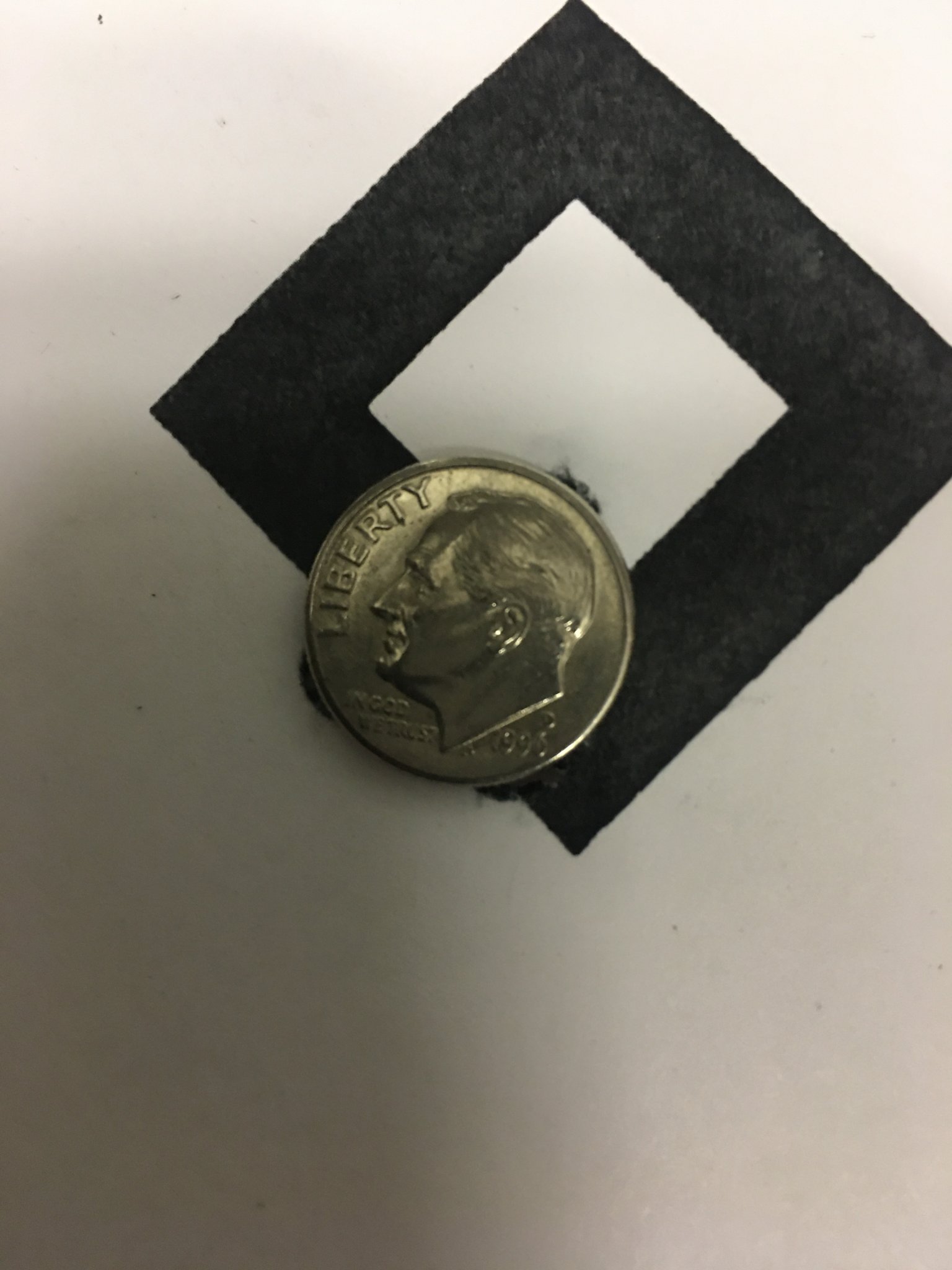

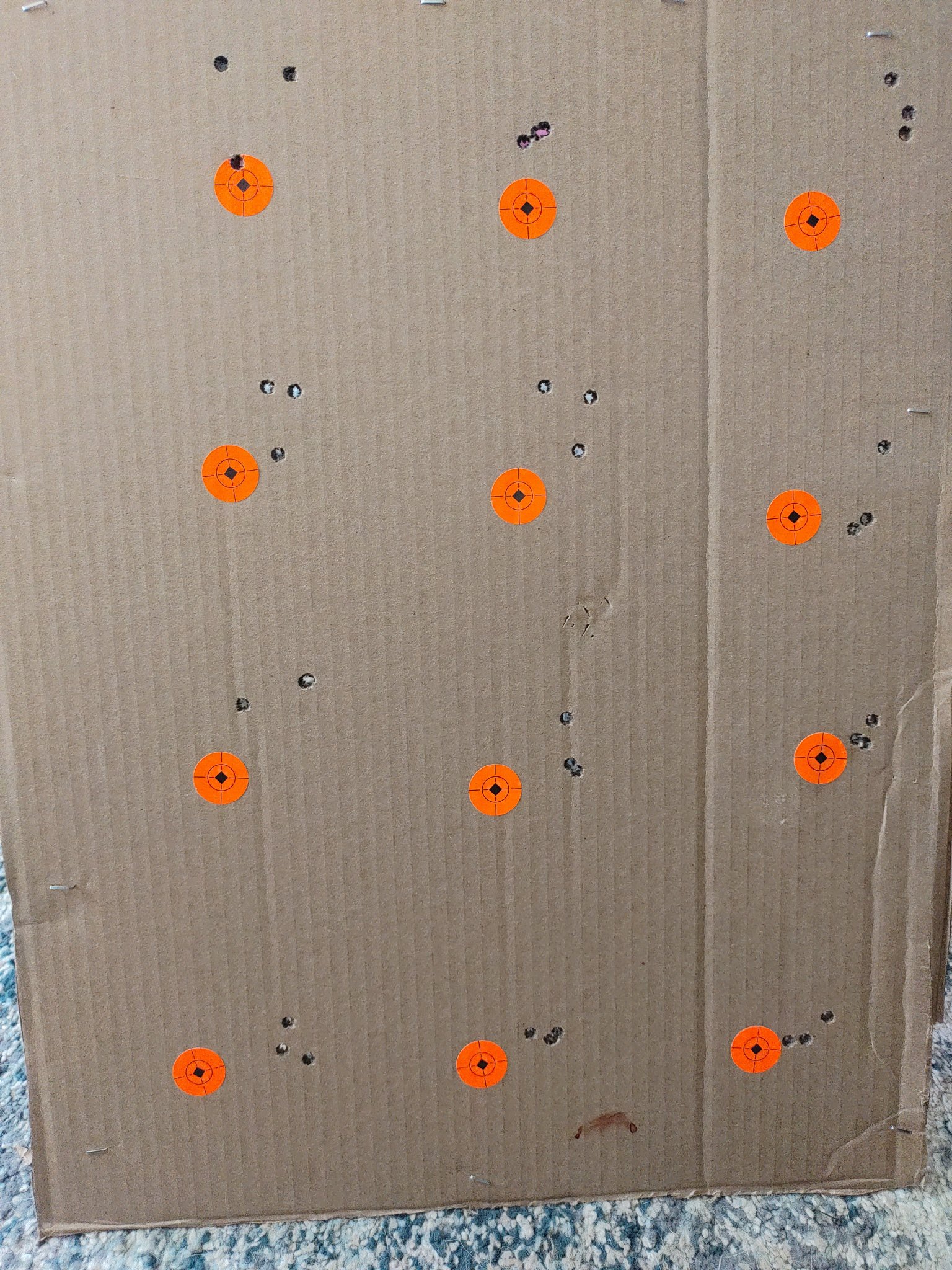

    So I went to the range this morning. Forgot one of my ammo boxes. I shot the 120 eldm seated .04 from the lands, and powder charges from 26-27.2
    The lower end of the charges definitely did better and it was more consistent. I shot 2 groups of 3 shots for each charge. I need to learn to relax. I'd get two holes touching and get excited and then rip the third shot and pull it. First group in the top left were fouling shots with ammo I didn't seat correctly.
    So in conclusion. A.) Thanks everyone
    B.) The gun is more accurate than me,
    C.) I need to work on fundemtnals and learn to relax.

    I’d say one of the biggest fundamentals to learn here for load development is to stop shooting groups of three. There’s zero reason to split up six rounds into two groups, just shoot all six at the same target. It’ll give you a better understanding of what the load is doing, and fewer lucky groups to mislead you.
    I suppose I should. I just figured if I pulled a shot, I've only wasted 3 rounds instead of 5 or 6. With load development, how many would you suggest shooting per powder charge/seating depth? 5? 10? More? Thanks, brother!
