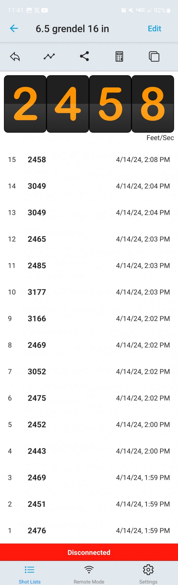

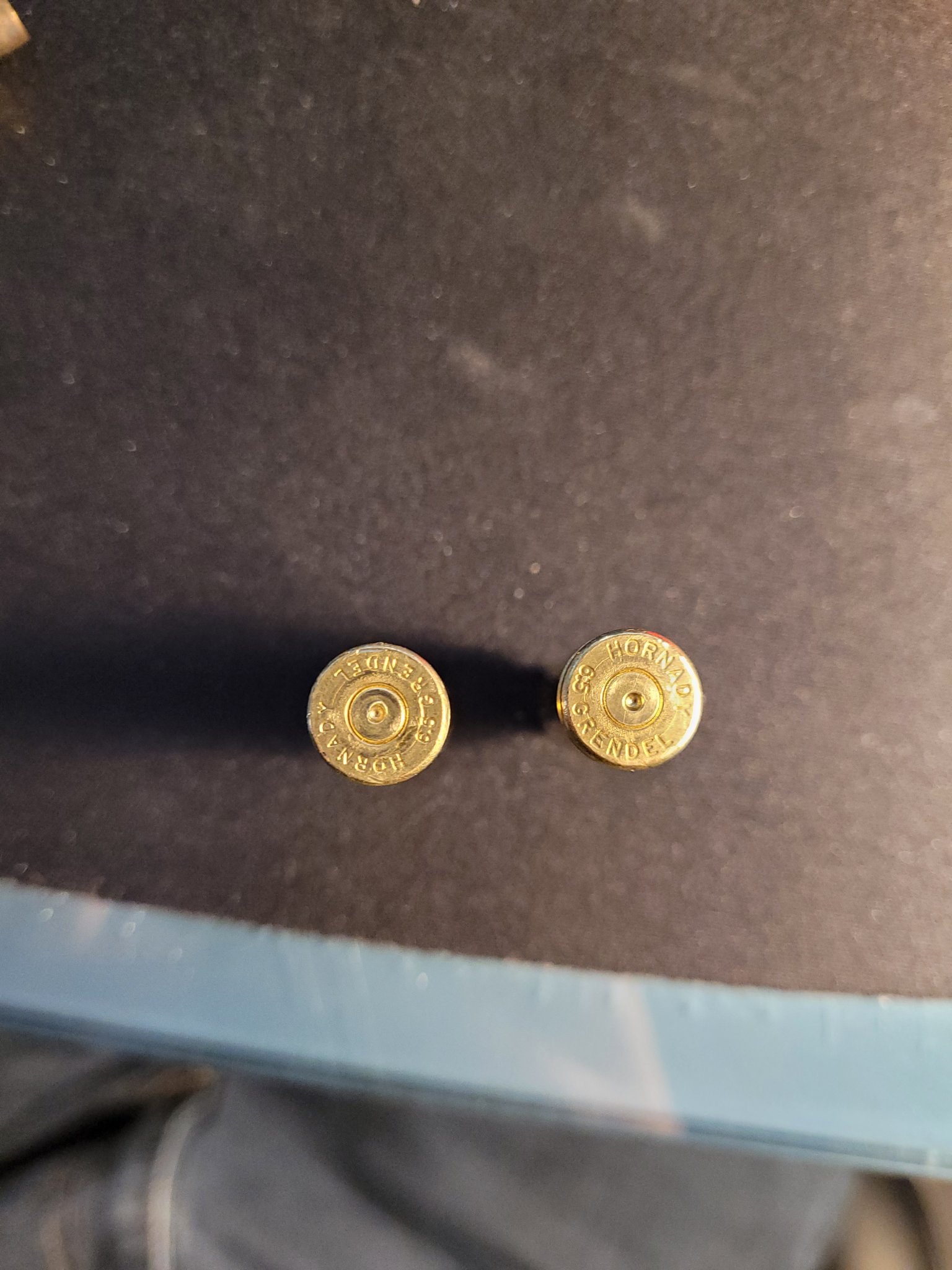

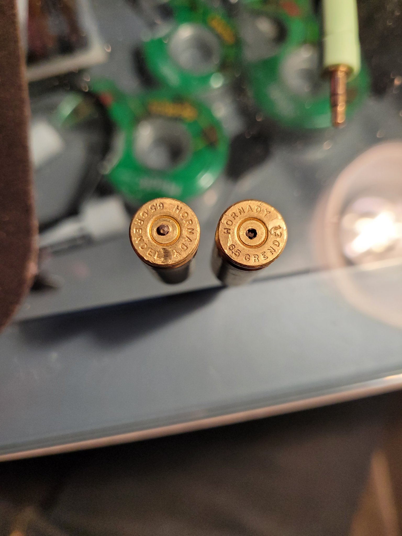

Hey all,
A few years back I bought a 16 inch 6.5 Grendel upper. Ended up not really shooting it much because of ammo and other stuff, and decided I would take it out and shoot it to make some brass this weekend, now that I have a press and dies and chrono etc. So I set up my target and chronograph and started putting together some groups at 100 yds. The rifle shot pretty well, but I ended up with two distinct groups, one .8 MOA and one .5 MOA in the same string of 15 shots, posted below. When I went to check the chrono data (ProChrono DLX, not the greatest I know but has been pretty reliable for me so far), the shots in the .8 MOA group were right at 2400 fps, but the five shots in the .5 MOA group were moving at 3000+ fps. I then took a look at the brass, and most were ok, but a few had bad pressure sign, and two had pierced primers. This is factory Hornady Black 123 gr ELD-M. I reached out to Hornady yesterday, they have yet to respond. Could this be anything but a bad ammo lot from Hornady? I've read about carbon rings in throats, bad chamber dimensions, fouling, etc. and want to know if I should scrap the barrel or just continue the RMA/warranty process with Hornady?

That was the whole box, I didn't chrono the first five sighters at steel. But yeah one single box. Carbon ring is the only thing I have read that could maybe cause it but I have no clue what kind of velocity swing that would give, and I would think that once a ring is present, it would cause all the ammo after that to be high pressure, not the onesie-twosie type of inconsistency I saw. I couldn't tell a difference in seating depths visually when I pulled them out of the box, but I can't imagine even jamming to the lands would cause 700 fps ES/that much overpressure but I could easily be wrong...

You should be in the 2440-2460fps region with a 16” and 123gr ELD-M.

I don't have any more. Double charges seem unlikely, I suppose the powder swap seems most likely to me right now. Grendel has a case capacity of 2.3 CC, and from my limited understanding a double would well overflow that, if 30~ish grains gets 2500, and 30 gr is 2.xx CC already with common grendel powders. Unless someone with quick load can plug in what the velocity would be out of 34 or so gr that would be max capacity. The box I was shooting listed 2580 MV, so that means I'm losing ~15 fps/inch of barrel length which also seems inconsistent with what most say I should be losing per inch. Another reason to think fast powder where it shouldn't have been?
I seriously doubt your cases would still have a primer in them if it was really 123g bullet going 3000fps. I also doubt it would eject the case vs locking up the action.
Grendels tend to mark up case heads.
A double charge isn't going to fit in the case.
Peirced primers could be the unknown bargin bun upper. That is the first place I would look.
That brass looks like two diffrent vintages of Hornady brass.
The rounds came out of the same box that I bough at LGS a while back, so while I see the difference you're pointing out, I don't have an explanation for it. I did manage to find my data on the gun, I bought it from a GB store called KM Tactical as new, for about 300 bucks, with the BCG. I still think the upper itself is BCA, although they have no label on the website, the prices match and BCA was the only other manufacturer making a gov't profile Grendel in that price range. Carbine gas. In some of the other reading I've been doing...either the Grendel has a set back bolt face OR a shortened firing pin. I don't have my calipers handy, but I will measure both next time I get the chance. From what I understand, the standard firing pin treatment can cause pierced primers, although that still doesn't explain the velocity difference, or the presence of two distinct groups forming, very separate from one another.
