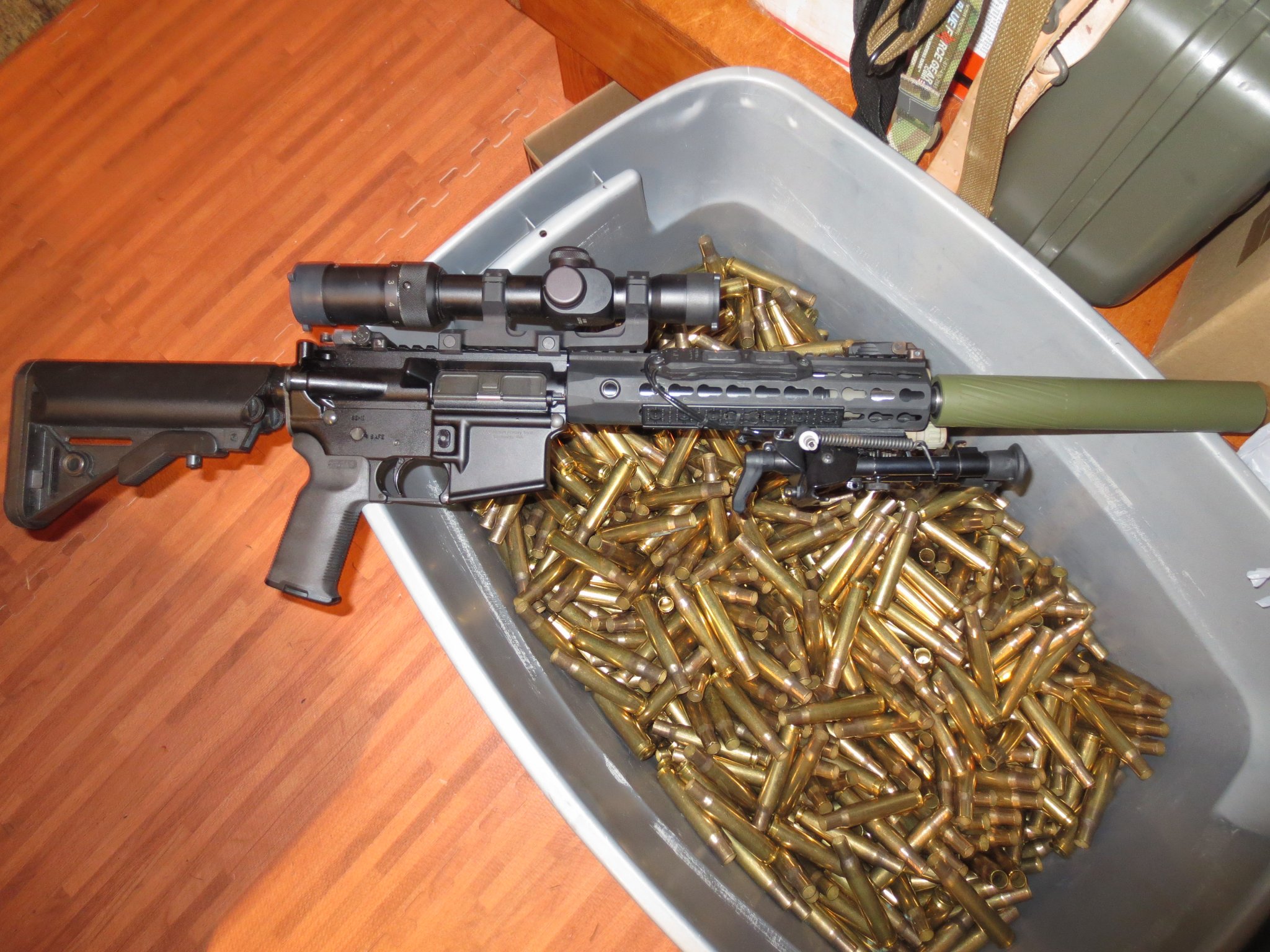

Here's the 11", don't have a picture of the 20" off hand. It has the JP carrier but I think it has an AA bolt. Noveske receivers. 1-8x USO in the Badger mount is perfect for it (I think) works like a dot on low and a tree at higher mag. KAC URX4 and sights. Can is the 9" TBAC Ultra 6.5 but also have a 5" in .30 for it too. Has a PEQ and small Surefire not shown with the dual switches. Yeah, really been wanting to shoot this one for a while now, it's without a doubt my most interesting SBR:
