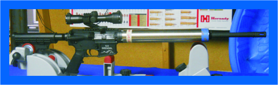

That's exactly what was required by my 20" Spinta barrel and resolved problem.
