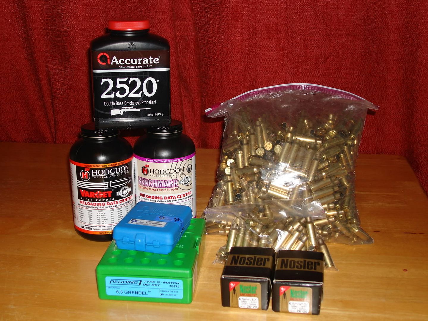

I am just about to dive into all of this myself. I have a few items to play with:
Not sure if it has been mentioned, but know that Wolf brass uses large primers when all the others are using small. Keep your eye out for deals on the 6.5 components. I was patient and was able to get my Redding S dies with a few bushings for $150 and almost 700 pieces of once fired brass for about $75.
