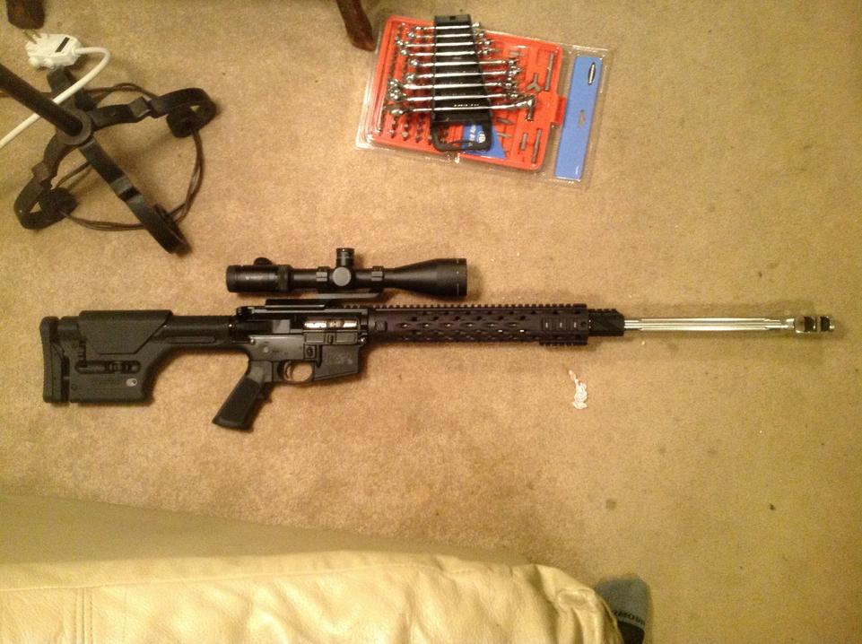

    I have a Precision Firearms 6.5 Grendel that I have had for a few months now and have finally got through the recommended break in period specified by Mark H the owner of Precision. I have around 100 rounds through it now. On average It shot .5-.75 moa every group through break in. I think the worst group was around 1 moa and that was me causing that. So it is basically my most accurate rifle I own.

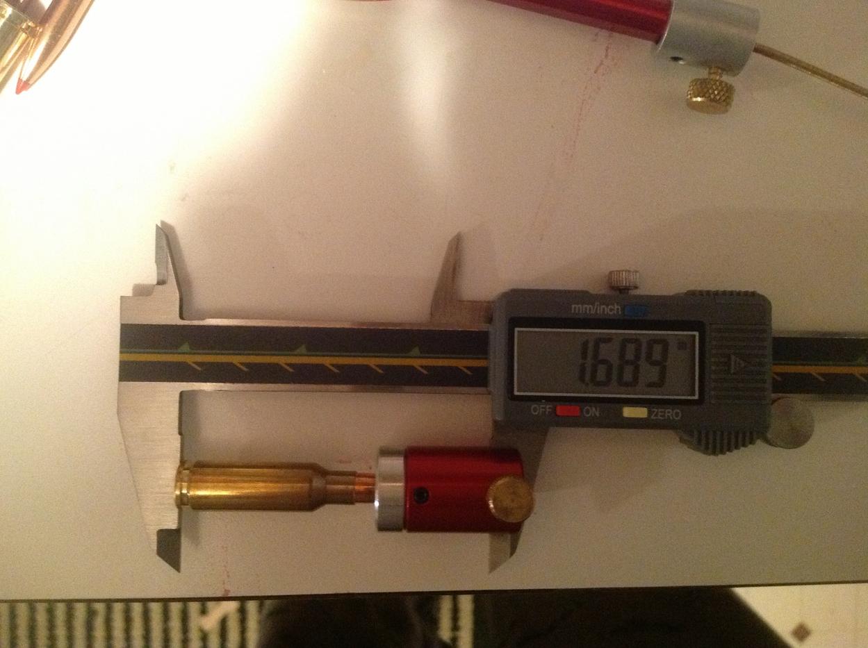

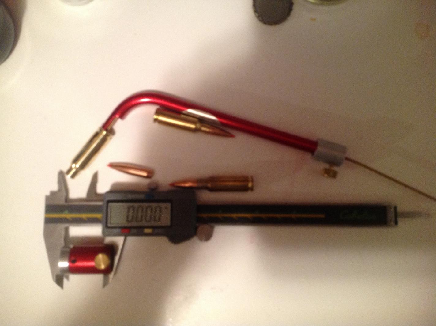

    I reload and have recently began to use a few of Hornadys reloading lock and load tools. I have been measuring the bullet jump using the bent col tool and the bullet comparator for accurate readings involving distance the bullet travels before it reaches the lands of the rifling.

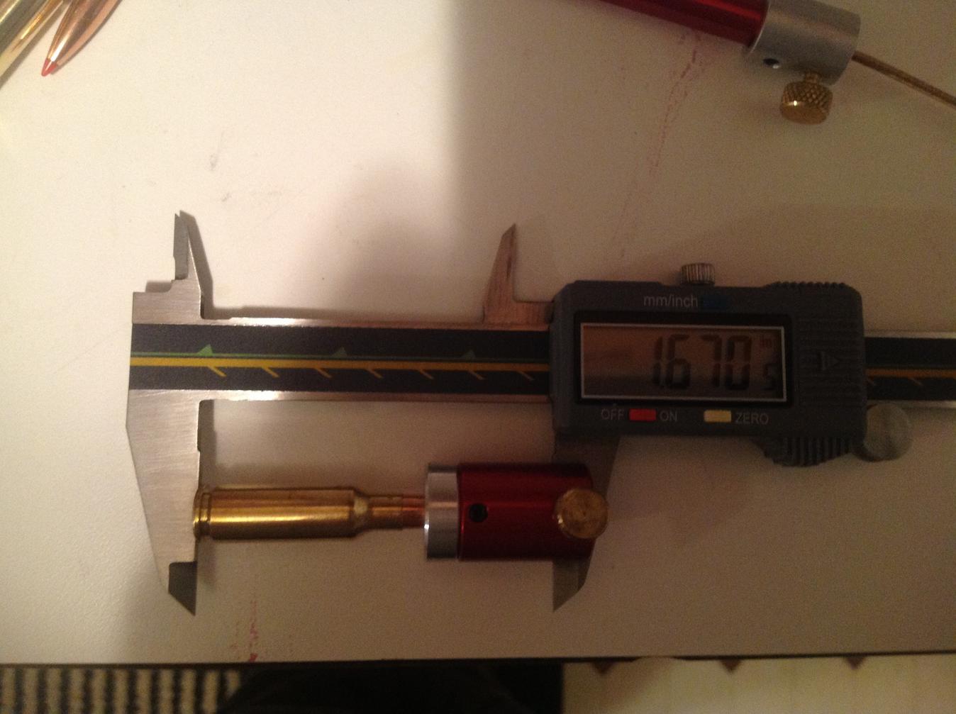

    I had not had a chance to measure the distance in the Grendel because I didn't have the threaded 6.5grendel dummy case to fit the COL tool. I sent hornady a fired case and $15 and they made me a custom one fired from the gun it will be measuring later. I received this case today and measured my Grendel.

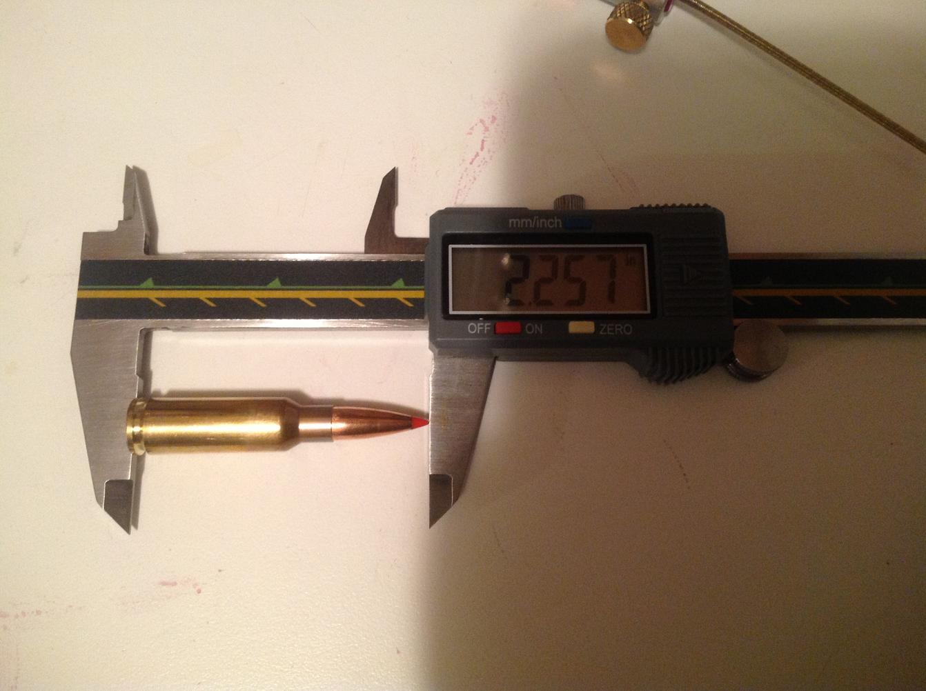

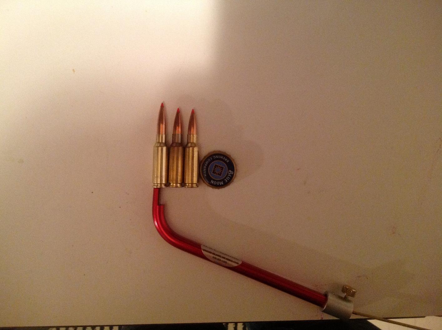

    It has a HUGE bullet jump of almost .2" So my measurement for where the lands are was 1.845 when the bullets are loaded to 1.688 they barely fit in the mag. I have a pic of the dummy round, a hand loaded round, and a factory Hornady round all with the 123gr Amax.

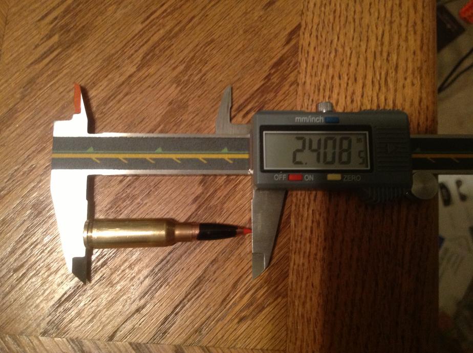

    I zero my calipers on the hornady tool and I use a bullet comparator kit. It uses the ogive as the reference point on the bullet. Not the tip.image.jpg as you can see its not that outa whack. So by the given measurements 2.414 is where my lands start.

    Awesome looking grendel by the way! They are a great shooter for sure! I have hundreds of rounds through mine now and still love dinging steel with it. Its a super round.

    I agree the tools are difficult to get accurate readings, however I found a way that deliver accurate readings every time with the dummy case on 2 different AR's and my SCAR 17. It took a few weeks of frustration before I thought up my method after reading and watching others use the same tools. So I am confident about the numbers delivered. I think I will try your method as well to have a second reference.
    Thanks for the compliment. I will let her know you enjoyed the pic :cool:

    I zero my calipers on the hornady tool and I use a bullet comparator kit. It uses the ogive as the reference point on the bullet. Not the tip.View attachment 20571 as you can see its not that outa whack. So by the given measurements 2.414 is where my lands start.
    Looking at your pics im not sure what your doing. After you run the bullet up to the lands where are you measuring to. Tip or ogive? It doent really matter as long as you stay consistent and not measuring apples and comparing them to oranges. If your measuring to the ogive your OAL will be shorter than someone's that is measuring to the tip. To see for sure, load a blank round (no primer or powder) set the OAL to 2.415 and color the bullet with a black sharpe and chamber it, extract it and look for rifle marks, hard extraction.
    Those pics are just showing how the factory rounds and some hand loads with lapua brass measure up with the bullet comparator. I didn't take any pics of the round measured with the col tool, it was difficult with the dummy case.
    Cool.. If you try the dummy round with a sharpe let us know how it did. I believe your getting your measurment off somewhere. I have a saturn barrel and most of bullets arn't off lands but .005" to .020" depending on bullet. Im sure you'll get it figured out. Good thing is you know it shoot great!!

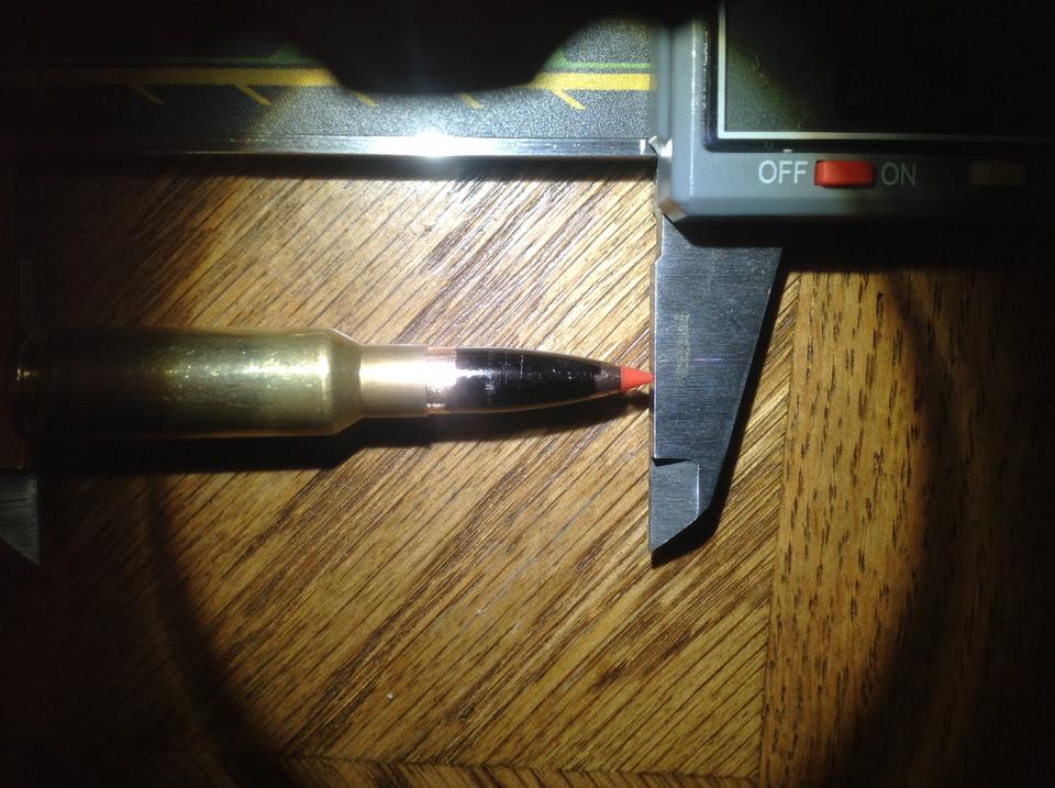

    image.jpg I can see some slight markings, although I don't know what I am looking for. I can see some circular paters in the bullet now what Would think the rifling would look like in the bullet? This is a pic of a bullet measured out to 2.413, after running I through the gun chamber the bullet has been set back to 2.4085. I will post more pics f the before and after of the bullet.
    Under a flashlight you it makes it a lot easier to spot the lands and the rifling.grooves in the bullet. I believe that is what the rotational spiral grooves are...... What are your thoughts? It appears to me that the bullet is getting jammed into the rifling at this length which would prove my measurements being off??? image.jpgimage.jpg
