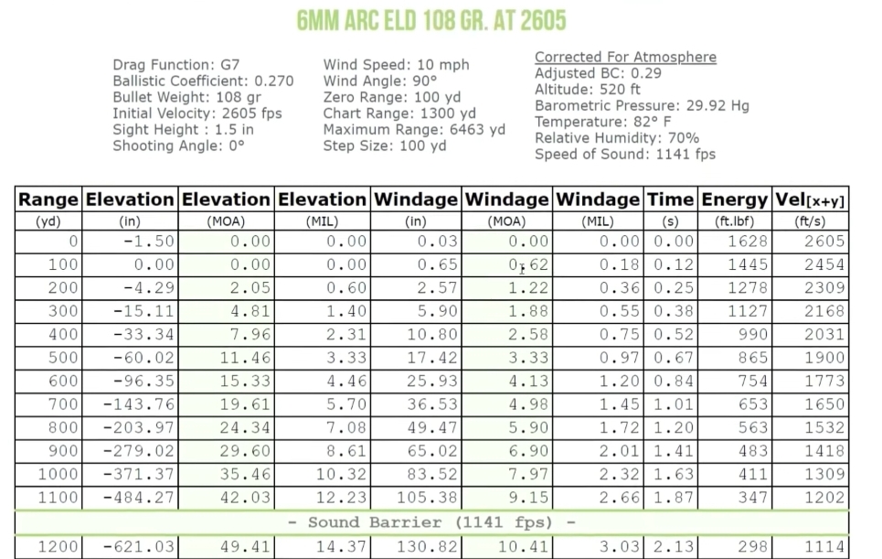

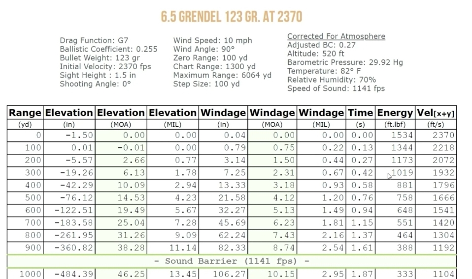

And now here is the info I have. These are velocities from factory ammo for a 16" 6ARC & 18" 6.5 Grendel.
The 6 ARC still has more energy and speed down range. Especially when hunting, you want the speed because the more speed you have the more expansion you can get. Obviously there's exceptions here and there.
Anyhow, I was just trying to make the OP aware. If you reload, those numbers could drastically change of course. As I said, I too went with a Grendel so it is it what it is.
View attachment 7803996View attachment 7803997

What ammo and barrel is that on the grendel? Seems extremely low. I’m getting around 2300 from a 12.5 with any of the 3 Hornady 123 flavors and a 18” is around 2500-50
