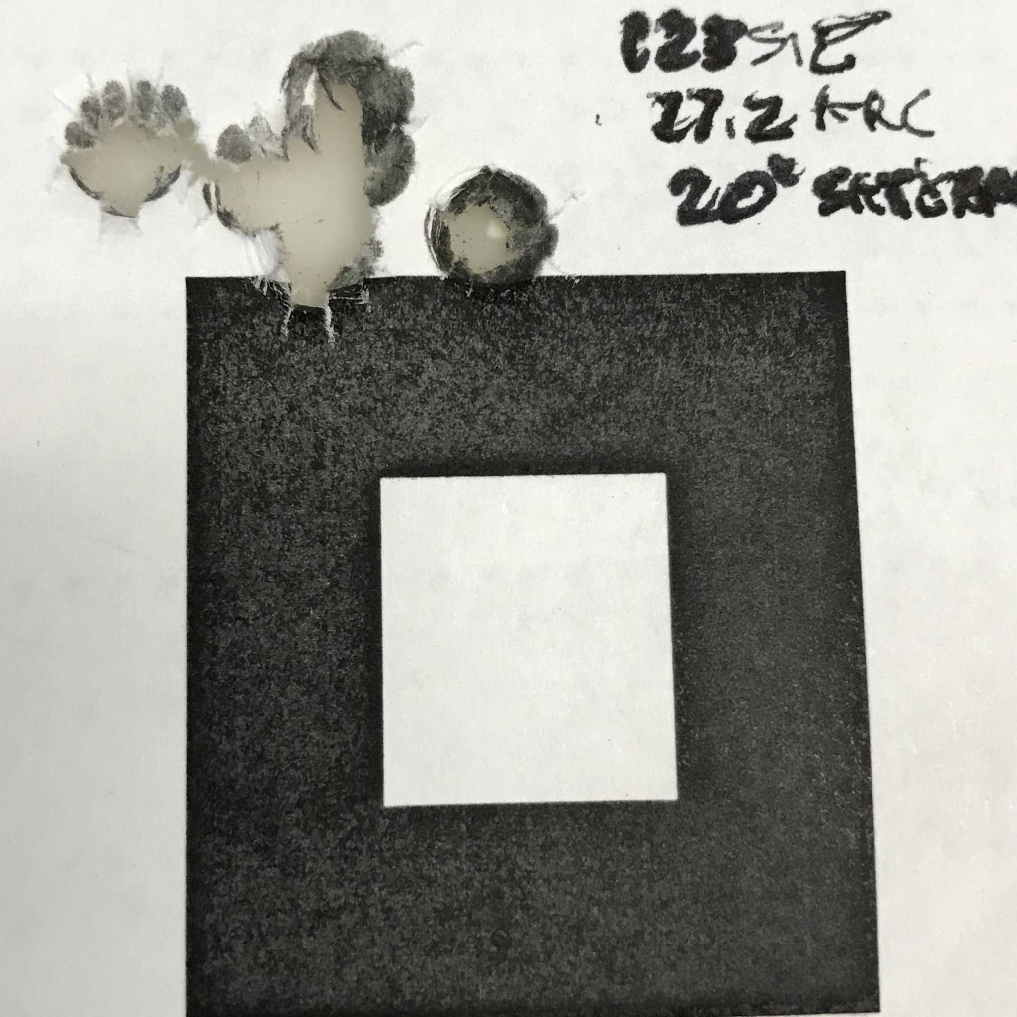

Finally got to chrono some loads that I’ve been more focused on accuracy than speed. Worked up in 20” very short throated Satern, but had to test in equally short throated 24” Satern.
123 Sierra BTHP 27.2 AR Comp CCI41 2.23 OAL
2530/16ES/5.7SD

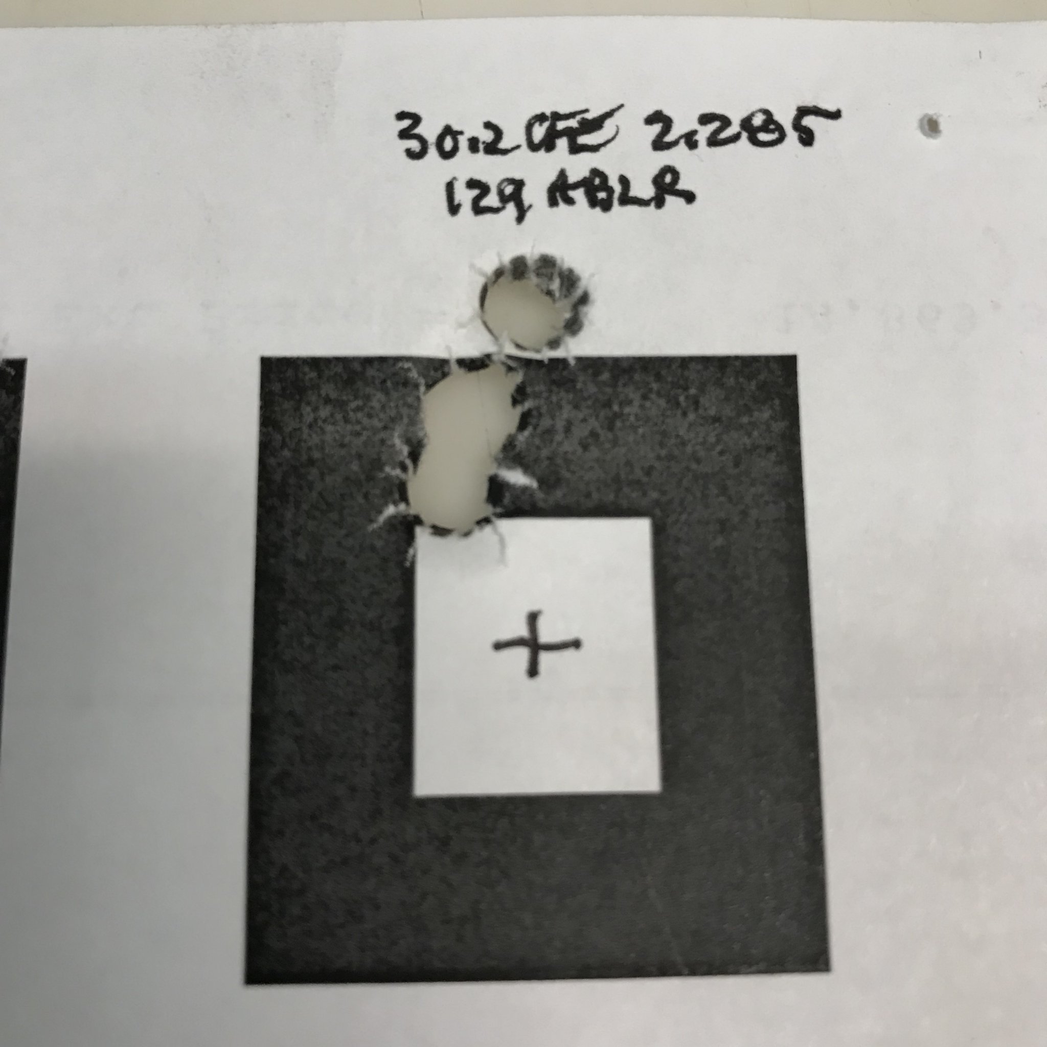

129 Nosler ABLR 30.2 CFE 223 CCI41 2.285 OAL
2500/17ES/9.8SD. Only had three rounds to test.
