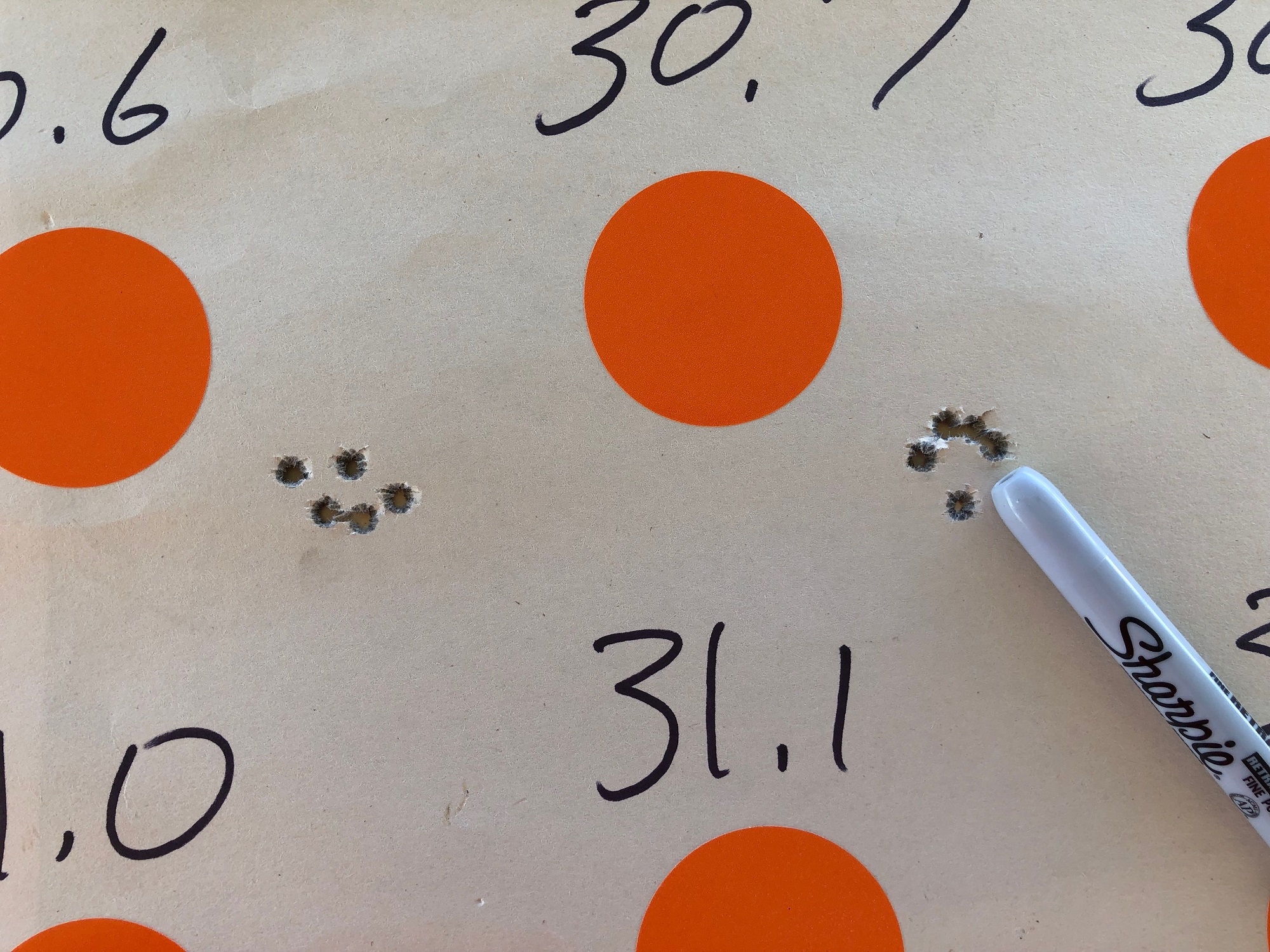

This was my load development at 300 yards:
EDIT: I think you'll find that the 6 BR will beat the 6.5 well past 300. How far is dependent on conditions.
EDIT #2: This was before tuning for seating depth.

Here is my 6 BRA testing out my 2x4-topped popper at 500 yards. First shot is a little high, so I adjust. 8 out of the remaining 9 are within about 1.7", with the one that's out being because I reset.
The BR vs the BRA means a little less velocity, but you still get all the accuracy benefits.
