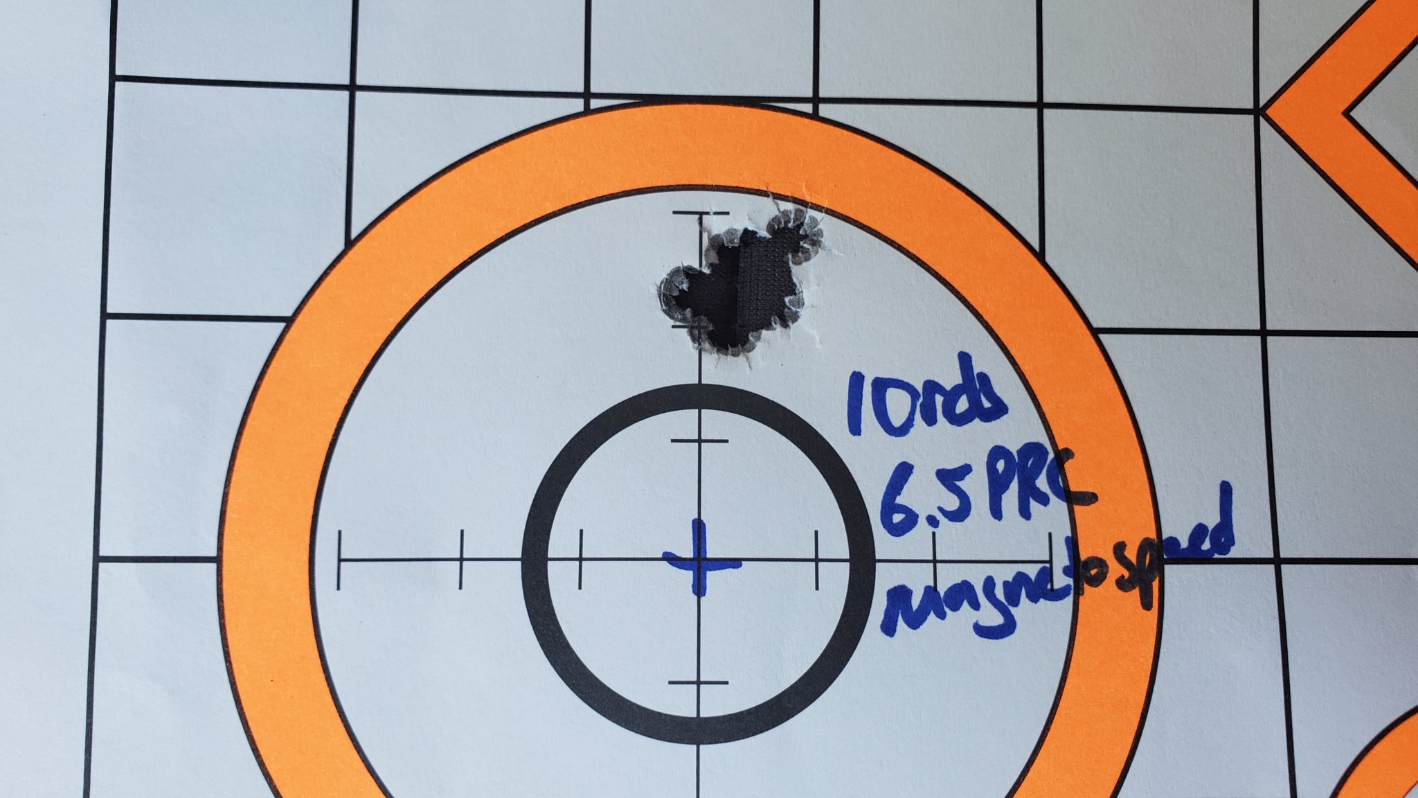

FWIW, I've got a short action deadline, 300wsm accurate mags, and a shilen with a .188 freebore. With 140 eldm or 142smk, I could jam them .010 into rifling on a fresh barrel and still fit in mag easily. My load is with 140eldm at 2.310 ogive length or 2.940 to tip, this is a .020 jump in a .188 freebore. It feeds great and ejects loaded rds through the tight ejection port. Original plan was 147eldm, to fit and feed from mag, I was going to be jumping .050 or .055 on a fresh chamber. As throat moved, my jump was only going to be bigger. These mag fed rds were a little too long to clear ejection port, I'd have to hit bolt release to kick out a loaded rd.
In my opinion, if you want to shoot 147,150smk,156 elite... I'd go either long action with .188 or .130 freebore. I bought the action here, with 308 and prc bolthead. I didnt know the shilen had a .188 freebore until it got here, just something I didn't think about until after the fact. It shoots pretty good with 58.7gr h1000, horn brass, cci200, and 140eldm, so I'm keeping it.
9 rds measured .320 and 10rds is right at .5", this is the 140eldm at 3090fps.
