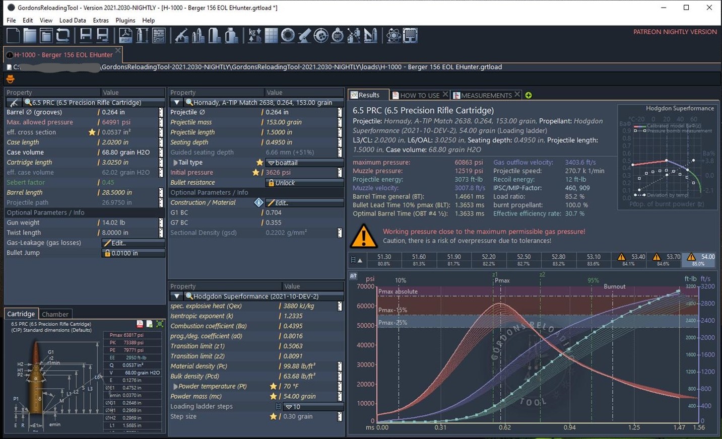

Not sure if you are familiar with Internal Ballistics models like Gordon's Reloading Tool (GRT) or QuickLoad (QL) but if you spend much time "going off the map" so to speak, you are the perfect candidate to benefit from those tools.
GRT is free and QL isn't, but QL isn't very expensive either. I would say if someone is comfortable with average speadsheet level software, it will only take a little while to get going with GRT or QL. With the time invested, you would have a decent preview of the potential of a given powder in your recipe. That doesn't guarantee it will be a great performer, but the concept is that these programs can certainly eliminate hopeless combinations.

To give you some idea for the free GRT app (Gordon's Reloading Tool) that RegionRat is referring to, here's a sample:

Thank you very much sir!!
