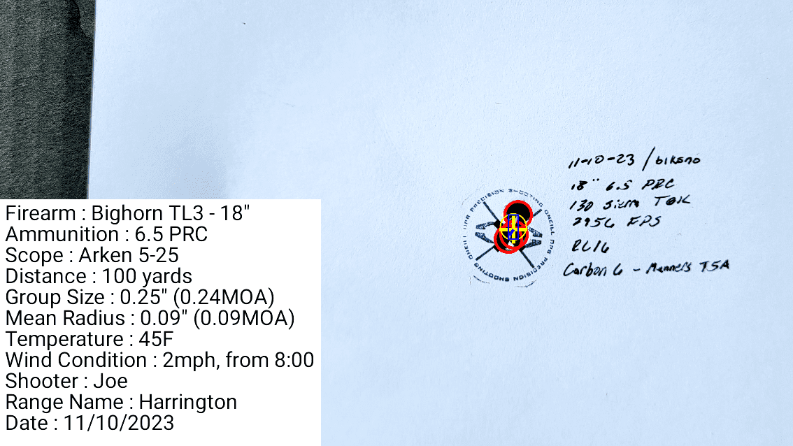

I have an 18” 6.5 PRC with a CarbonSix barrel, it gets around 2800 fps with the 143gr ELD-X and some of my handloads. I’m sure a better barrel would be faster. With a 125gr Hammer Hunter Tipped I’m getting 3040 fps and with the 109gr Absolute Hammer I was getting around 3200 or 3300 if I remember correctly. It’s been a couple years since I shot the AH.
