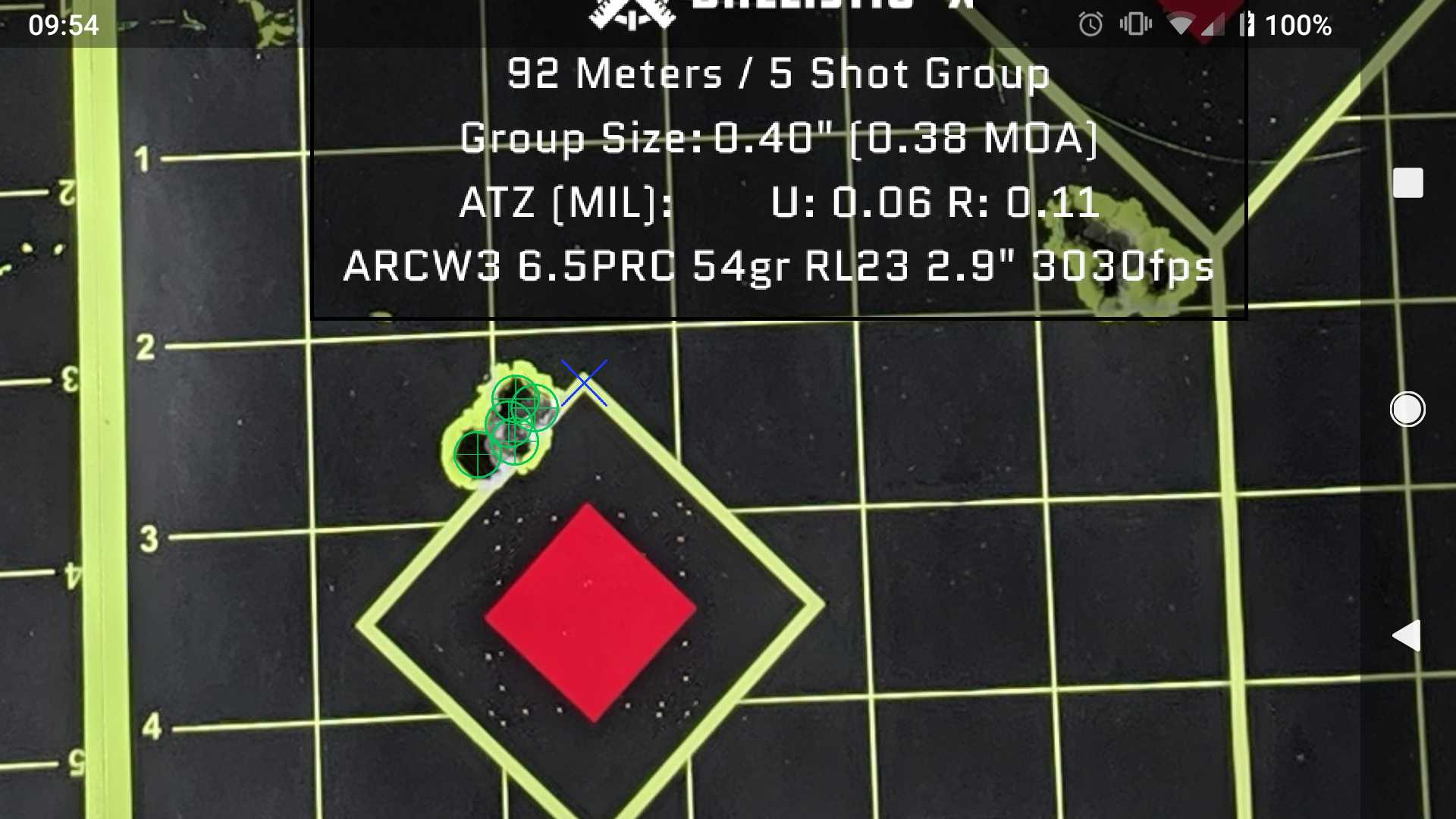

For hunting, i recommend 127 LRX and Reloder 23 (for temperature stability). Seems to get really good ES/SD too. My 22" bbl setup will get ~3100fps (bbl sped up) with 53.5gr RL23. Pls start low and work your way up. BTW i'm stuck in CA so we have to use copper bullets.
5-shot groups
