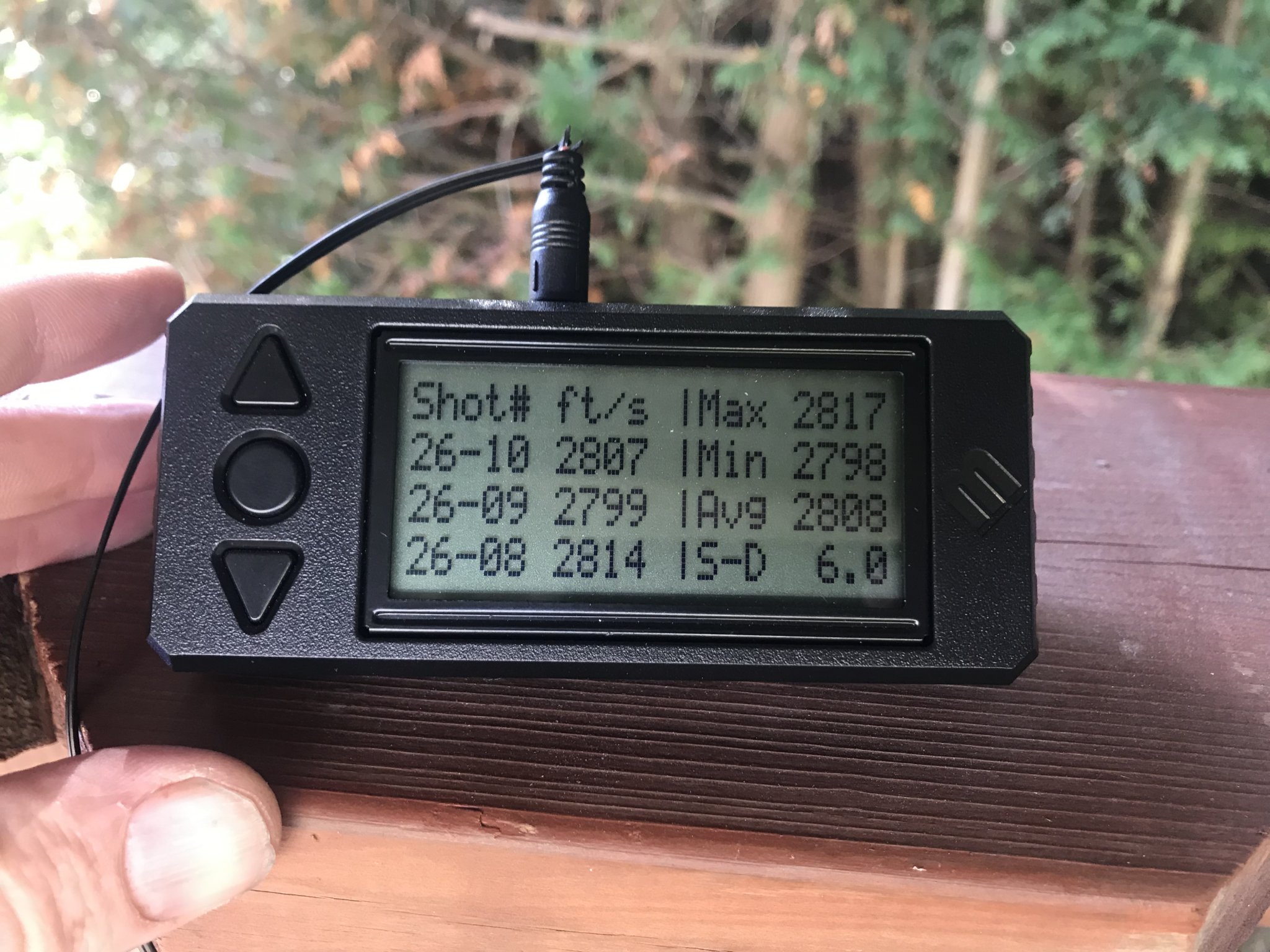

My average velocity is 2942fps, SD 14.45. This is a 26" barrel. Ammo Lot# 3173604.

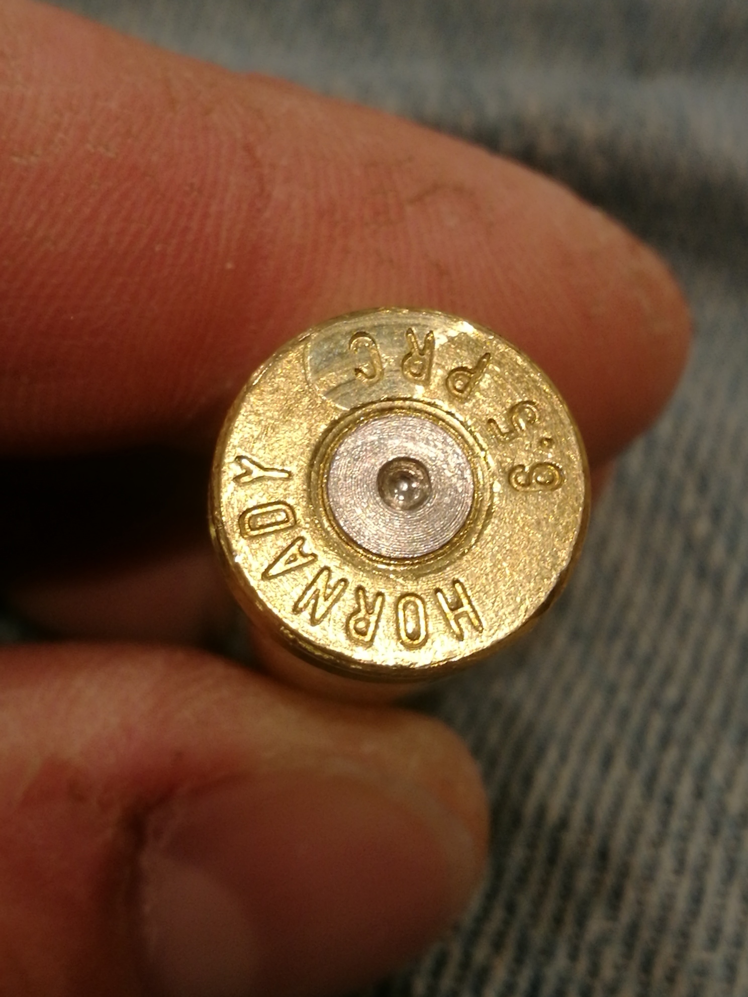

The ejector marks on the brass was only on a select portion of my reloads. I bought 200 cases and all used the same Federal Primers, and same lot of RL26 (multiple 1# bottles is all I could find locally) All others (factory, reloaded factory, and the rest of my virgin brass) are fine, primers still round, no ejector marks, no primer cratering. I was done with my LabRadar, so I don't know if my velocities reflected the pressure signs.
I did not check the lot numbers on my brass, nor any other pre inspection. I foolishly assumed that as they were all bought from the same place at the same time that they would be the same lot, and they may be.

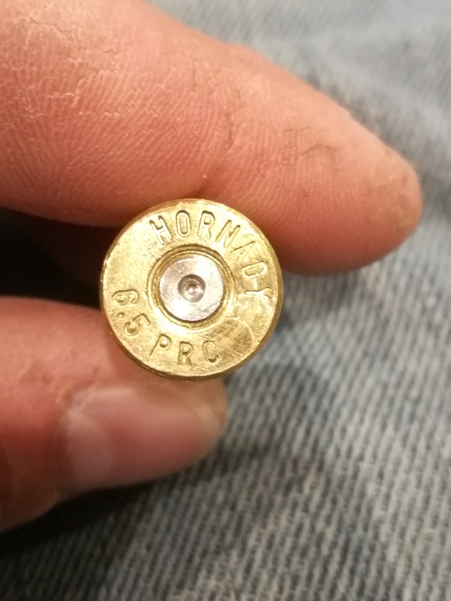

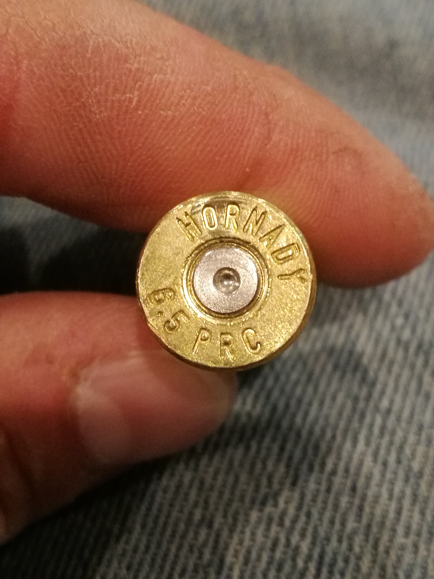

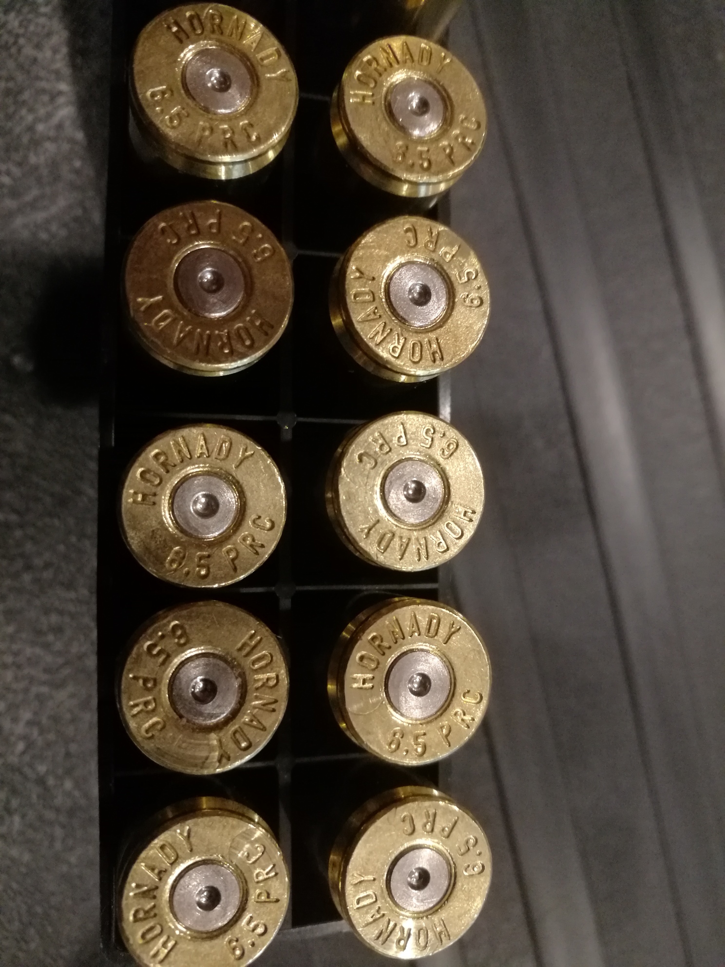

Here are a few pictures of the brass I shot. This is 10 rounds fired and 3 close ups of the worse cases. It is still leaving small shavings on the bolt face. Is this something I should be worried about?
I'm wondering if I got a bad lot # of ammo? As everything on the action/barrel has checked out multiple times. Its frustrating when shooting and the ejector gets stuck.

But then the FPS fell thru the floor on the last batches of factory ammo. 2744 ave on the 147g and 2815 on the 143.
I'm wondering if Hornady dropped their load.
I did have several hard bolt and stuck bolt issues when the FPS was closer to book. I don't now. So...???
Using the new slow FPS for ballistics I am still hitting targets at 1100 yards.

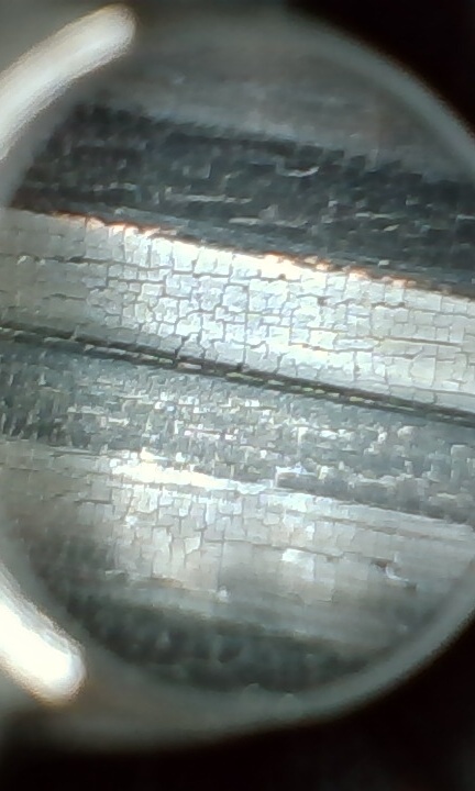

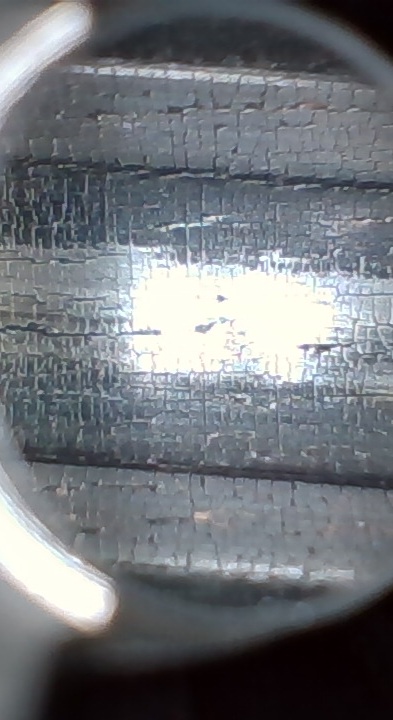

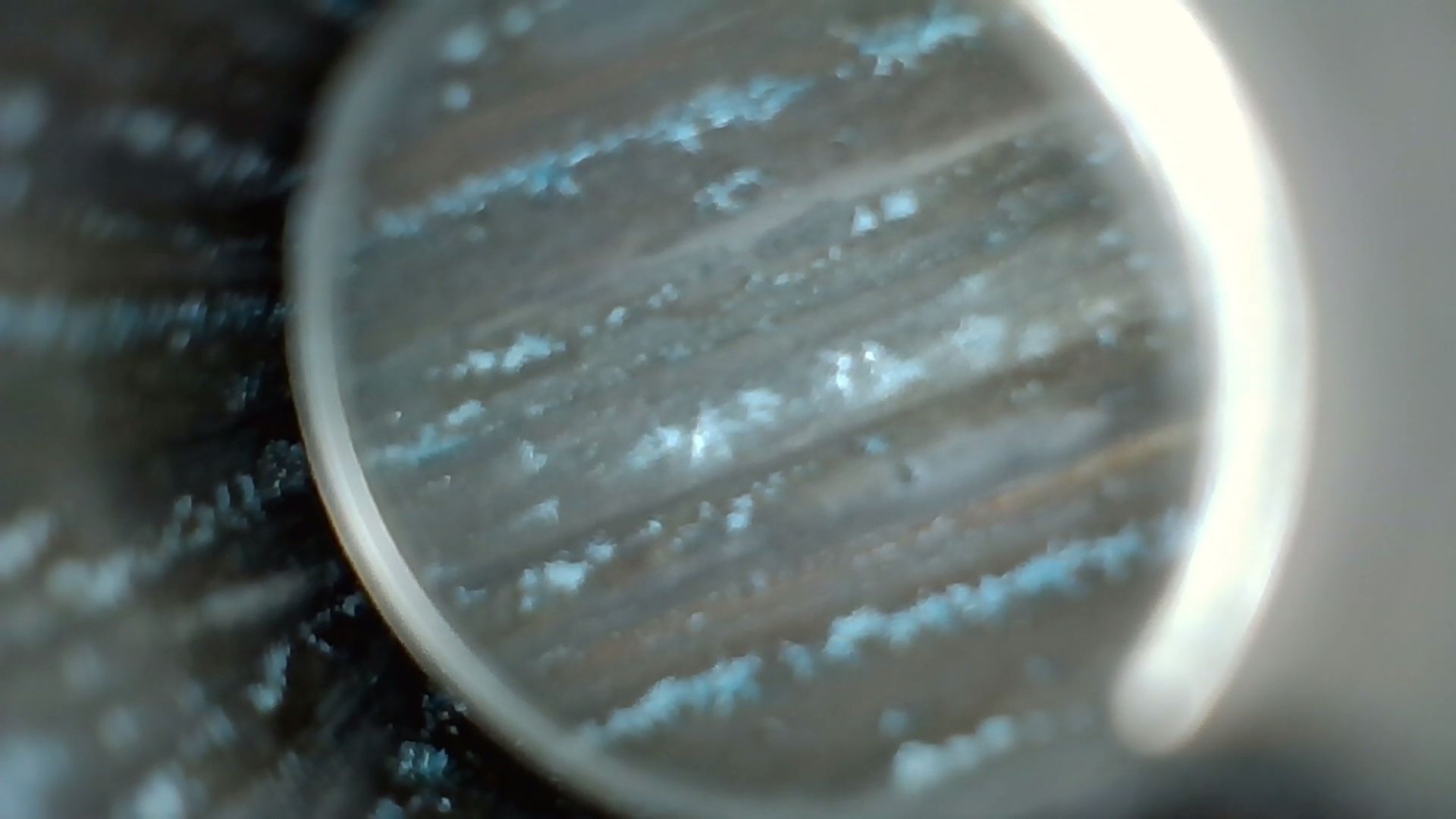

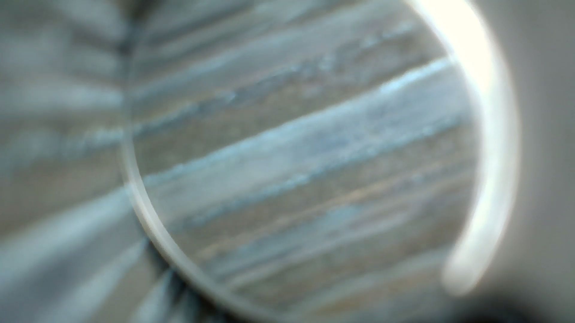

However, I decided to buy a barrel scope and look inside! I clean the gun plenty often and to the naked eye looked clean....BUT this looks scary after 65 rounds fired recently.
What am I looking at here??
Can I get some help from a trained eyes please. I have some special barrel cleaning paste coming in today that I'll try and see the difference.
Is this a bad barrel?
Accuracy is good.
FPS is slow for a while now.
The barrel has maybe had about 800 rounds thru since new about 9 months ago. I shoot PRS matches.
What do you guys think?
Thanks!!

Possible that you have some questionable ammo. Anyone else you know shoot a 6.5 PRC that either has some reloads, or older factory ammo?
It would be worth a call to Hornady. Have the lot # of the latest ammo you ran.

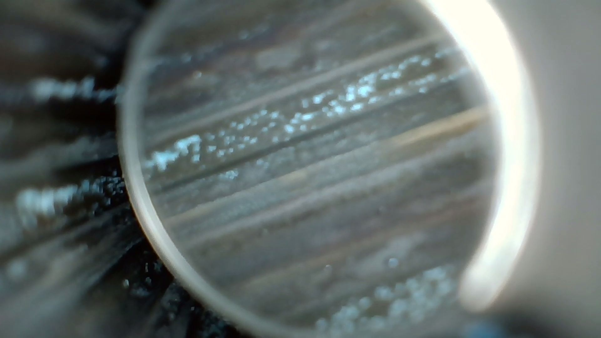

I see nothing in the bore pics that would alarm me. The blue is oxidized copper fouling.
Your sticky bolt/stuck bolt could be from a carbon ring at the throat.
Accuracy is good.
Thanks!!

Your bbl looks like copper fouling, clean it out some more and see if you get some velocity back.

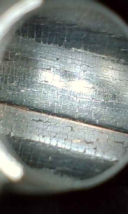

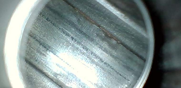

Hello,
These new attached pics are of the Jews of the barrel by the chamber....that looks like heat damage...or what?
Something is slowing the rounds down nearly 190 fps. It's still accurate when I account for the reduction.
A while back during a March I did have several hard bolt lifts and one really struck. I think Hornady had some overloaded rounds!
I haven't looked at other looking distance barrels. But my AR and 300 Blackout with many many more rounds thru don't look like this.
I did talk to Hornady. And emailed then the EXCEL form from the Magneto Speed files. They know the batches that I have had this issue with. They'd like me to send them back a partial box. I may do that.
Tell me what you think about the pics please. Maybe that is normal for a high powered Rifle...with 600+ shots
I do intend to see if I can get a hold of some 6.5 PRC reloads from a fellow I know that does that for guns that they manufacture and sell in College Station Texas.
Thanks!

Pics look normal compared to any of my barrels.
Wow ! Really? So that cracked up look is normal just because it's under high magnification you see the heat wrinkles or what? I expected that to be so much smoother I guess.

That fire cracking is normal. I have had fire cracking w larger calibers w 180 rounds down the tube.

My 6.5 PRC barrel was a lot worse w 800 rounds down the tube. Extensive fire cracking and 12 plus inches of rifling gone.

Not trying to sell you anything but looking at the pic’s you posted....barrel is toast is what I’m going to say.
Also with you saying 800 or so rounds on it....and lost velocity. With a round count in that range and losing the velocity that is usually a sign the throat is gone. Shooting box ammo you cannot chase the wear of the throat and or bump the powder charge to get the velocity back.
Bore scope the throat area of the chamber right in front of the case mouth. Bet you it looks worse. Also that cracking you are seeing when you start losing chunks of metal in the throat on the edges of the lands that will be an accuracy killer.
Have you measured the throat wear at all? Kept any data from when the barrel was new and how much further the bullet is going into the throat area now?
I think I have pieces of rifling missing also down the barrel a little bit. I don't think that's a good idea…! LOL did that trash your barrel then? Or still working well ?
Barrels will wear differently from everything from how the barrel is made to the load being shot thru it as well as calibers.
I’ve seen 26 Nosler barrels with a 110 rounds on it that look like a 300wm with 800 rounds on it.
Try using JB bore compound to get some of that carbon build up and try and smooth the heavy cracking out as well.

Velocity will change lot to lot. Temps can change velocity. How much velocity have you dropped?

I have not been able to measure anything. I've only been using factory Ammo. And just got the borescope a few days ago to see what's going on inside. I don't know what a new throat should look like. But This is pretty bad!

Im my finding w the 6.5 PRC, Hornady may have gotten their barrel life numbers mixed up. Original reamer print showed 1100 than was written over w a pencil to 2100. My barrel was about shot out w 800 rounds.
Velocity drop and loss of accuracy= A SMOKED BARREL :p
Wow!
For now it's still very accurate at 1100 yards. Just slower. But with the chunks of metal I see missing with the borescope, obviously accuracy is gonna go away sooner or later
I would source a barrel (BARTLEIN or Proof) and shoot it till accuracy drops.

My 260 pushes 147’s faster than that comfortably.
I was just thinking the same thing about my 6.5CM...
With both H4350 and RL16. 24” barrel.
