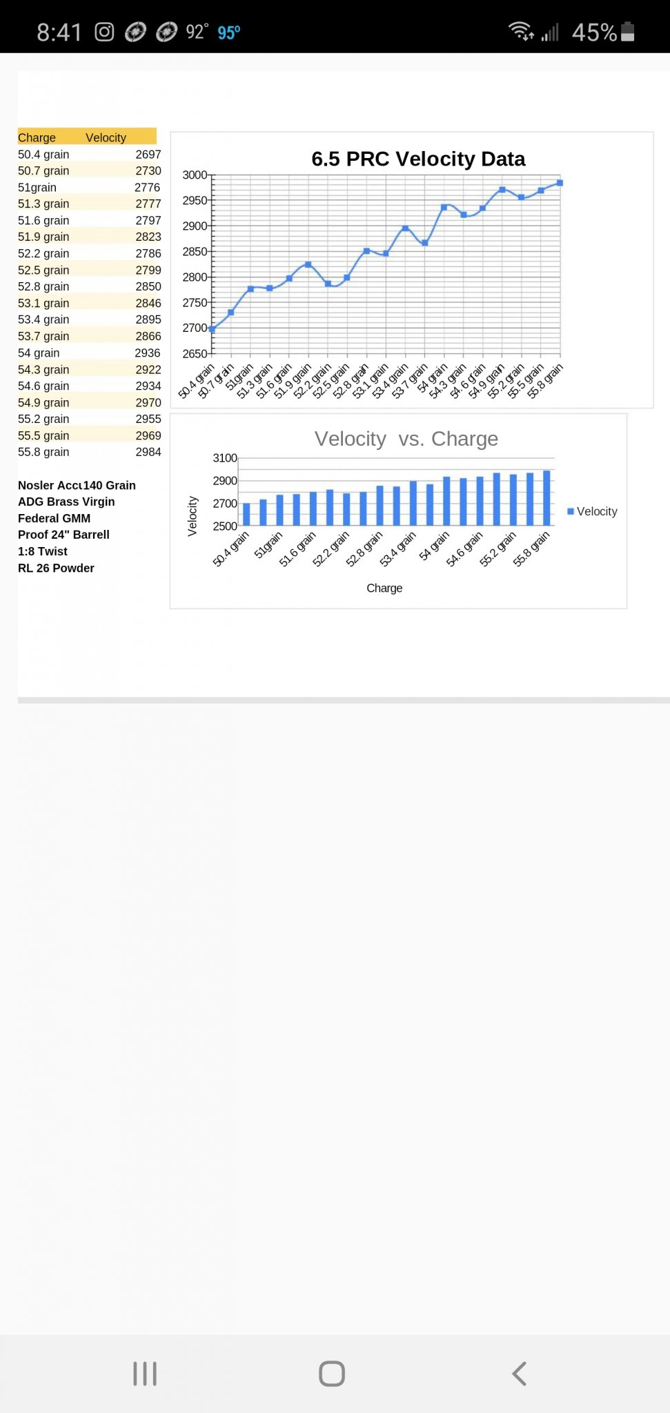

Here is some data I gathered on trying to find the right charge weight for my rifle. I used RL 26 for powder and federal gold match large primers. The attachment has the rest of the info. Let me know what you guys think, all the insight I can get would be much appreciated. Thanks

Going to try out 54.3 grain loading, looks to be a good velocity node. I also am going to try to go higher on my charge weights till I reach max. Should find one more higher velocity node.
Here is a better graph, I cleaned it up and looks better. Let me know what you guys think on the data. Need some input from you guys. Thanks
