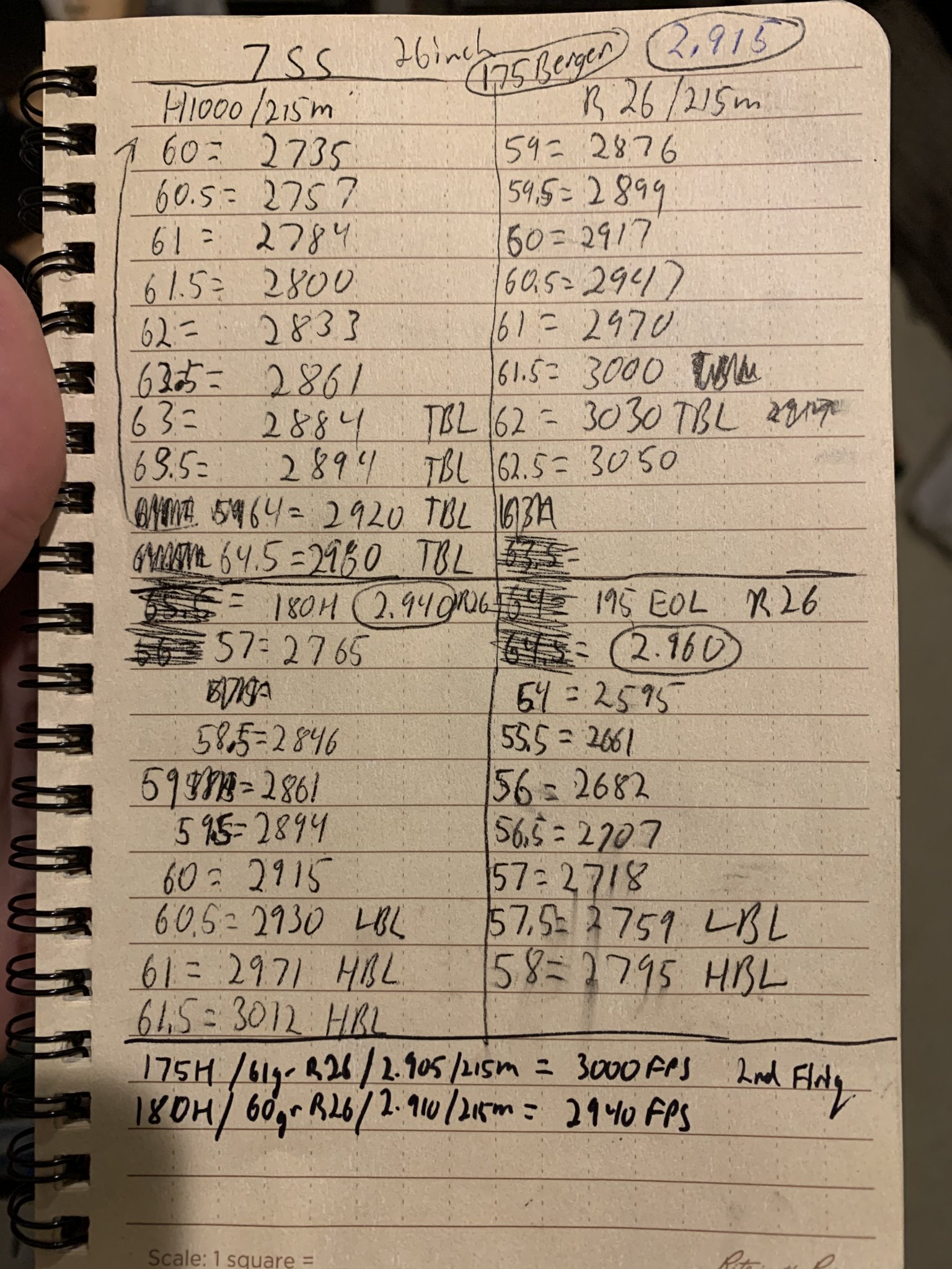

I use a 8 twist for my 7ss. It shoots the 175,180 and 195 eol just fine. Never got much past testing with the 195 since they maxed out on pressure at 2740ish with R26.
