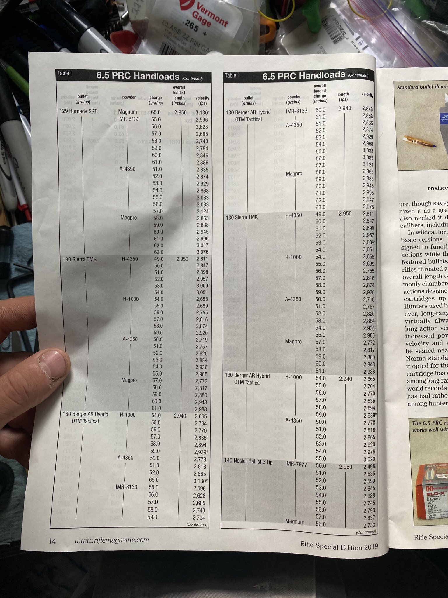

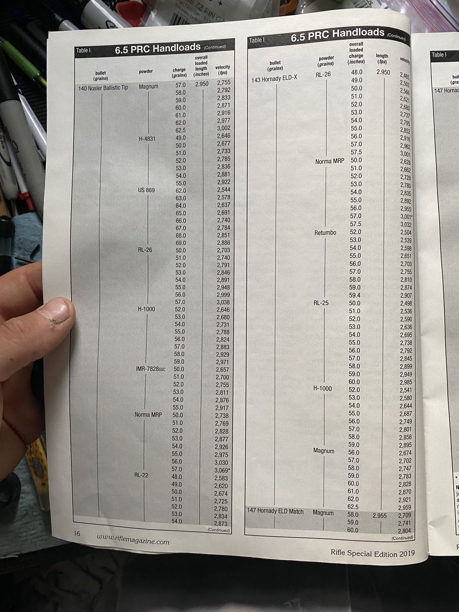

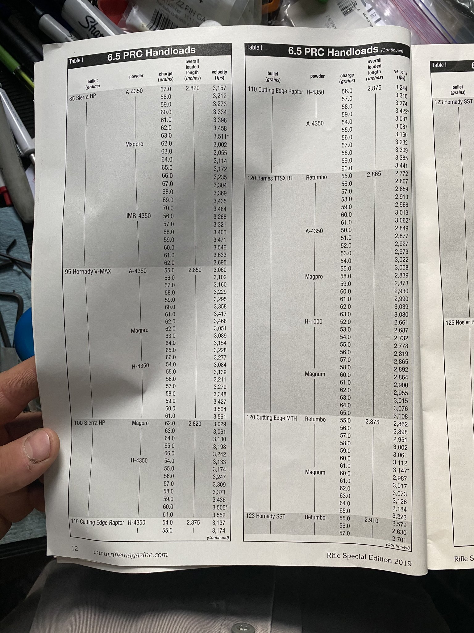

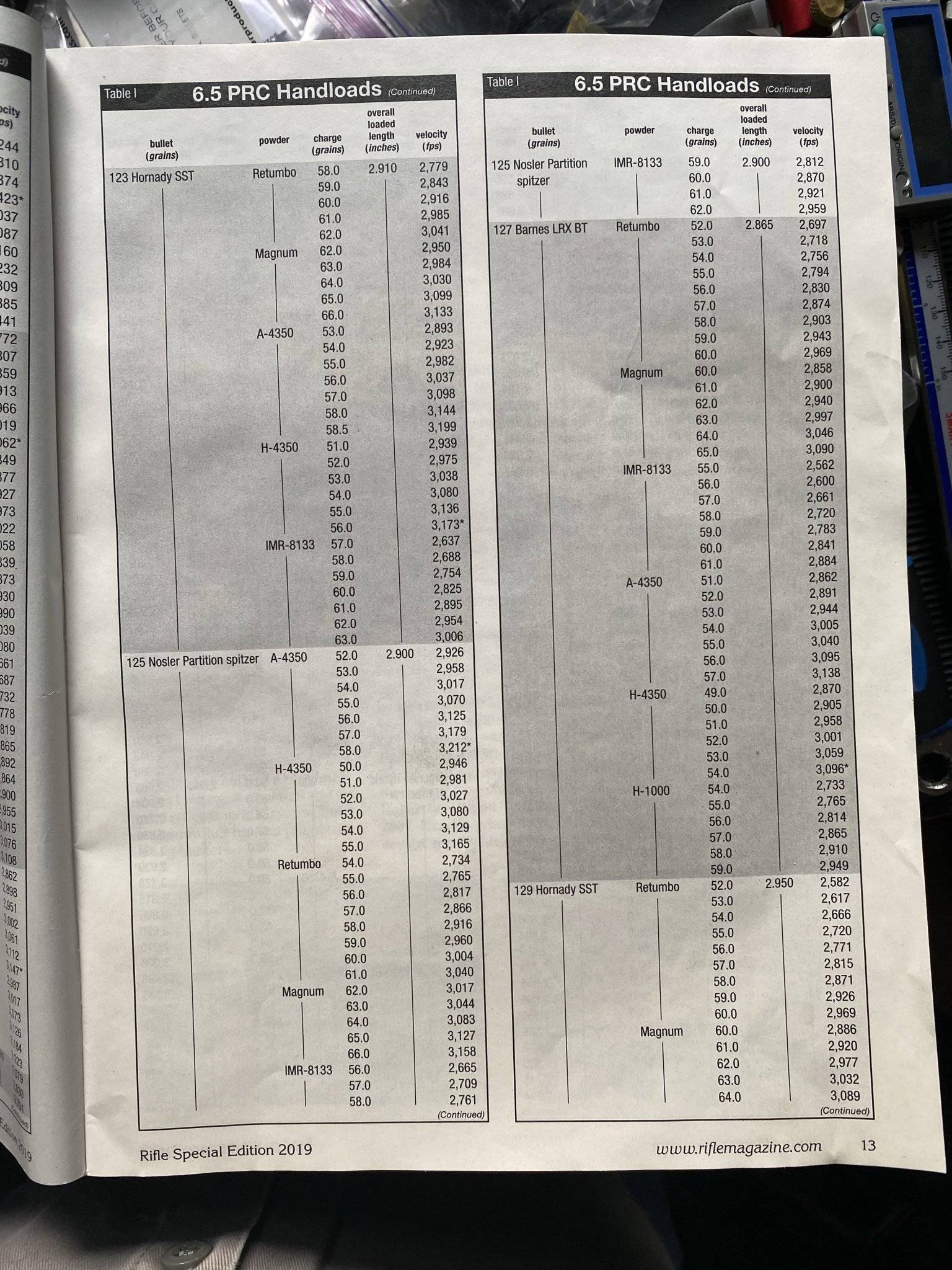

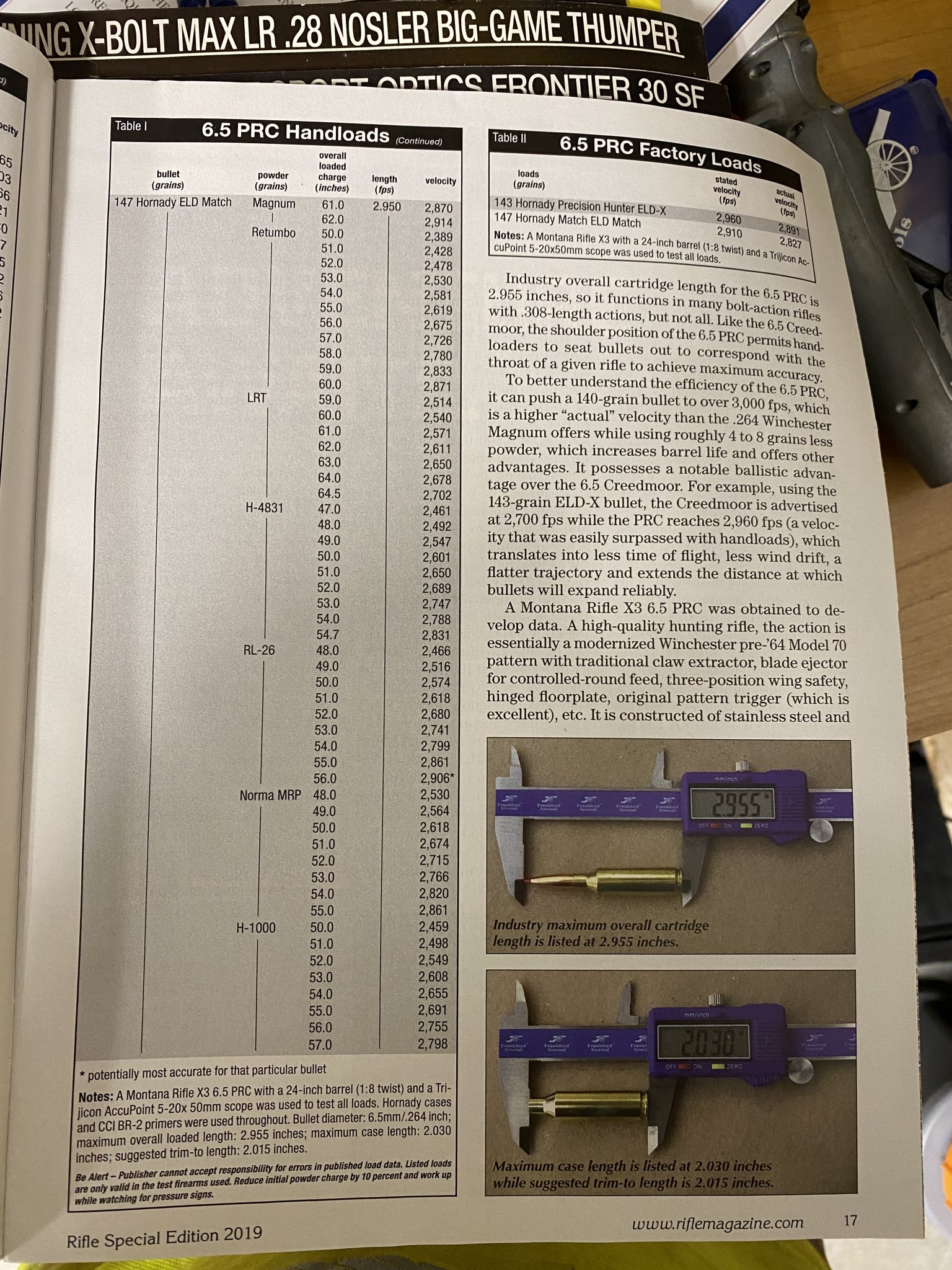

I bought a hand loaded magazine that had loads for all 6.5’s and the 6.5prc was in there. I’ll take some pictures of their loads and post here, there were a lot of powders for 130g bullets and down that surprised me.
I just realized there are a several typos and messed up loads in the 130gr Berger OTM section.
Idk man, what don’t make sense to me is the double load data for the same bullet a couple times. Trying to fill the page out maybe. Then the big jump in powder charge also.
Ha, the missing page. Now I don't have to buy the old issue.
Lol it wasn’t missing, the page was intended to be posted in the first post with the data.
Your welcome 😉
For that one it looks like they forgot to differentiate between A-4350 and H-4350 then relisted it again on the next column with only half the powders.
