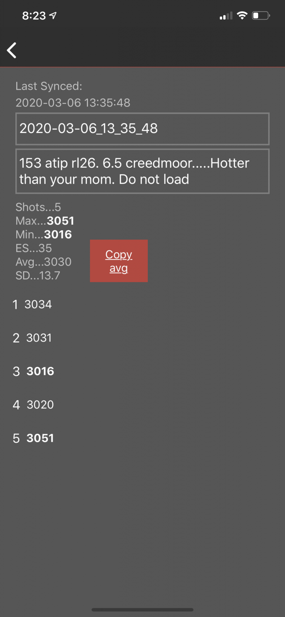

Yeah so I wanted to see how fast I could push the 153 atips in my creedmoor. Using a 26 inch barrel I got them up to 3050 FPS with RL26.... WITH MASSIVE PRESSURE LOL. Super heavy bolt lift, ejector marks etc.
3000fps was pretty mild bolt lift, but to close for comfort. 2930-2950 I didn’t show any pressure signs at all, and is a load I will continue to run when I’m trying to touch something past 2000 yards.

Pressure signs as most people read them start showing up around 70-78ksi. Wish I had a personal pressure test barrel to run "the internet's" loads through and see what people are actually subjecting their stuff to. :D

1.5”
Berger 156 gr Elite Hunter HPBT
Rx 26 55.3
Hornady brass x 1
Fed 210M
COL 2.030
COAL 2.940
2914, 2894 SD 14.1
1”
48F 86% 30.08mmHg
Rx 23 52.0
Hornady brass x 1
Fed 210M
COL 2.030
COAL 2.940
2805, 2823, 2839, 2827, 2842 SD 14.7
2” cold clean barrel
Rx 23 52.5
Hornady brass x 1
Fed 210M
COL 2.030
COAL 2.940
2851, 2851, 2845, 2869, 2853 SD 9.0
1.25” slight pressure circle
Rx 23 52.8
Hornady brass x 1
Fed 210M
COL 2.030
COAL 2.940
2871, 2872, 2888, 2896, 2866 SD 12.7
1.25” mod pressure circle
Rx 26 55.5
Hornady brass x 1
Fed 210M
COL 2.030
COAL 2.940
2896, 2940, 2950, 2920, 2927
2907 SD 20.1
1.5” high pressure
Rx 26 56.0
Hornady brass x 1
Fed 210M
COL 2.030
COAL 2.940
2949, 2962, 2956, 2947, 2955
2951 SD 5.4
1” mod pressure on bolt on a few rds
Guys that pushing 6.5 creed at 2900+ with a 140gr class bullet are loading hot! That's the thing. I can hit 3150 in my prc with 140eldm and still get 3/4moa, but I run it at 3090 and get .25-.35moa. Hitting 2900 in a creed isn't a mild load or even warm, its hot. Sure guys get lucky and run a fast 26"+ barrel and don't care about throat life or brass life. Its pretty similar to 6 creed, and I'm guilty of this, factory saami pressure 6creed ammo runs 2975ish. For yrs it was regurgitated that it can safely and easily run as fast as 243 with better barrel life. I always thought that was tough with out having more pressure than 243. Than Hornady and berger come out with factory ammo at 2925-2975. Meanwhile guys load up to 3175 because George said so, and then wonder why horn brass sucks cause they lose primer pockets in 2 firings.
Guys that pushing 6.5 creed at 2900+ with a 140gr class bullet are loading hot! That's the thing. I can hit 3150 in my prc with 140eldm and still get 3/4moa, but I run it at 3090 and get .25-.35moa. Hitting 2900 in a creed isn't a mild load or even warm, its hot. Sure guys get lucky and run a fast 26"+ barrel and don't care about throat life or brass life. Its pretty similar to 6 creed, and I'm guilty of this, factory saami pressure 6creed ammo runs 2975ish. For yrs it was regurgitated that it can safely and easily run as fast as 243 with better barrel life. I always thought that was tough with out having more pressure than 243. Than Hornady and berger come out with factory ammo at 2925-2975. Meanwhile guys load up to 3175 because George said so, and then wonder why horn brass socks cause they lose primer pockets in 2 firings.
I agree with you... except if it’s RL26, 2900 with a 140 gr. has never given me any pressure signs at all. Now if I did that with any other powder yes, that is a hot load. Rl26 does something magical with the creedmoor (or so it seems)
My last 6.5 barrel I put 4000 rounds through it and it still shot .4 moa 5 shot groups.
Maybe the slow burn rate of rl26 just doesn’t show pressure signs as well. But quickload told me I was under pressure as well, but you can’t always trust quick load.
Reactions: 6brshooter
Hey man, I can't argue with your results. That sounds like a unicorn barrel to get that speed, life, and show no pressure. It happens, but its more the exception than rule. You can't discount other guys that aren't as savvy reloaders, read that and say 2900+ or bust and don't know what to look for in high pressure before they get in trouble.
I've had some stupid fast loads that were "safe" in my barrels and components. How about a 26" 6br that ran 2945 with 105hybrids and a 25" 243ai that ran 3340 with 105s.
I Got these speeds in both my barrels, but yeah. I am defiantly not running sammi case length, Sammi coal, and low neck tension etc, all these things defiantly attribute to the results.
and I am sure 2900 would be the peak I could run without running into Preasure signs, anything more than that I’m sure I would run into something!
I you are right, I probably should even post these results for the newer Reloaders that don’t know what to look for, and thinking it’s easily obtainable.
