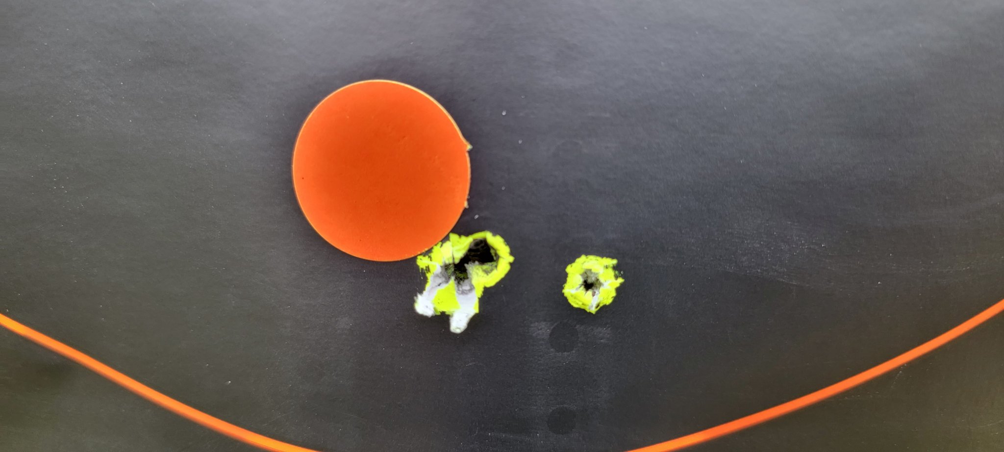

Here's 4 at 300 yards with 147 eld.
Bartlien 26" , 1in 7 , H 1000 , 2960 fps.
I picked it up from Someone who was blowing up the atips. So far so good,ill see how she holds up
