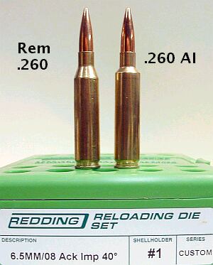

I believe it's the reverse (i.e. 260 has a couple grain more water capacity over the 6.5 Creedmoor, at least based on my measurement of the water capacity of both those cartridges) not that it's a big deal one way or the other.
These days I am liking the 260 Rem Imp 30 cartridge a lot. You can shoot factory 260 Rem ammo in it and if you reload it afterwards you get even more out of it as it has a couple grains more yet over a .260 Rem. Dies are available for it.
Above 260 Rem (left) vs 260 Imp 30 (right)

I've found that after sizing, the 6.5 Creedmoor had the largest capacity. But, not by any significant amount. Personally I like the 6.5 Creedmoor. As you noted though, if it's a smidge this way or that, IMO it's about the best capacity/usefulness to that caliber.
However, as you posted the .260 AI, I think that is a good option as well. You can still seat the longest best bullets for caliber to short action magazine length. The caveat to that is no doubt people are going to hot rod it and not get the case or barrel life they expect. Keep the pressures moderate on an Ackley case and you will be amazed at how long they last. I know of a set of Ackley cases that were loaded 29 times. That comes from the exact same headspace time after time and no case stretch due to heat. Keep that Ackley at moderate pressures and you will see long term perfomance that is astounding.
Too many people, myself included, have gotten all wrapped up about that last 50-100 fps. It burns barrels. Once that changes you have to get the harmonics right again. It sometimes takes as many as 200 rounds to figure out the difference. Find the <span style="text-decoration: underline">lower</span> accuracy node and shoot in the wind as much as you can.</div></div>
I was under the impression the .260 AI had a 40 degree shoulder? Is there a 30 degree variant?
http://www.6mmbr.com/gunweek046.html
</div></div>
Yes, the Ackley is a 40 degree shoulder. And yes, there are 30 degree versions as well as 28, 32 and 35 degree versions. Different ideas on pressure vs. flow and feeding issues.
