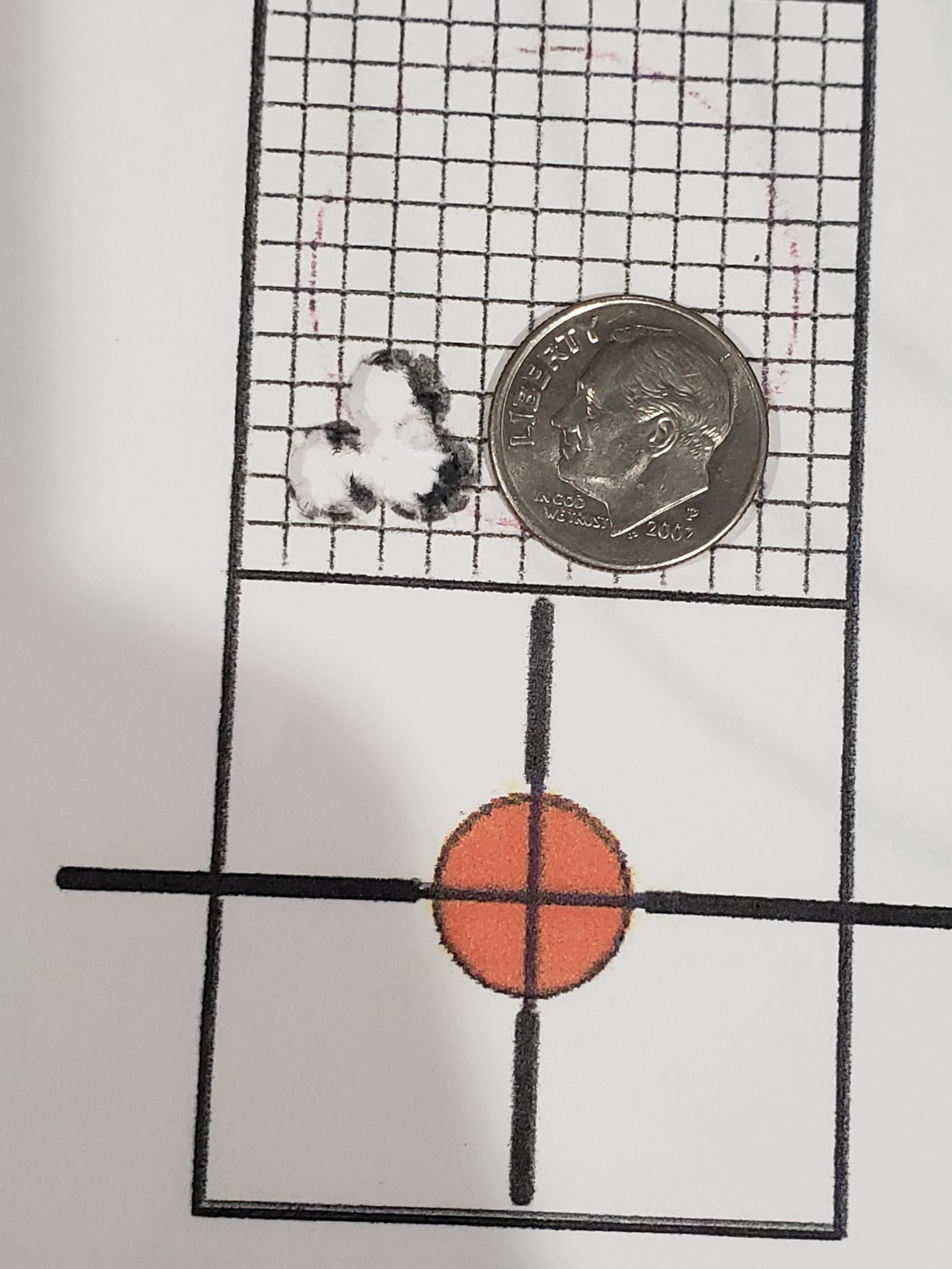

Cracked open a new bottle of retumbo from a different lot number to load some hunting ammo for this year, loaded some up at 60.2gr, and it ended up going 2970fps with some pretty bad ejector marks. This lot number seems to be significantly hotter than the last I was using, but accuracy is still there. I pulled the rest of them, and will be doing another ladder test. Here's the three rounds I shot with this new bottle of powder. Not real excited that I have to reduce the powder charge. Hopefully it shoots similar groups afterwards.
