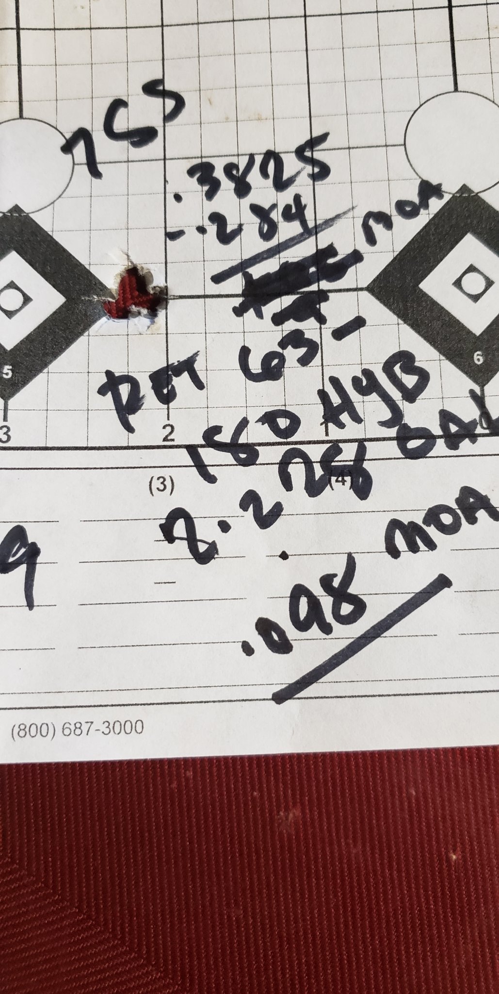

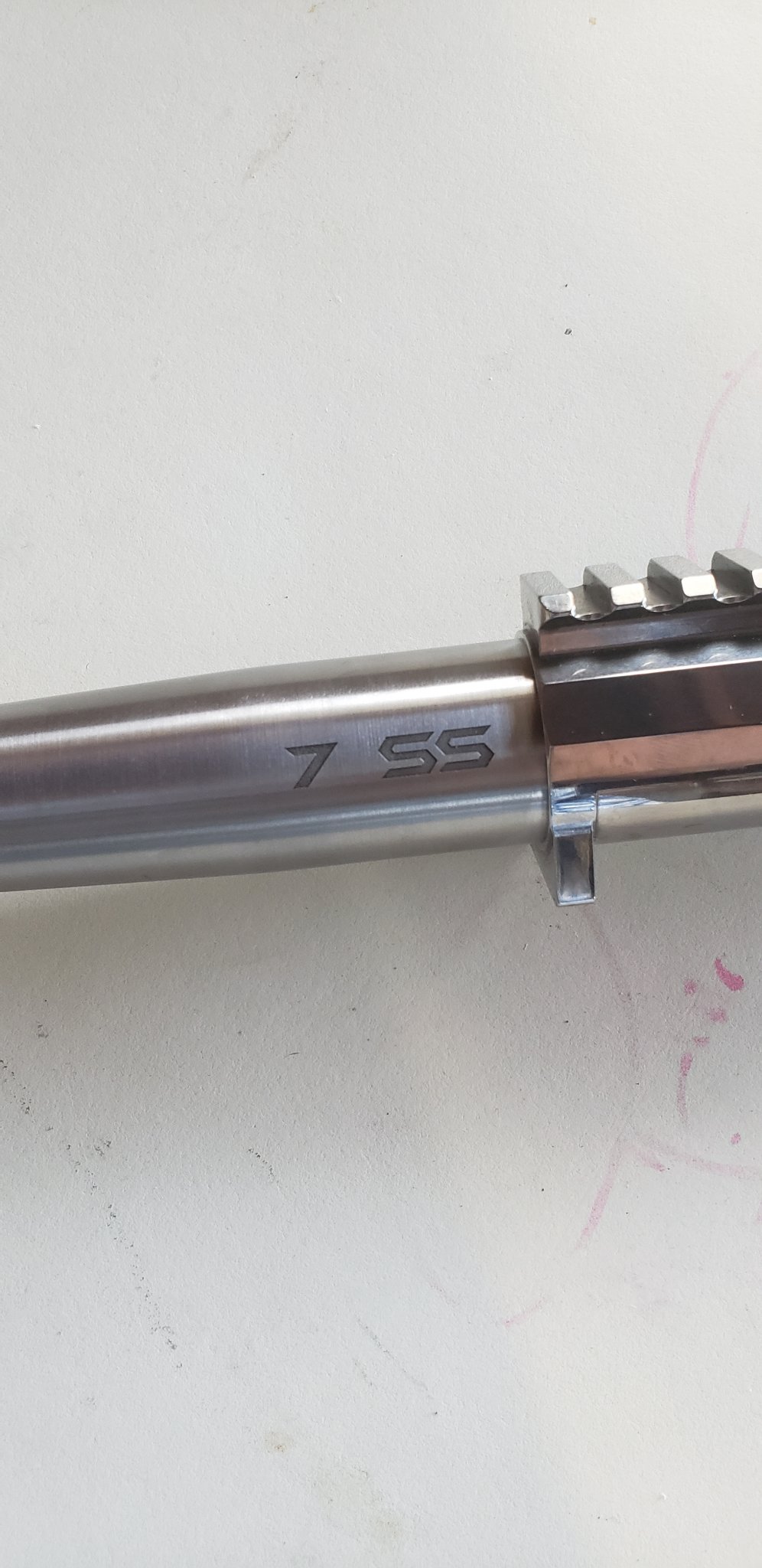

Been shooting my 7ss for a while now.i actually just received new batch of brass from rich today..6.5 and 7ss brass comes in 30° shoulder and need to be formed.
H1000 rl26 retumbo and n570 are popular powder SS cartridge.and yes its very accurate

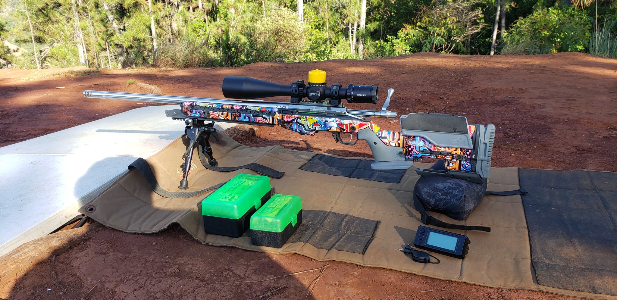

Tried some mild loads of RL23 today, because I had some already in my charge master and trickle charger.
Loaded up some 150 SMKs to fill time between strings with another rifle.
A lighter charge of 55.0 RL23 netted my 3091fps. Shooting at 200. Shot one for a sighter, adjusted .2MIL left, and let 3 more fly, then another 2 after 15 minutes.
The next two went into the same hole.
5 shot group at 200 yards measured .435", meaning .208 MOA. Not bad for some thrown together loads.

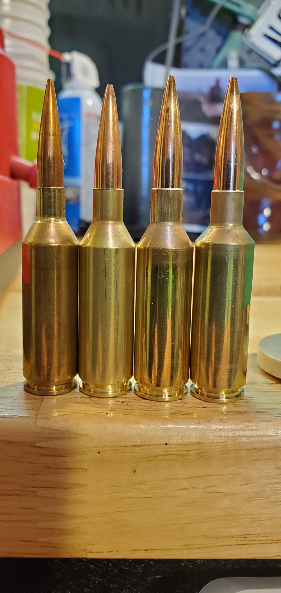

The 150 SMK is LOOOONG.
This is a 6.5 SAUM w. 140 HVLD w. .020" jump (at .120" FB) vs 6.5SS w. 150 SMK at the lands.
This is 6.5SS w. 140 Hybrid @ .020" jump in Accurate Mag.

I’ve got a 28 inch Bartlein 8 twist 5R
