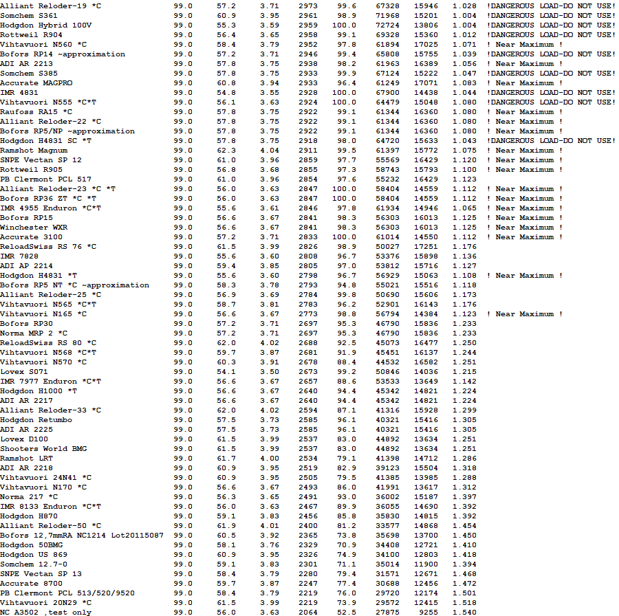

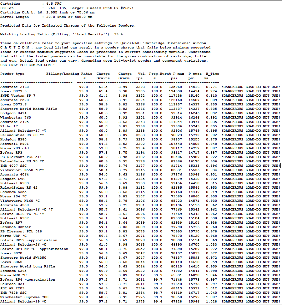

If you're looking for a powder optimized for a short barrel, then the variable you want to consider is % Powder Burn. The closer you can get to 100%, the closer you are to an optimized powder. Here are the numbers from QL with a Berger 135 out of a 20" barrel.
Yup, there's a whole lot of DON'T USE in there, but lower down the list you start seeing safe pressures with nearly 100% powder burn.
It looks like good candidates are RL23, Accurate 3100, and N555 (if you dialed it back slightly). Use this info as a guide and not as load data.

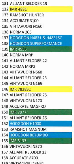

I wound up with a 8 pound retumbo so I have a known safey safey, but I also found a 8 pound Superformance.
I bought it after looking at burn rates and it being pretty close to 4831
I don't see alot of data on it and what I read is 50/50.... any thoughts?

I worked up a load with Superformance and 140 grain Nosler open tip match for my 6.5 Remington Magnum. I started with data from the 6.5x284 and moved up until I got <1 inch groups (the barrel was high mileage at that point). You should have no problem with this powder in your 6.5 PRC.
Good luck
