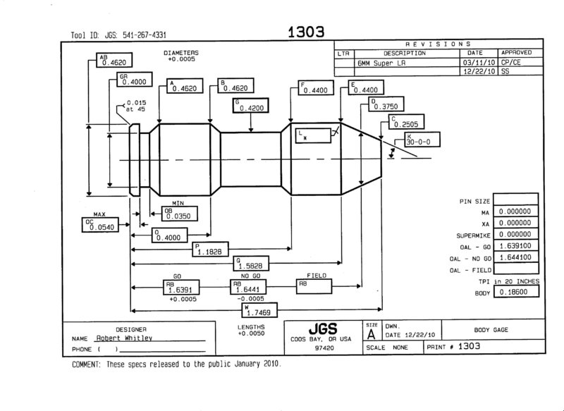

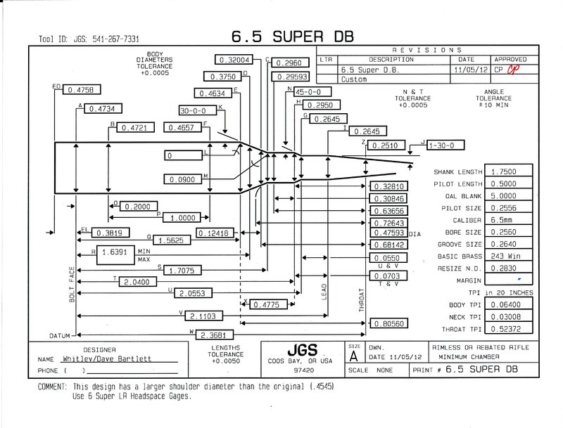

Attached is:
6.5 SLR/S Improved reamer print
6.5 SLR/S (standard short action magazine fed) reamer print
6.5 SLR go-gauge
Both of the results below are from 26" 1-8 twist barrels.

Forming:
I used an expanding mandrel to increase neck diameter
I used the standard full length die to bump back shoulder to 30 degrees (i was crushing cases with the improved die)
Hydroforming die for blowing out case (not neccessary but gives me the low ES on first firing, otherwise there will be more variance)
Improved full length die for previously fired rounds
Winchester brass just requires running through the dies. Lapua brass requires neck turning. My results are from annealed 243 Win Winchester brass.
Whidden gun works is my preffered supplier for dies.

I wish someone would come up with a reamer for Lapua brass without having to neck turn it, my SLR is getting 2865 out of a 22" Broughton with 38.7 gr. of H4350 with a harvester on the end.
Call JGS and tell them to use that print but change the neck diameter to whatever your loaded neck diameter is +.003"-.004". That should give you enough clearance.
