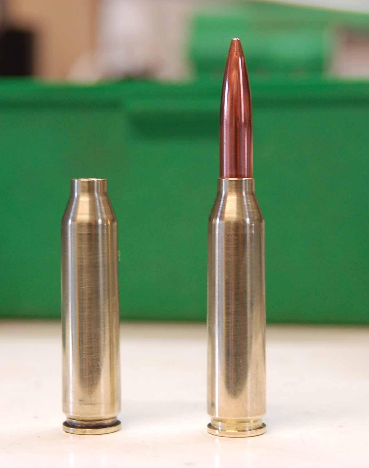

Not sure what the 6.5 Comp Match from LRI is like, but I do know the 6.5 SLR.

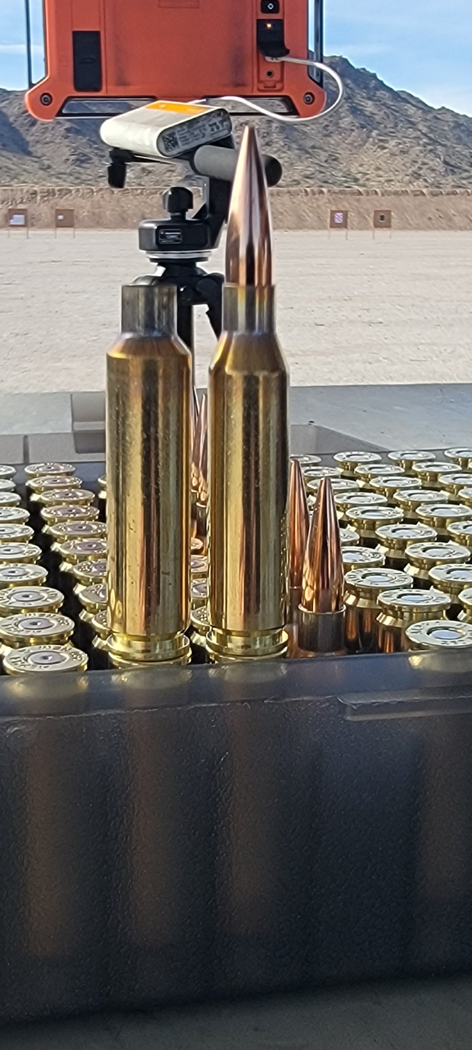

6.5 SLR uses the .308 parent case (.243 Win or .260 Rem work the easiest in a single step).
Body length remains the same as the .260 Rem. for the most part.
One throw of the press sets the neck to shoulder junction back, and sharpens the shoulder to 30°. Resulting in the same shoulder/neck design as the 6.5x47 Lapua, a cartridge known for it's accuracy potential.
Final fire forming completes the new case design.
I don't think you will see any velocity gains over a .260 Rem like a .260 AI would produce, as you actually lose just touch of case volume with the SLR design, but gain some efficiency and inherent accuracy potential.
Plus, it looks cool.

.260 inch , with shoulders moved forward 3.5mm , neck 3,78mm ,cca 15% gain in capacity
Easily 3050fps with 140g bullets ,48 grains of AR2209
For resizing, a standard .260 die can be used, simply set 3,5mm higher in the press. If you need a body die a 30-06 can be used to form the botom of the case , Sizing dies are made custom by Redding
Plenty enough and more than you find in a tank cannon or artillery shell , which have worked well for decades ,if anything it much easyer to get consistent neck tension than on a longer neck
This is much more extreme case of short neck ,good enough for some BR records.

Anyone working with the 6.5 heavies? I’m dusting off my old 6.5 LRP barrel and a, going to play with Hornady 147s.
Reactions: JRodMT

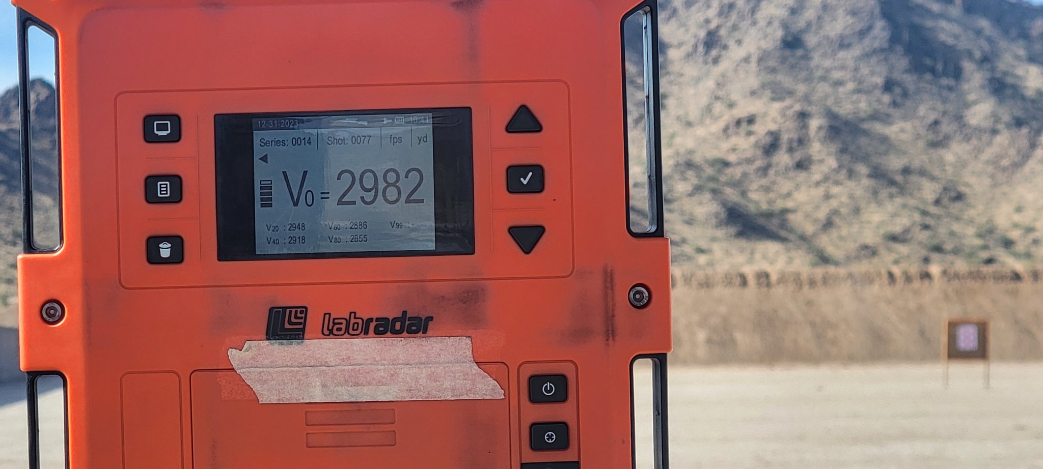

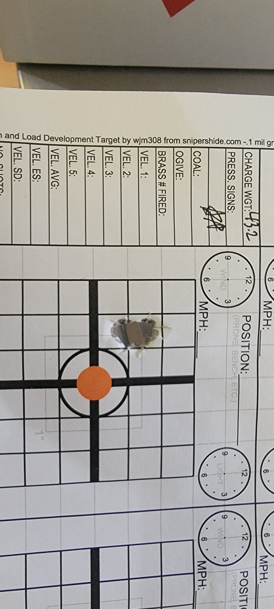

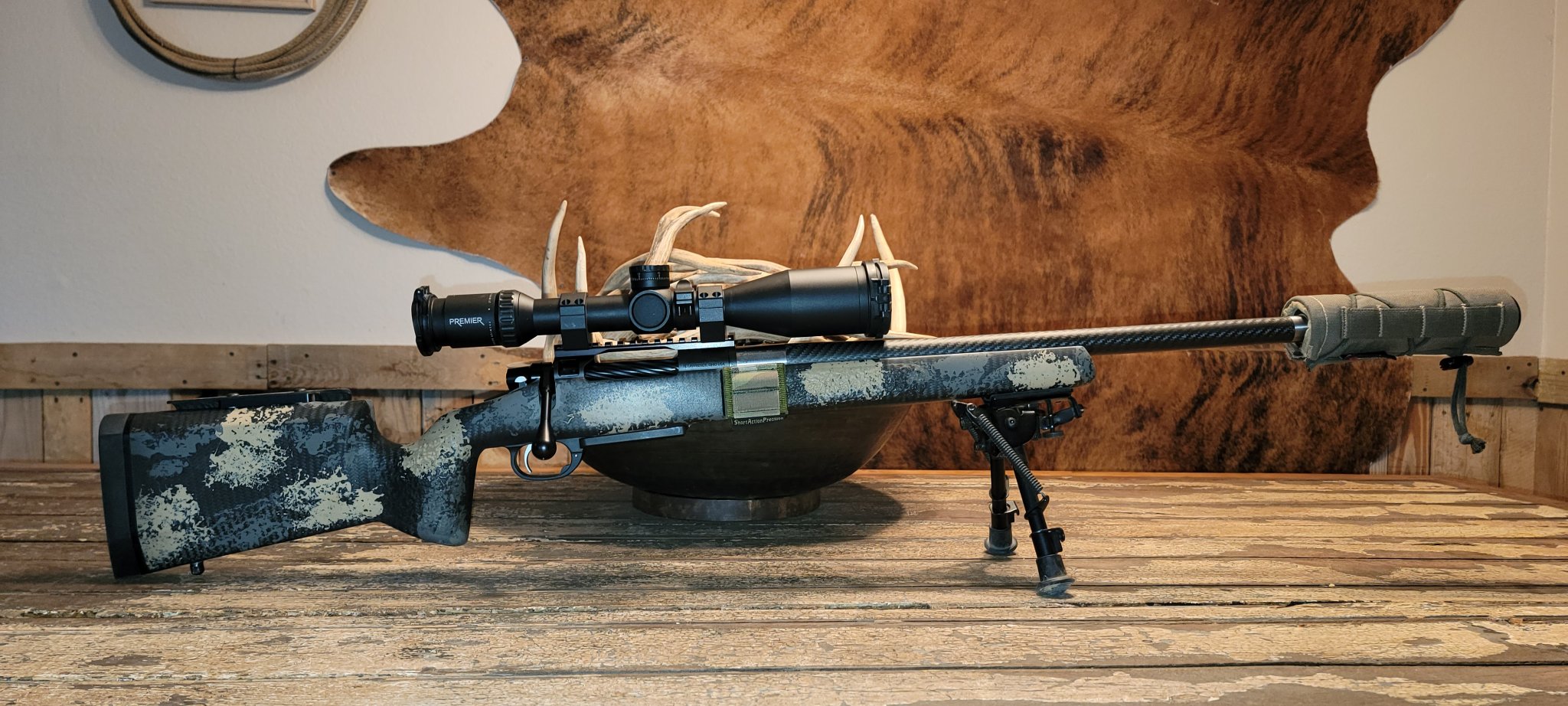

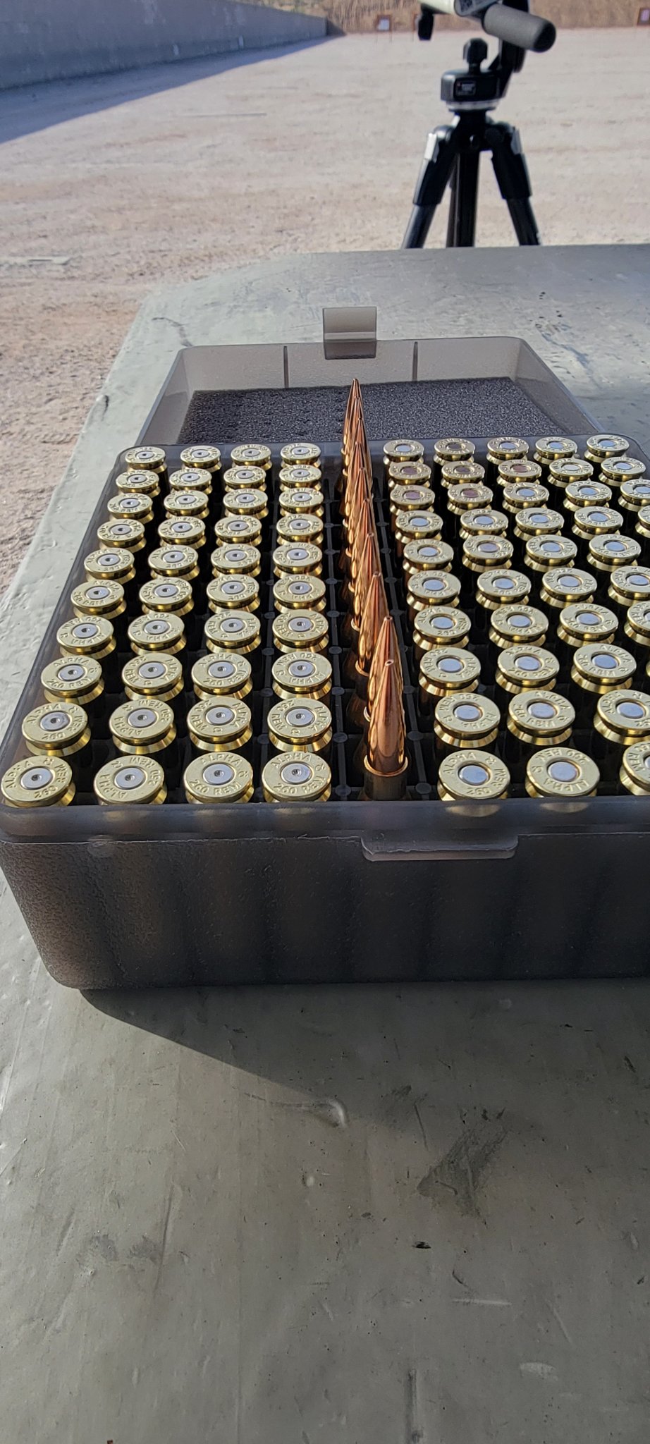

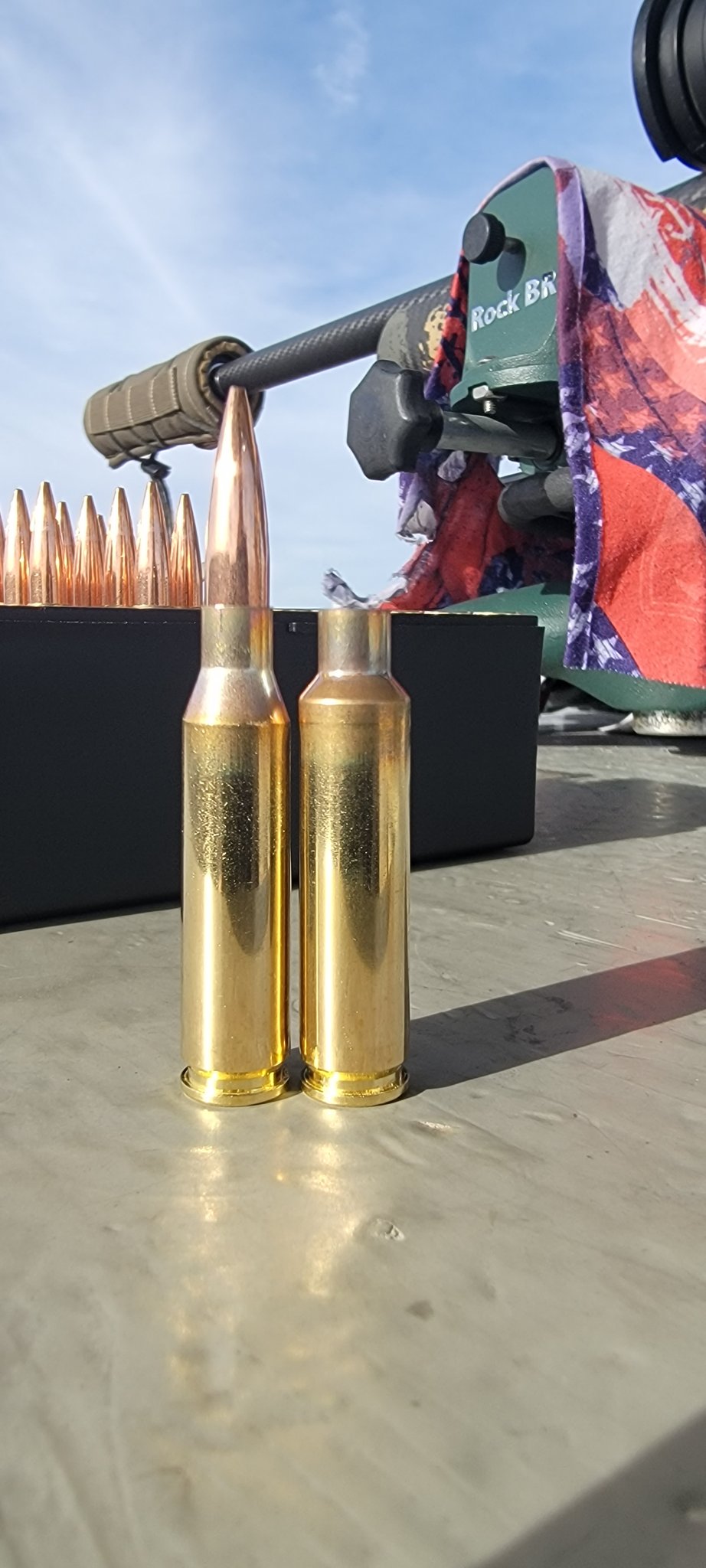

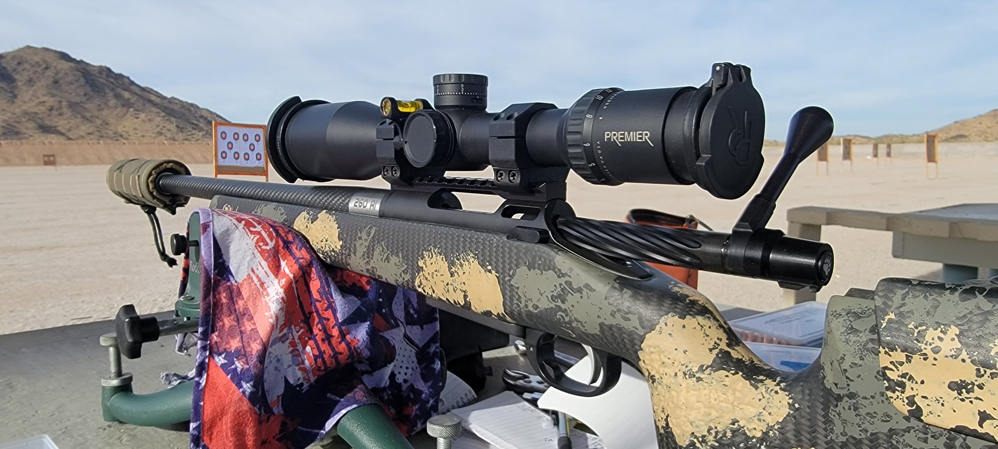

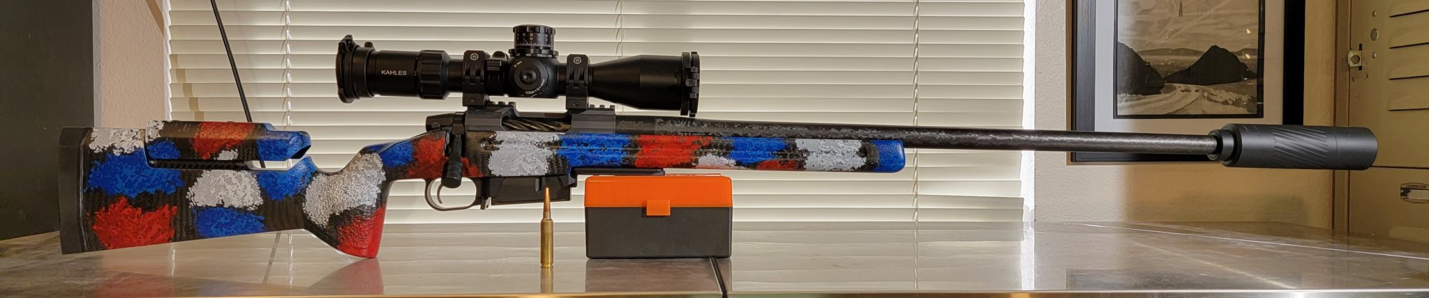

I shot out my old 6.5SLR barrel in 2800+ rounds, and did a rework on my 15.5# target rifle (that my daughter loves to hunt with, so I have to carry).
Swapped Manners T2A for a PRS2 w. Gen 2 mini chassis
Swapped 28" Bartlein Sendero for 22" Proof Sendero Light
Swapped Kahles K624i for S&B PMII 3-20×50US
Shaved 5 full pounds down to 10lbs 8oz.

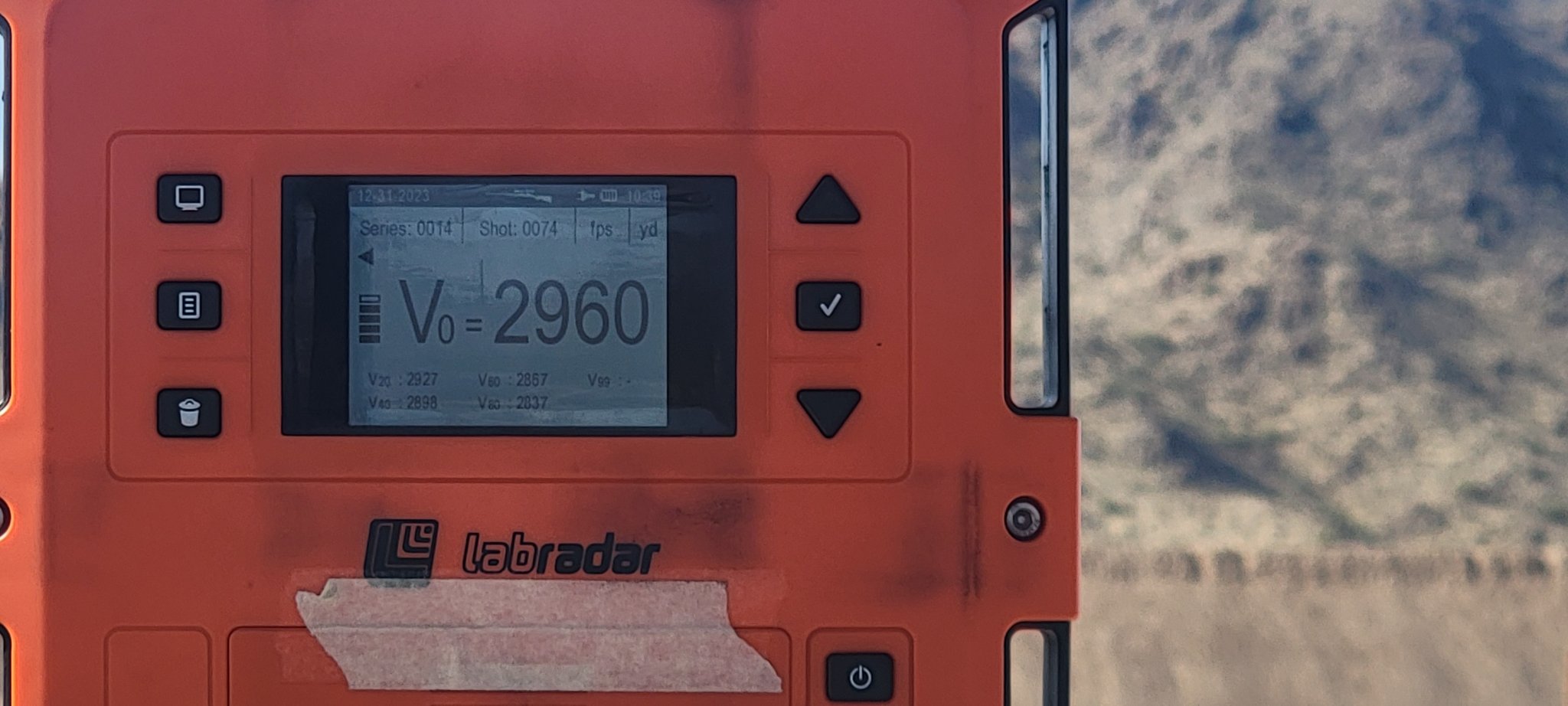

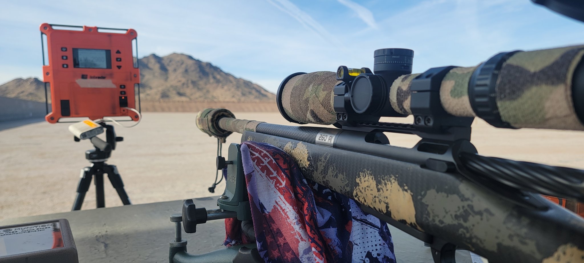

New load work up went well, and after 100 rounds to break it in, this is what I ended up with.
R700SA trued
PT&G bolt, fluted, mini M16 extractor, carbon fiber bolt knob, alloy bolt shroud
22" 1:8" Proof Sendero Light w. Area 419 brake blended to contour
Manners PRS2 w. Gen 2 mini chassis
Timney CE @ 8oz
Seekins alloy 20MOA Picatinny rail
Seekins alloy 34mm low rings
S&B PMII 3-20×50 US
Flatline Ops level
R-P .243 brass (used my old brass, since I still have 400+ pieces)
Fed GM210M
43.4gr H4350
130 Berger OTM
2.210" CBTO
2888fps
At 100
At 200
I thought my Labradar was not picking up the shots until I checked...
Reactions: camocorvette

Building a .260AI to comliment my daughter's 6.5SLR. (Also so I quit shooting it so much)
This is pretty much the final configuration (minus the 26" Proof Sendero Light barrel on the barreled action). Just waiting on my custom reamer w. .130FB vs the standard .050" FB. This is set up for the 140 Hyb to still fit in the Accurate mag and clear the Fuzion feed ramp seated to touch the lands.
Lone Peak Fuzion TI SA
24" 1:7.5" M24 Bartlein CF (not pictured)
TBAC CB w. TBAC Dominus CB
Manners MCS-LRH in custom "Americana" based paint
Hawkins M5 DBM w. Accurate mags
Bix N Andy Tac Sport Pro @ 4oz
ARC M10 34mm "low" rings
Kahles K318i SKMR2
Flatline Ops level
As shown, 10lbs 2oz scoped and suppressed
On hand:
300pcs Alpha SRP .260 Rem brass
Fed GM205M or CCI BR4
H4350
140 Berger Hyb and Sierra 130 TGK

How has the alpha SRP brass held up for you? Anything you would change on the build if you did it all over?
The thing is a tack driver.
130 OTMs @ 2999 for my steel load, or 3086 for my hunting load.
140s @ 2920 for a steel load, or 3000 for a hunting load.
Alpha brass is solid. Even with the hot hunting loads, I have 5x firings with tight primer pockets.
I like it so much...I have a new short/lighter build I am doing as we speak.
Kelbly Atlas Lite SA
20" 1:7.5" Benchmark CF Sendero Light
TBAC CB to run the Dominus on
Manners LRH (might still be waiting for a while, but I have an EH1 for a loaner)
Hawkins M5 Oberndorf BDL w. Wyatt's extended box OR Hawkins Hunter DBM w Accurate mags
Bixn Andy Tac Sport Pro X
ARC M-Brace 30mm low rings
Premier Heritage Light Tactical 3-15x50

Went yesterday and shot some fire forming loads from 450 to 1008 yesterday. Missed one shot at 989 due to a wind call. But 19 out of 20 hits wasn't too shabby.
This morning, I took it to the range to fire form some more brass (40 rounds of 130 OTMs @ 2820fps, across 4.5 hours and fired at the same target), and also tested some 140 Hybs in once fired formed brass. I tested H4350 and the "magic" RL26 just to see if the claims of "an additional 100fps" were realistic.
H4350 topped.out at a whopping 2915fps from my 20" 1:7.5" Benchmark! I was pleasantly surprised. I was hoping for 2850. But best accuracy was at 2880fps.
RL26 started out a lot slower than I thought (2750fps), and I was pretty disappointed. So.I actually skipped the next charge weight, planning on shooting every other one to see of it improved. Charge weight #3 was 2850, just .8gr over #1. RL26 would end up topping out at 3011fps, but it started to open up. Just a hint of an ejector shine on one case, sonit is max. From a 20" pushing a 140 Hyb. Best accuracy was at 2960 and 2982. The RL26 was not as accurate as the H4350 loads, but I think seating depths might bring them in some.
Dang. That’s what my new 20” barrel on my 6.5 PRC is getting with the 140 elite hunter. 58.3 N560.
