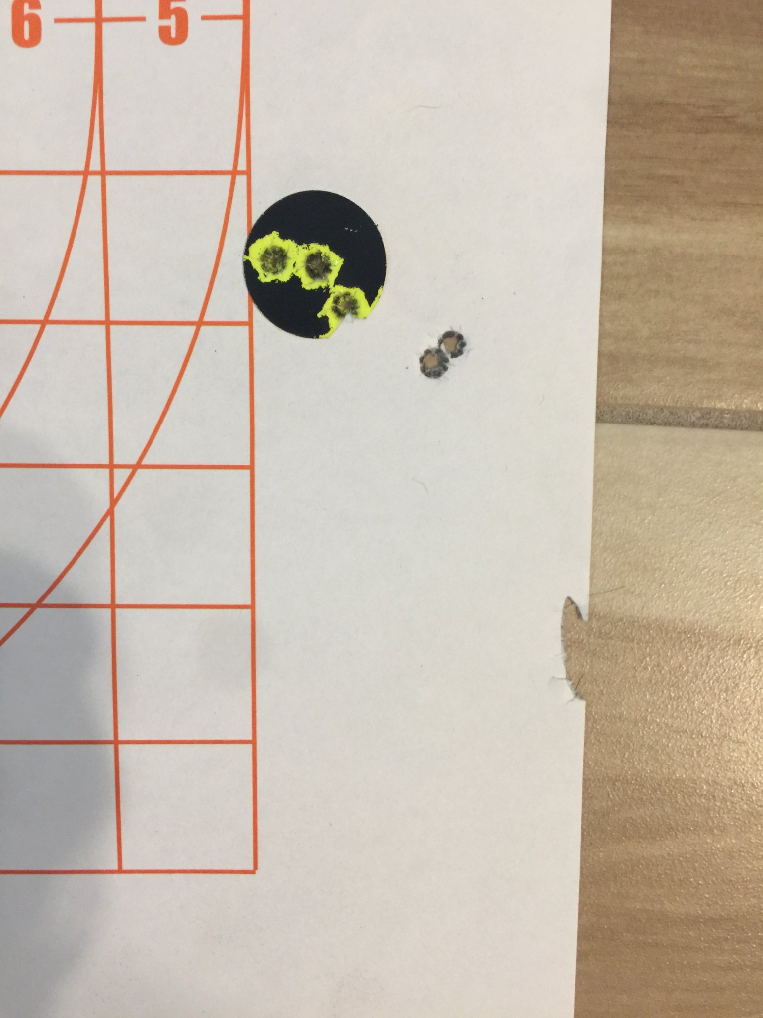

I have evidence that 88 ELD-Ms are blowing up out of my 224 predator, 6.5 twist, when pushed past ~2800 fps. Roughly one in 10 would not make it to the 100 yard target. Then I caught one in the act. There should be 6 in that group. That low-right mark is not a staple pull...

Now that’s really catching it. I’ve seen bullets turn into a puff of dust from my 22-250 but you caught that one tumbling. Great catch and thanks for sharing that pic👍

It can be really aggravating too. I couldn’t figure out why I wasn’t hitting the target until I passed my rifle to a friend and watched through the spotting scope. Then I caught a glimpse of the puff of dust that used to be my bullet.
