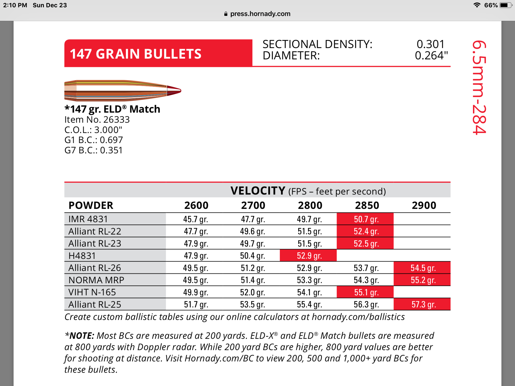

    What was the COAL that you used amigo? By the way, just in case the rookie found something that wasn’t common knowledge.
    Thank you. From what I have read previously and based on the stated max of 54.5g RL26 for the 147ELD from Hornady, shouldn’t your load be roughly a .7g step down from max in RL26 for the 140g ELD? I’m thinking that there shouldn’t be a pressure issue with your load using a SAAMI spec Norma Chamber. Reasonably certain my dumb ass will get corrected if I’m wrong?
    The logic behind the thought is that 1. Stated max’s are generally low I.e. 1 grain of powder or more rifle dependent. 2. .1g steps away from stated max in powder charge for every 1 grain of bullet weight reduction. Thoughts?
    Reactions: j-huskey
    Easy to miss what I posted as you have to click and expand to see it so I’m throwing it up again.

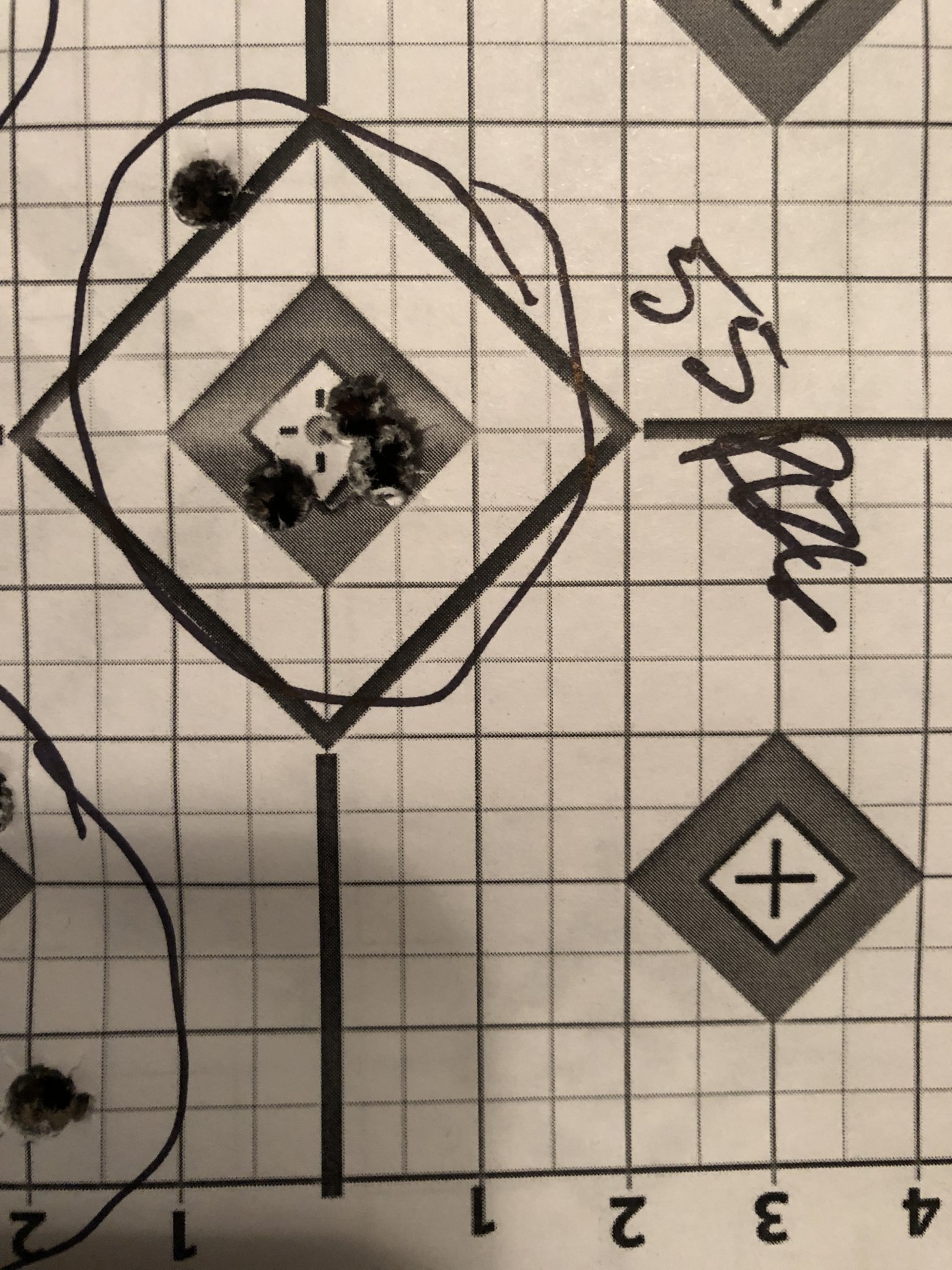

    Quick update fellas....tested the RL26 @54.5 behind an ELDM 140 and not stellar result but put the gun on paper with the scope. Went to the 147ELDM with RL26 and she tightened up from 54-55 with 55 being the sweet spot so far. Confirm tomorrow with 55 grains RL26 but I think I’m probably done with that load. 55g RL26, Fed210, Lapua virgin brass sized prior to loading (to much neck tension), 147 ELDM and 3.00 COAL. Find out tomorrow if the group below was 1/2” fever or load issue. Relatively certain it was the dummy behind the trigger. Take the pic a quarter turn counter clockwise and that’s how I shot it.
    Have some of the other suggestions loaded up and ready to go for the 140 class that I will test but if this load bears out I think I’m done.......if I can find more RL26???? Big shout out and thank you guys for the help!!!?
