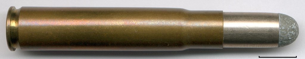

You may have found some of my posts on other 'sites, or have just swiped some of the same internet images as I.
By the way, the 'Breda' (Y1903/14/27) MS were very likely manufactured at Steyr in Austria and merely 'drop shipped' through Breda to avoid export restrictions of the day. Another theory holds that they were assembled at Breda of Steyr made parts but there is no firm evidence to support.
The 'actions' of 'Greek Contract' (Y1903, Y1903/14. Y1903/14/27, 'System 1930') are identical to the pre WW2 built M1903 Mannlicher Schoenauer. They were prototyped as M1900, introduced at the Paris World's Fair (Exposition Universelle de Paris) of that year.

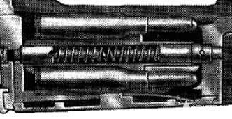

Cartridge is 6.5X54 and the Schoenauer magazine, though the smoothest ever when properly fed, is rather particular as to its diet. Look at the image you've posted of magazine with cartridges and consider that the cartridges act as roller bearings in a race.

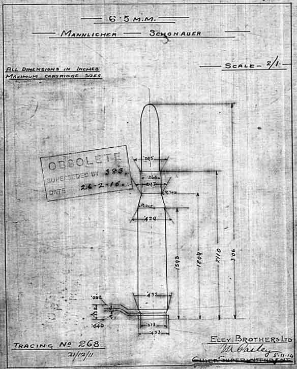

Take up reloading, make them exactly like this:

There were.
The 6.5X54MS is the direct descendant of the 6.5X53R (rimmed) and is loaded to the same specs, including projectiles.
Custom gunmakers produced rifles to chamber the 6.5X54MS based on actions other than Steyr's Mannlicher Schoenauer.
The '.256 Mannlicher Schoenauer' designation was British.

You should be able to load two, especially if you load three of the original profile below them (live or 'dummy').
It's usually the third cartridge that will tip and jam in a void if the projectile does not conform closely to the Schoenauer magazine's spool. It's the cartridge OAL and profile at the 'top third' that counts.
Mine will not load a single spitzer from the magazine. Not paying the atrocious prices where I can find round nose loaded ammo.
ADDED: tried different seating depths, no fix. So, it's mostly the profile of the case in relation to the shape of the magazine followers.
