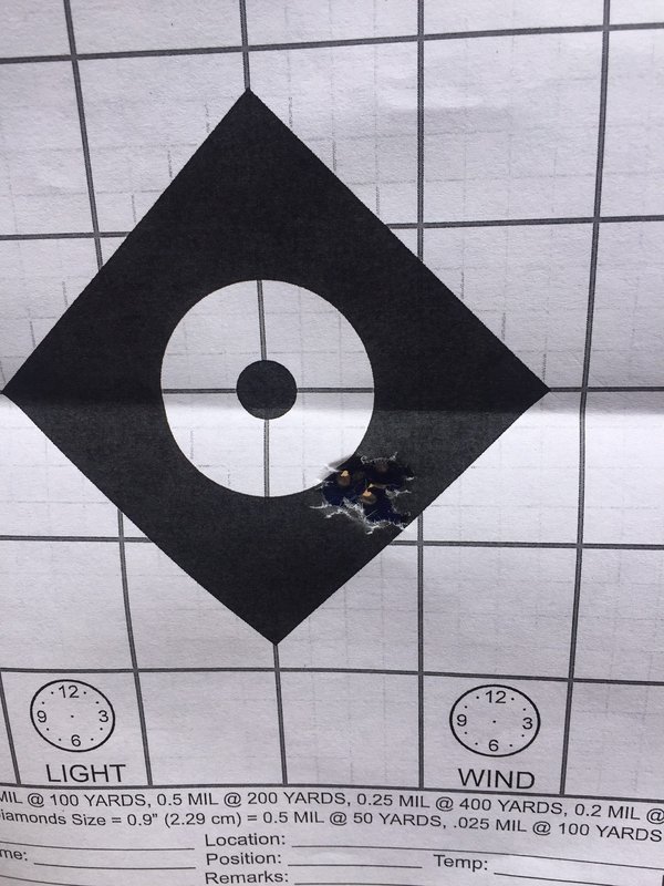

I shoot an Rbros 6.5 Creedmoor, Defiance Action, Broughton barrel, etc. and using AW magazines. The chamber was cut with 130gr VLD's in mind. My load using the 130's and H4350 at 43.6 to 43.8 depending on the powder lot that I have and yields around 2925 to 2950 fps. The 130's are touching the lands. It shoots remarkably well, like under 1/2" groups. These cartridges fit in the magazine with no problem. Give Travis a call at Rbros Rifles, nice guy and i'm sure he will help you out with either answers to your questions or doing some work for you. Here is a pic of first suppressed group fired. IMG_0659.JPG
