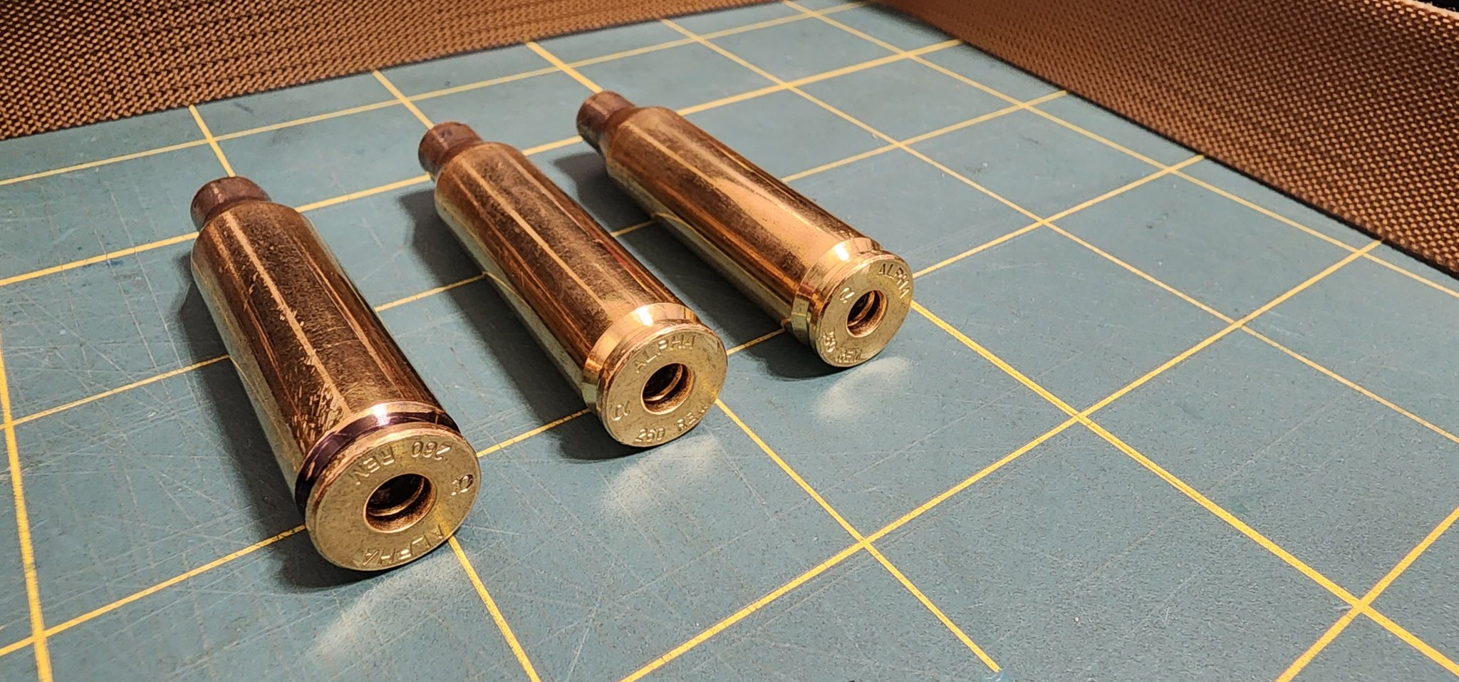

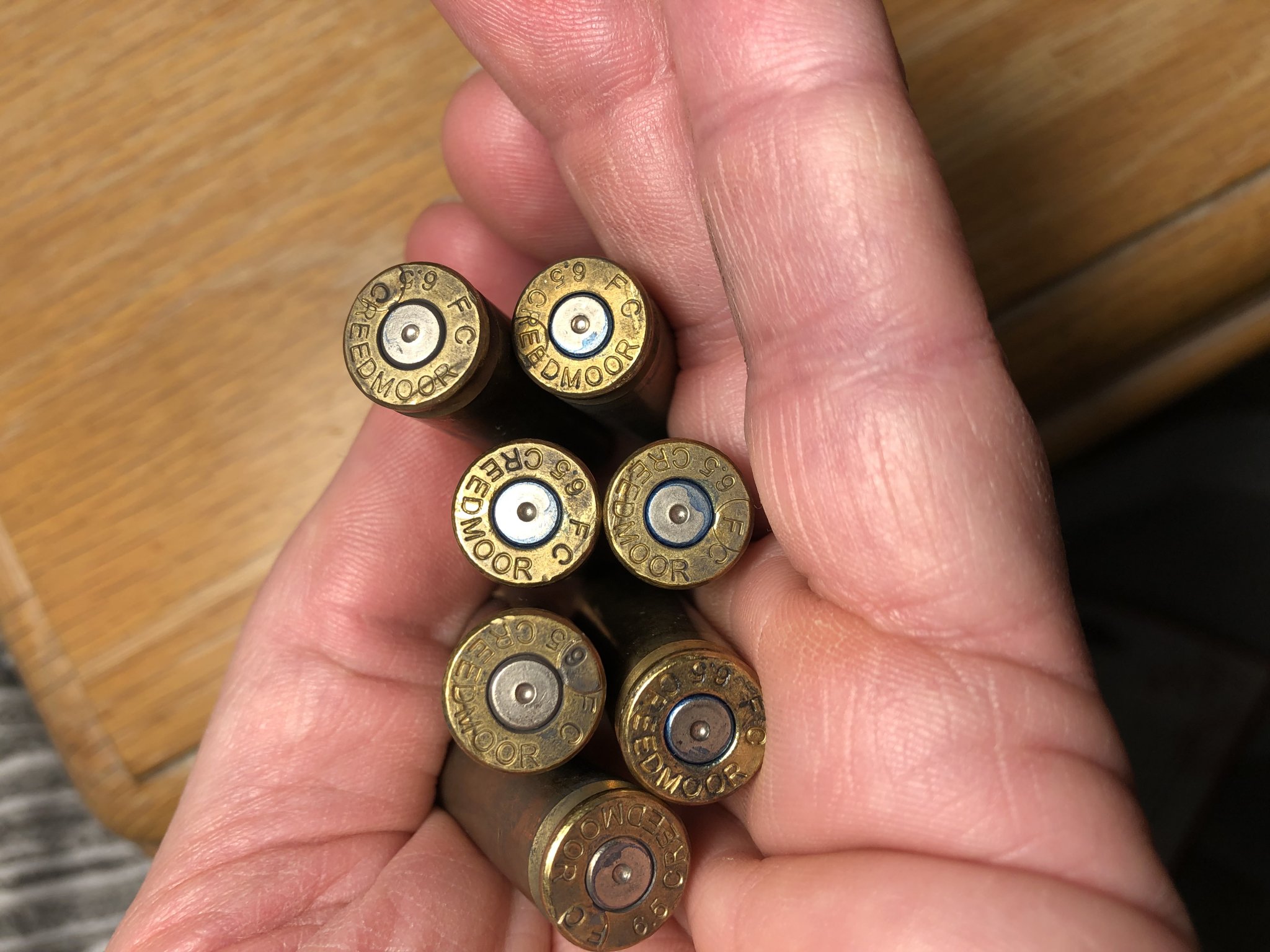

Can you post a picture of your fired brass
yes, i am sorry for the delay. the one on the left has same type of marks, the sun is just hitting it differently

What weight bullets are you shooting?
You already saw the ejector impression, that takes a tremendous amount of force to imprint like that.
If you are shooting 140s, that's likely the issue. A lot of the 140s have a longer bearing surface as well.
Your brass does look like the carbon covered the entire side, but I can not tell. That's a sign your rifle is ripping the case out of the chamber prematurely in relation to when its meant to do so. You'll notice that that brass will also be harder to size(unless it's super high quality brass it might not). Sometimes people think that's from a horrible and oversized chamber but it's not.

I need to see the side view on the brass to make a guess, that will tell us more. The two pics I posted above are showing what I'd look for. I tried to find pics of brass from guns that were violently timed wrong, but I can't find any.

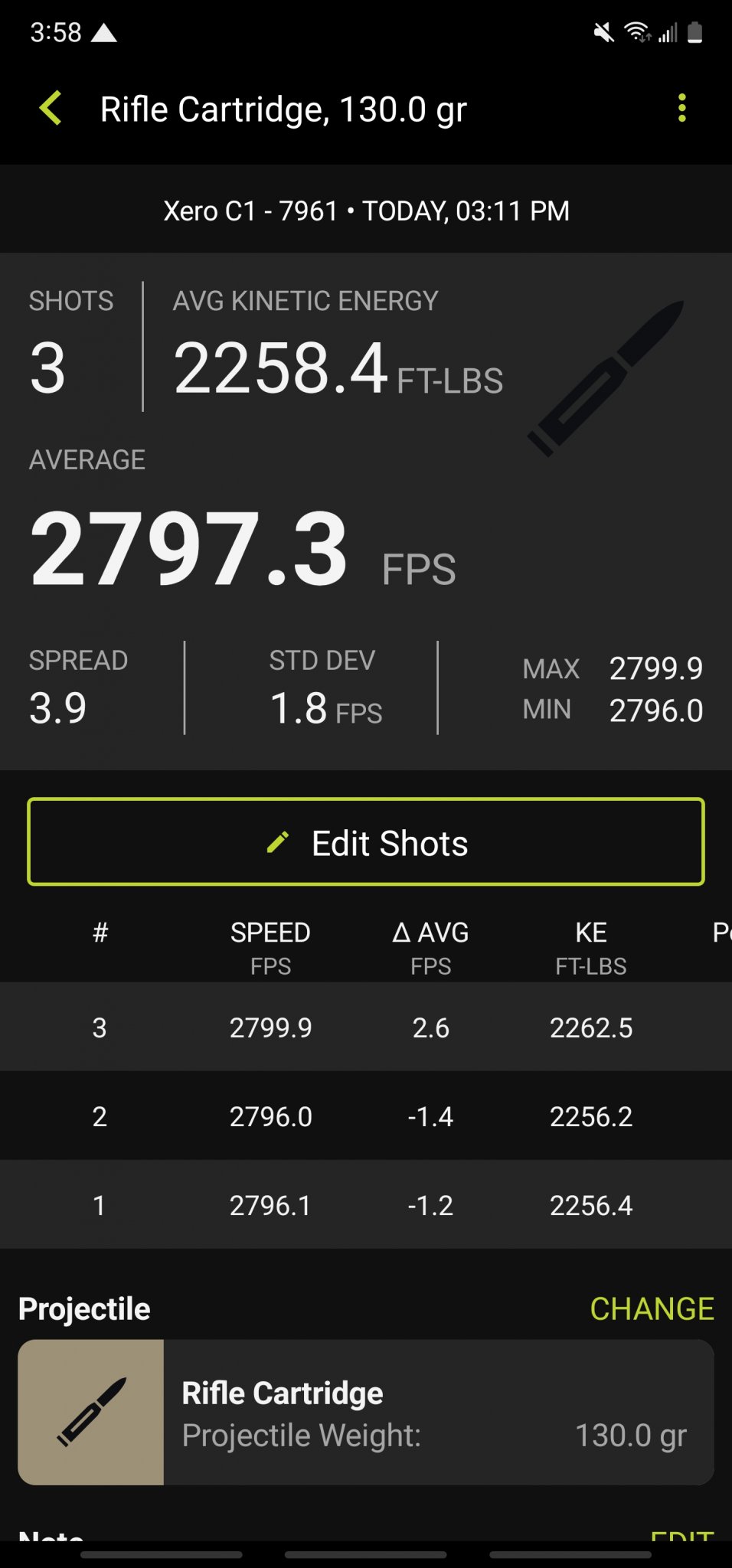

But, 130s should typically be fine, did you capture any muzzle velocity? There is a chance it could have been a hot lot#?
You could try more buffer weight...try to post more pics of the brass in good light though. Line up 10 pieces or so if you can.

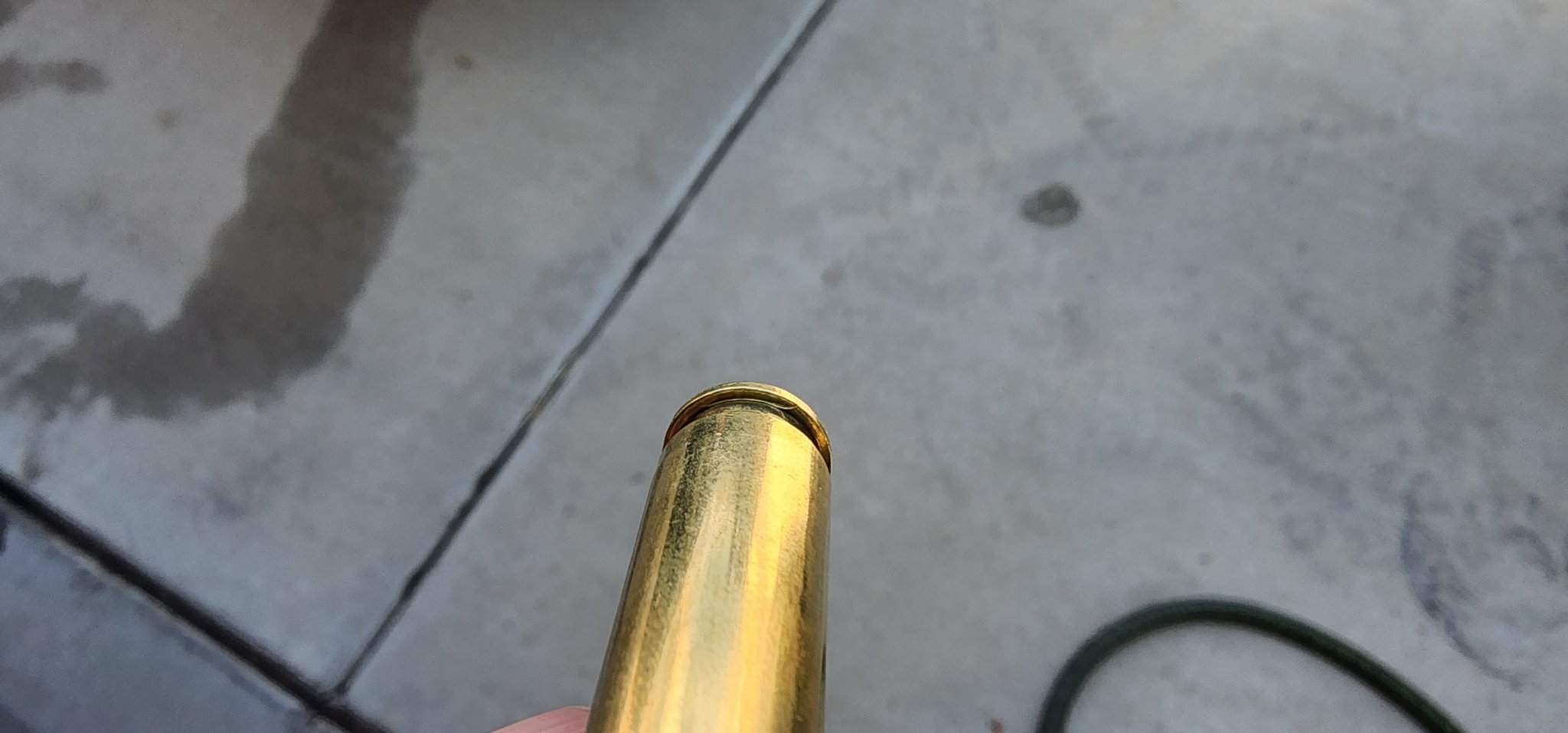

Side view too, and into the rims if you can get it
Like these

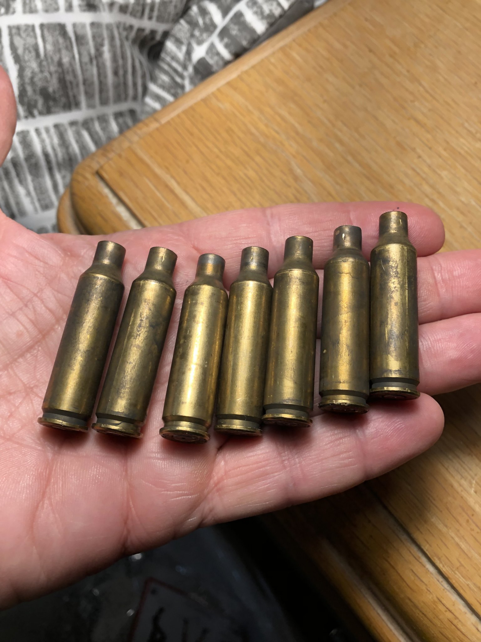

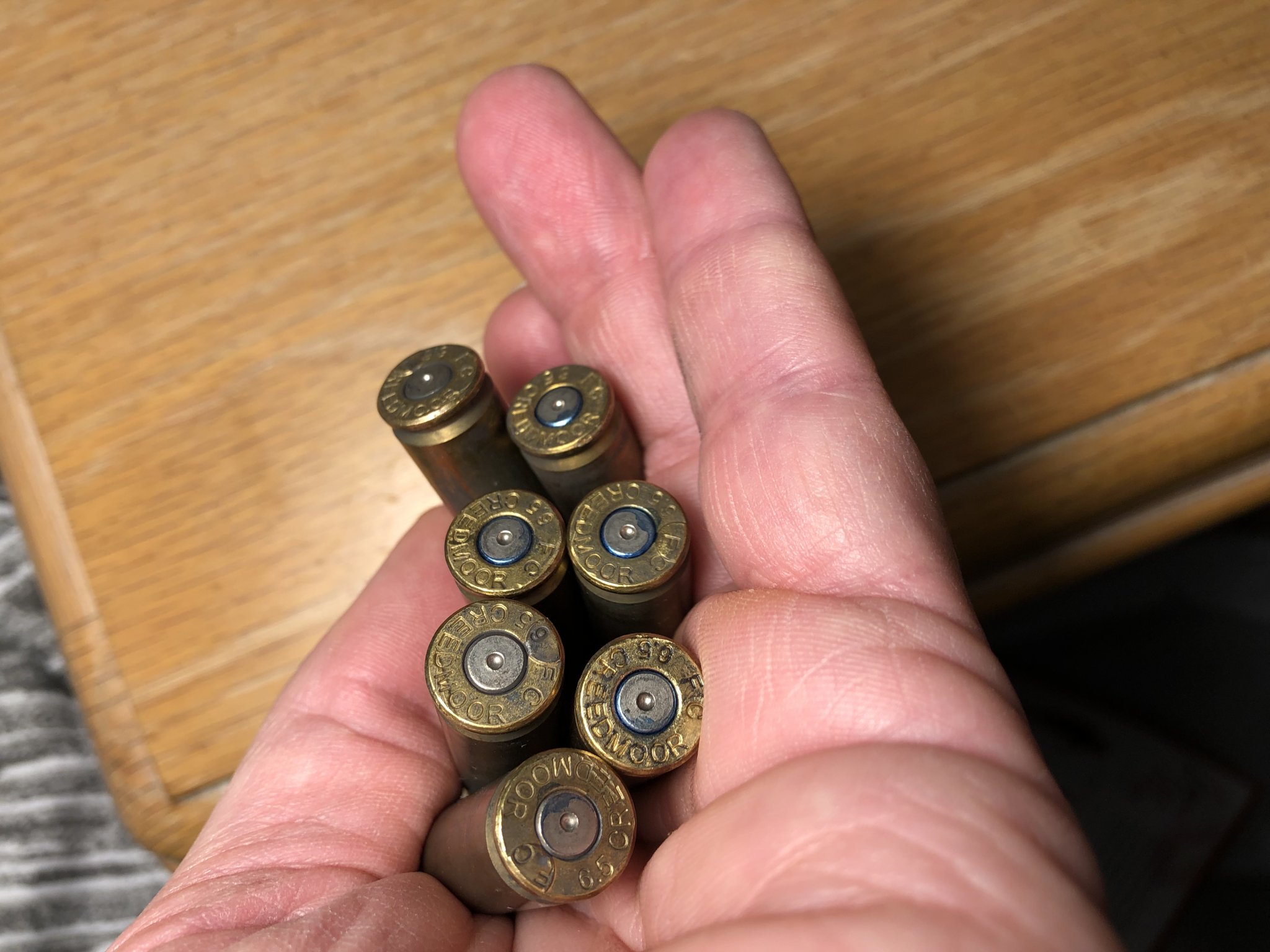

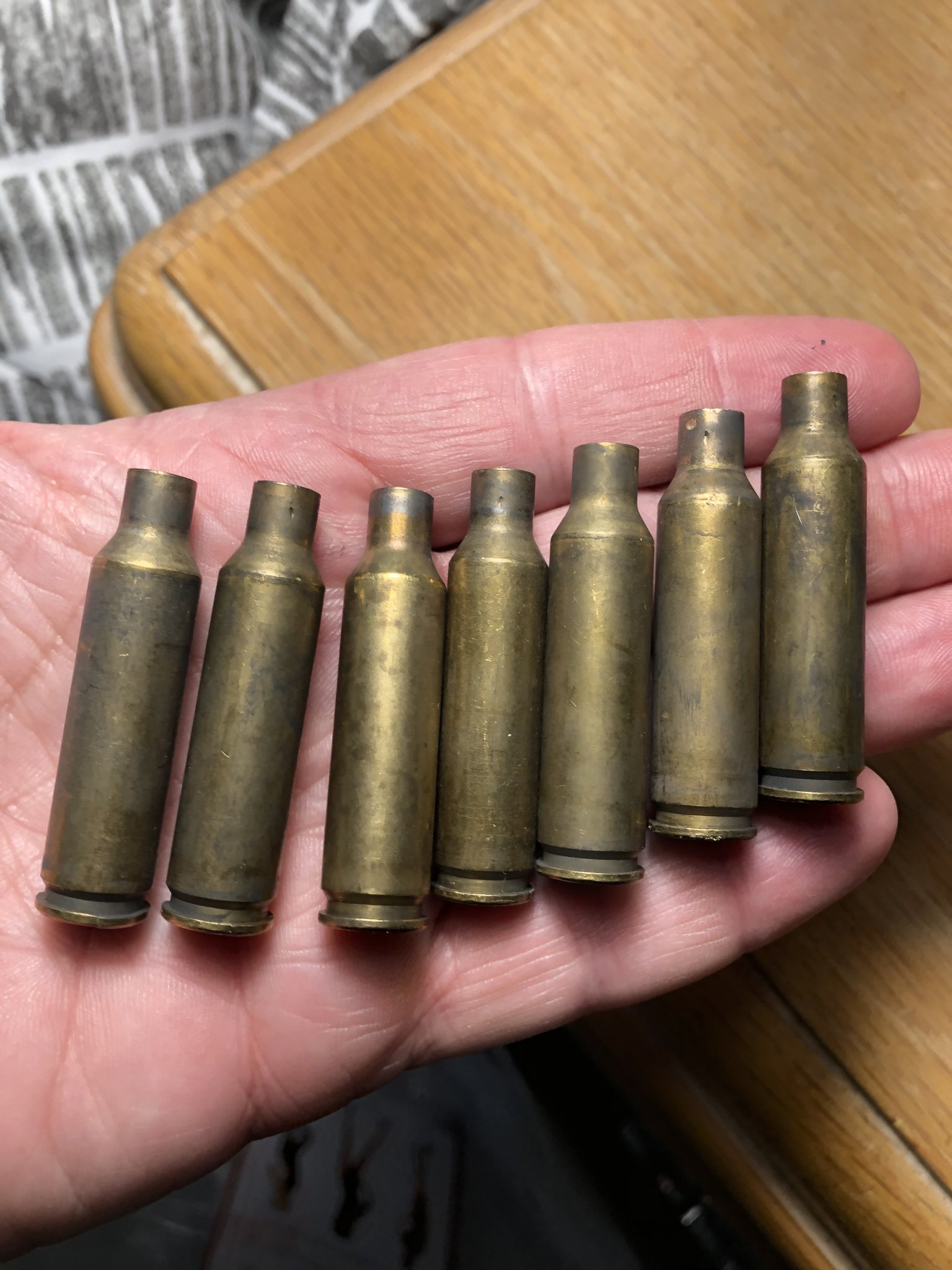

That’s coming out of your A.R. 10? Wow, your brass is nice and clean compared to mine even the new stuff Hornady that shooting well out of a 10 round magazine in the bottom eight are pretty filthy, anyways here’s some pics of the federal stuff that I stopped shooting.i did roll Them around for a couple different angles of the sides. It’s not all just one side.

Primers look good, but dirtier cases than the Hornady I shoot (depending on which gun).

oh no,, it is cycling fine, piece of cake. i was having overpressure problems until i switched to hornady 95 gr ammo. now i was just wondering why i had over pressure, and was looking into reducing blowback since it is a pretty short barrel, 16", suppressed

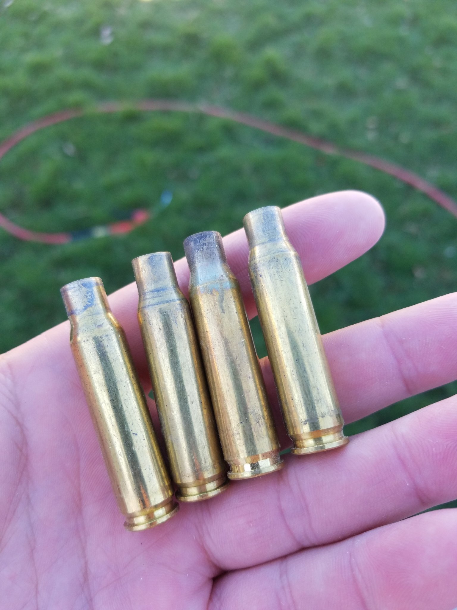

Your bolt is unlocking too early. The extractor trying to rip the rim off is a good sign as well as the false pressure signs on your brass. Which buffer weight are you using? Whatever it is, it needs to be heavier. Possibly a stiffer spring as well. An adj gasblock does help but as you can see from your rifle, it isn’t a fix.

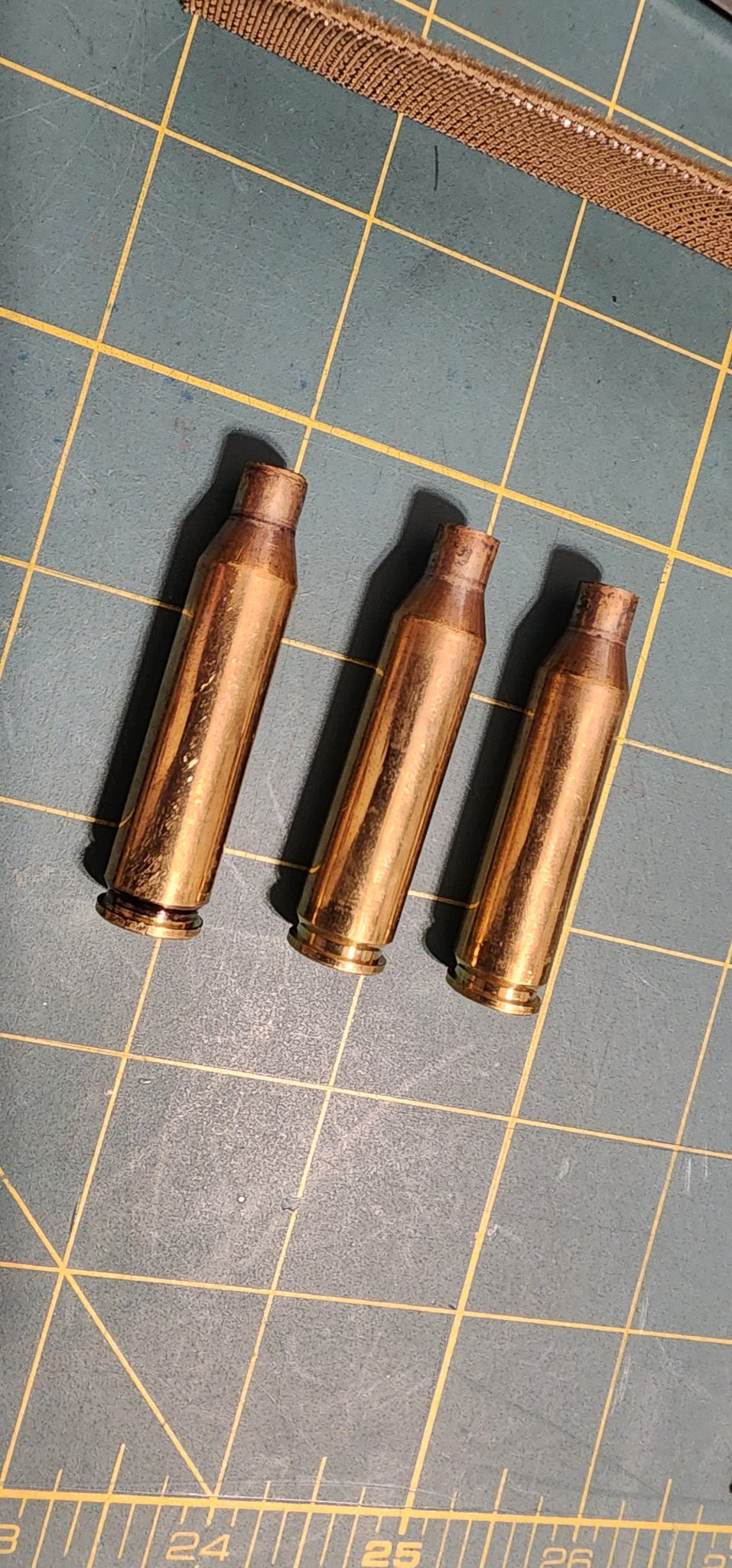

So I am kinda thinking the same as above. And after seeing your brass it's way dirty, you are definitely over gassed.
You need to reduce gas, probably by an adjustable gas block first.

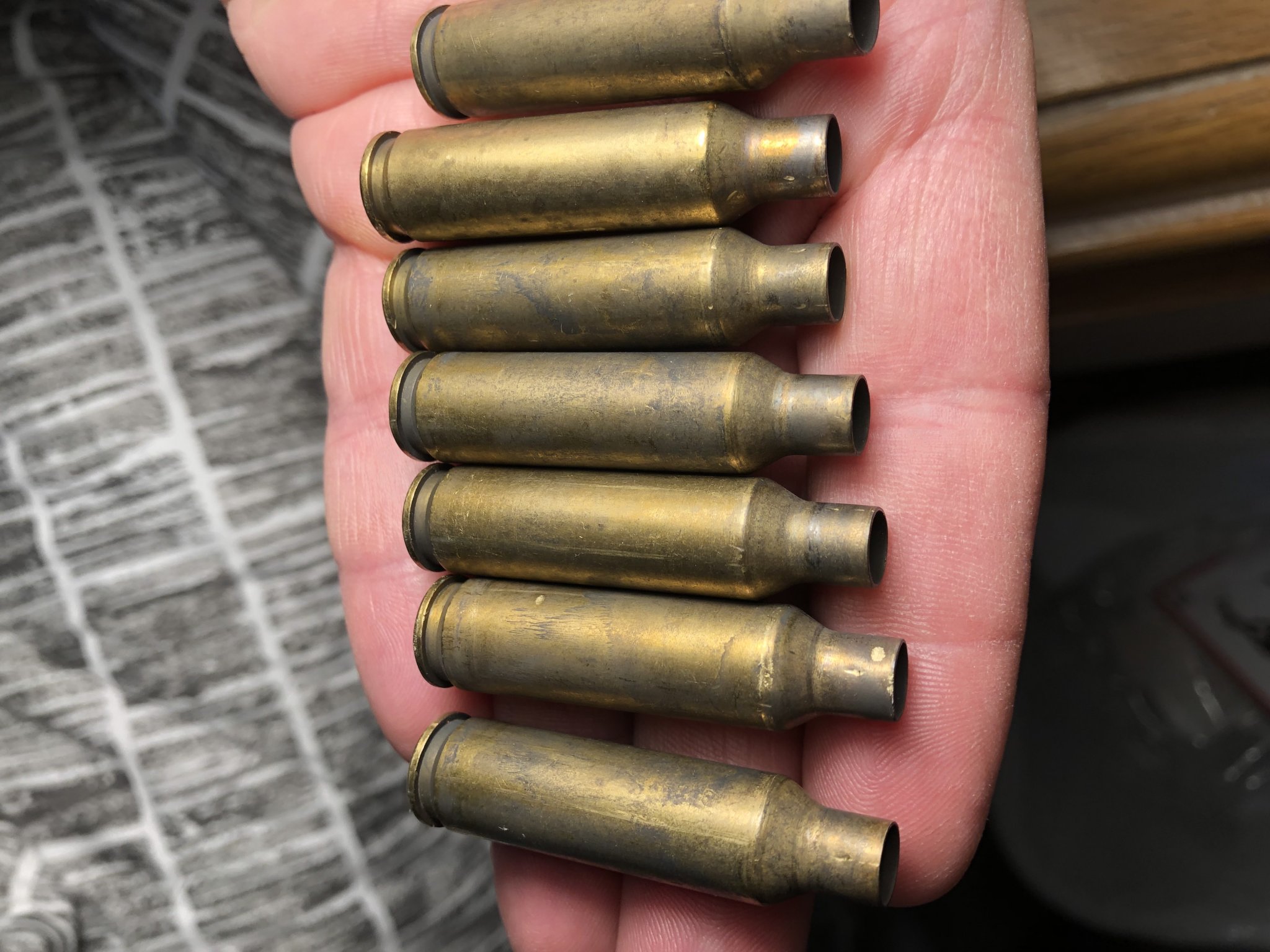

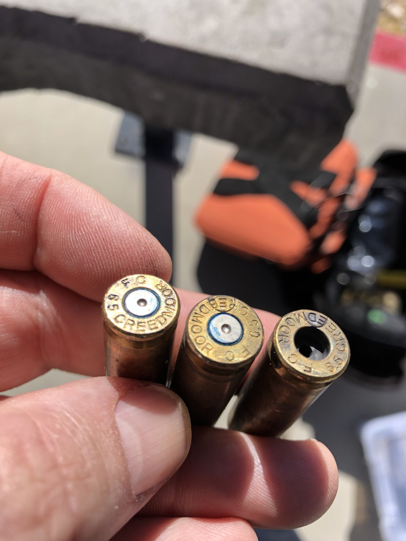

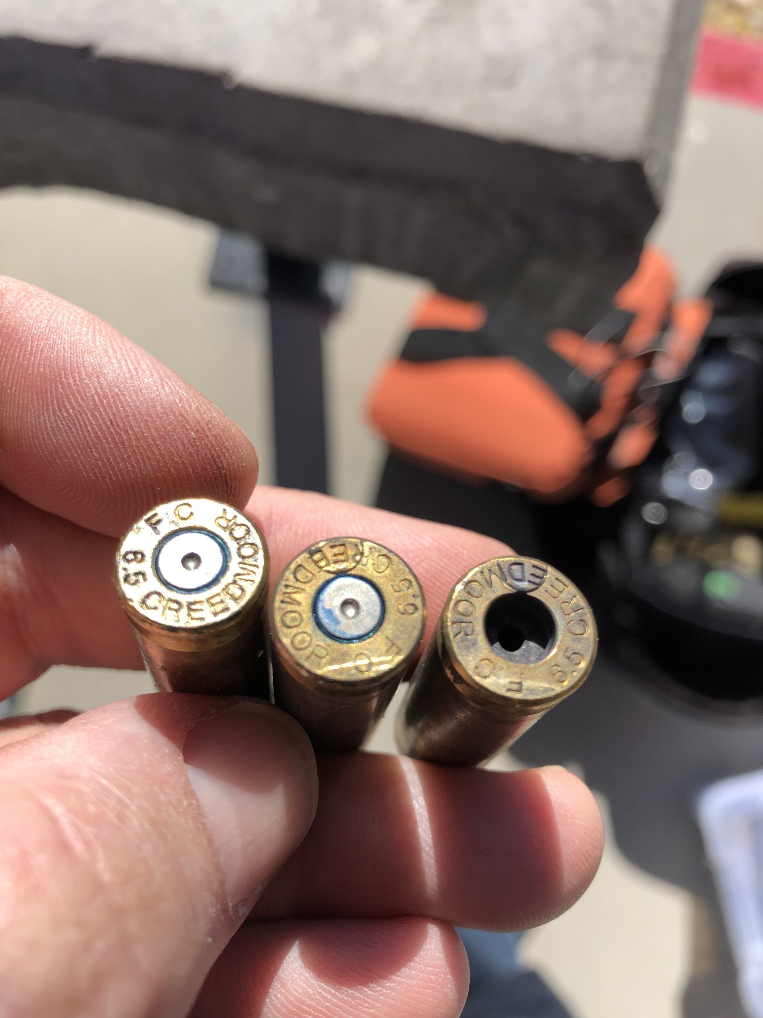

Okay these are three pieces of alpha brass I just shot the other day, what I consider almost a perfect hand load. I'll add the velocity data as well. At about 2800 mv for a 130 AR Hybrid.

Okay if he has adjustable gas, it's set way too high.
An agb will not fix a rifle that unlocks too early all on its own. It can slow down a bcg from an overgassed rifle though. Two separate issues.

hornady 95gr amax's working well at 3020 fps
the fed fggm 130 bergers was shooting 2650 i do not know if that is hot in a 16" barrel
i posted some more pics if you want to see them.
Once you do that look at:
1. Spring
2. Buffer weight
The tendency is to go heavier spring, which is not usually right for full mass bcgs.
