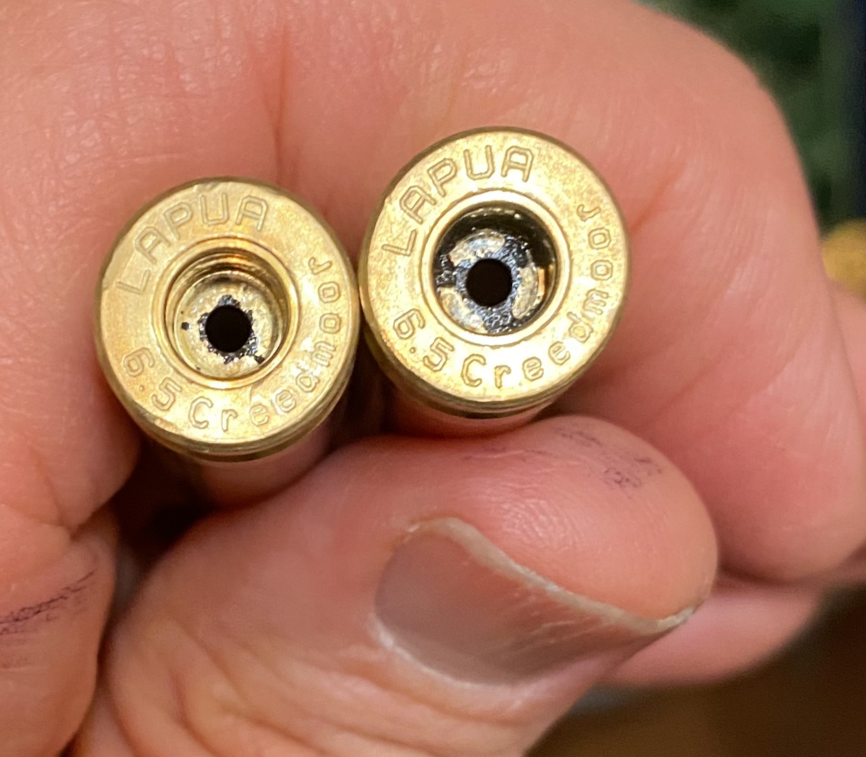

Not sure which COA you selected. I had brass getting beat like Ike beat Tina with the standard rifle length gas system on a Compass Lake 6.5 upper. A member here, forgot which one, suggested that I get one of the Superlative Arms AGB. I have done some testing and so far it’s improved things with the Lapua brass I use. Could possibly provide you with an interim solution before you get your new uppers.
Reactions: DIBBS
Give me a second to take one out of the cleaner and I’ll post a pic.
Much better than without the AGB
