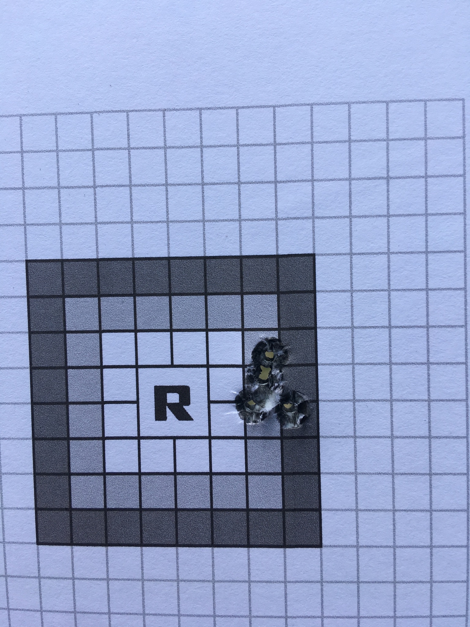

my best group in the 2 day course was just under 0.750” 5 shot @ 100 yards, prone. Since i have seen 0.30” groups reported with similar Tikka T3x & match ammo, my skills are the issue. I have previously posted about my eyesight/optic issue & was able to replicate the errors this weekend—i keep the power under 20X and am doing ok.

i think you mean lands. And different bullets like different jumps (distance to the lands). ELDM’s and Berger hybrids are pretty insensitive to jump. VLD’s are very sensitive to jump. But judging by the group above you’re fine where you’re at especially if that’s a consistent group size.
yes. Lands. I planned Berger Hybrid, but didn’t have enough 140s, so Hornady was “Plan B.” I impressed myself with that group. The instructor had me look at the plastic board behind to show all 5 exits—i was convinced I totally missed.
