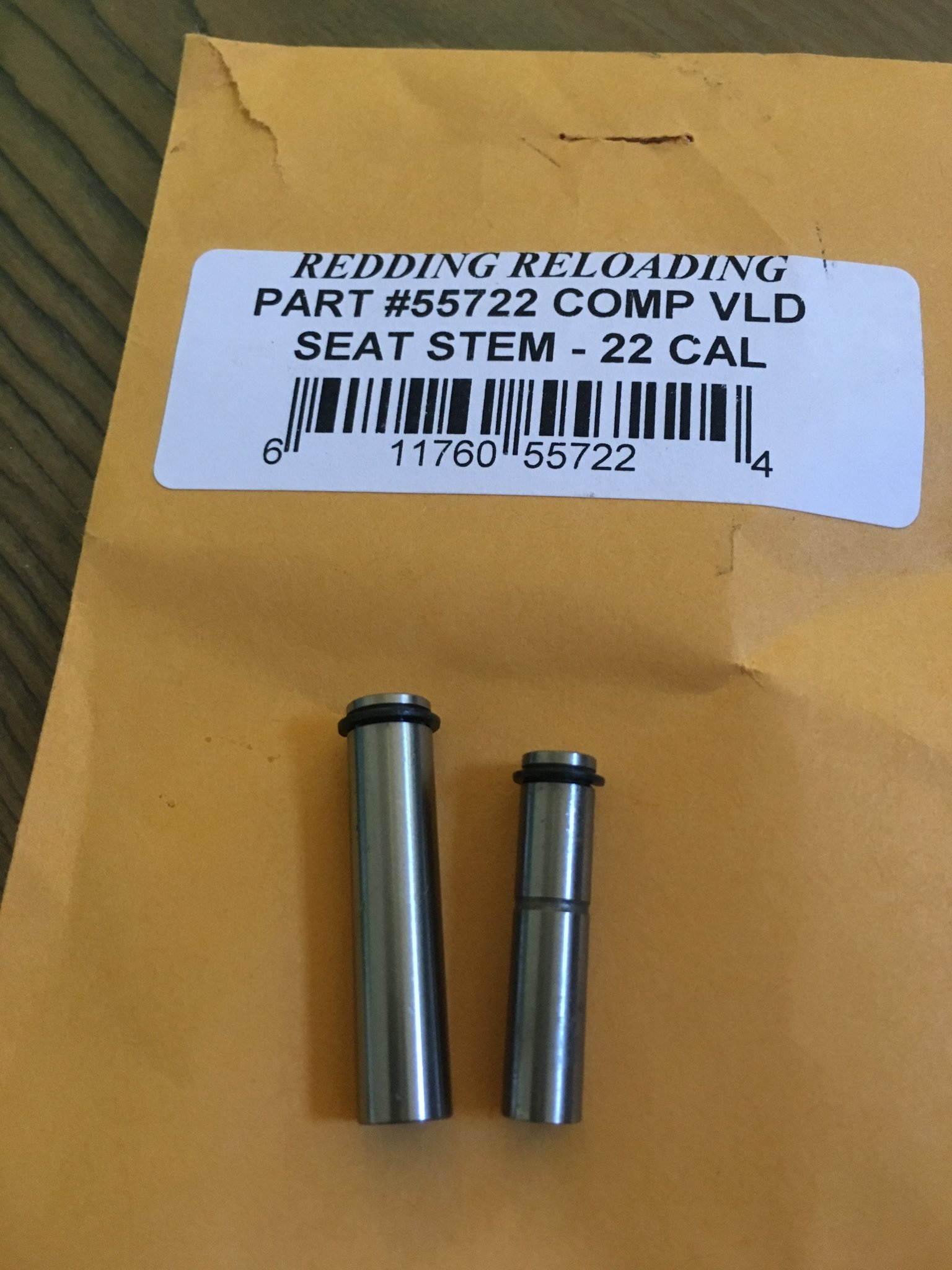

6.5CM Redding seating die with 22cal seating stem

Just got a 22 cal VLD seating stem for my 6.5CM Redding micrometer seating die to load up some 22CM dummy rounds and this thing is significantly smaller in OD and OAL. Anyone have a idea on what seating stem to order? Photo shows the product number ordered, left stem is 6.5, right is the new 22cal

It nearly falls through the body. It’s not even close, and is to short I would never be able to find a seating depth
No, I meant try seating with the 6.5 seating plug, Tubbs 6XC seater uses a 30cal plug, it may work even better than the 22 plug, grip the bullet farther down the ogive.
