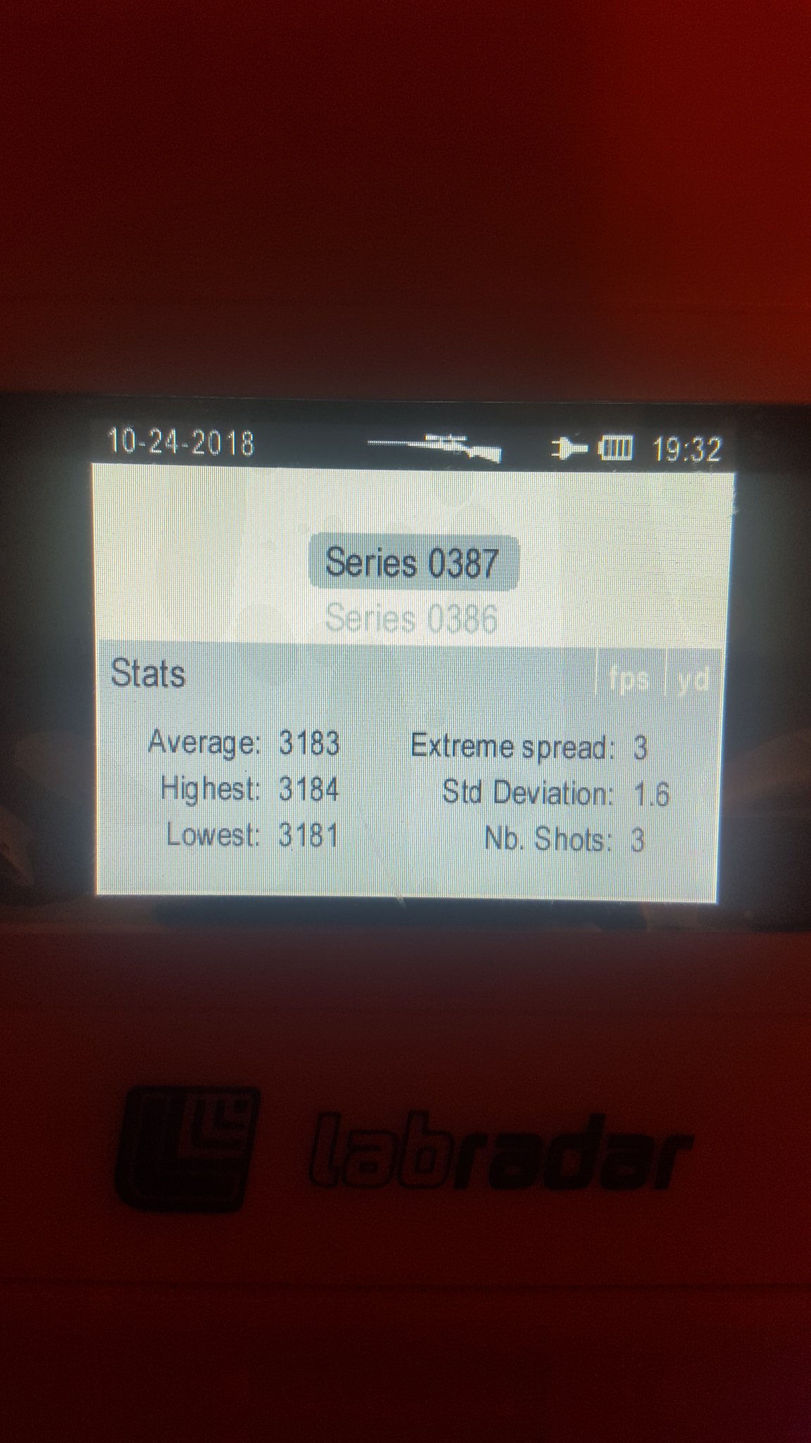

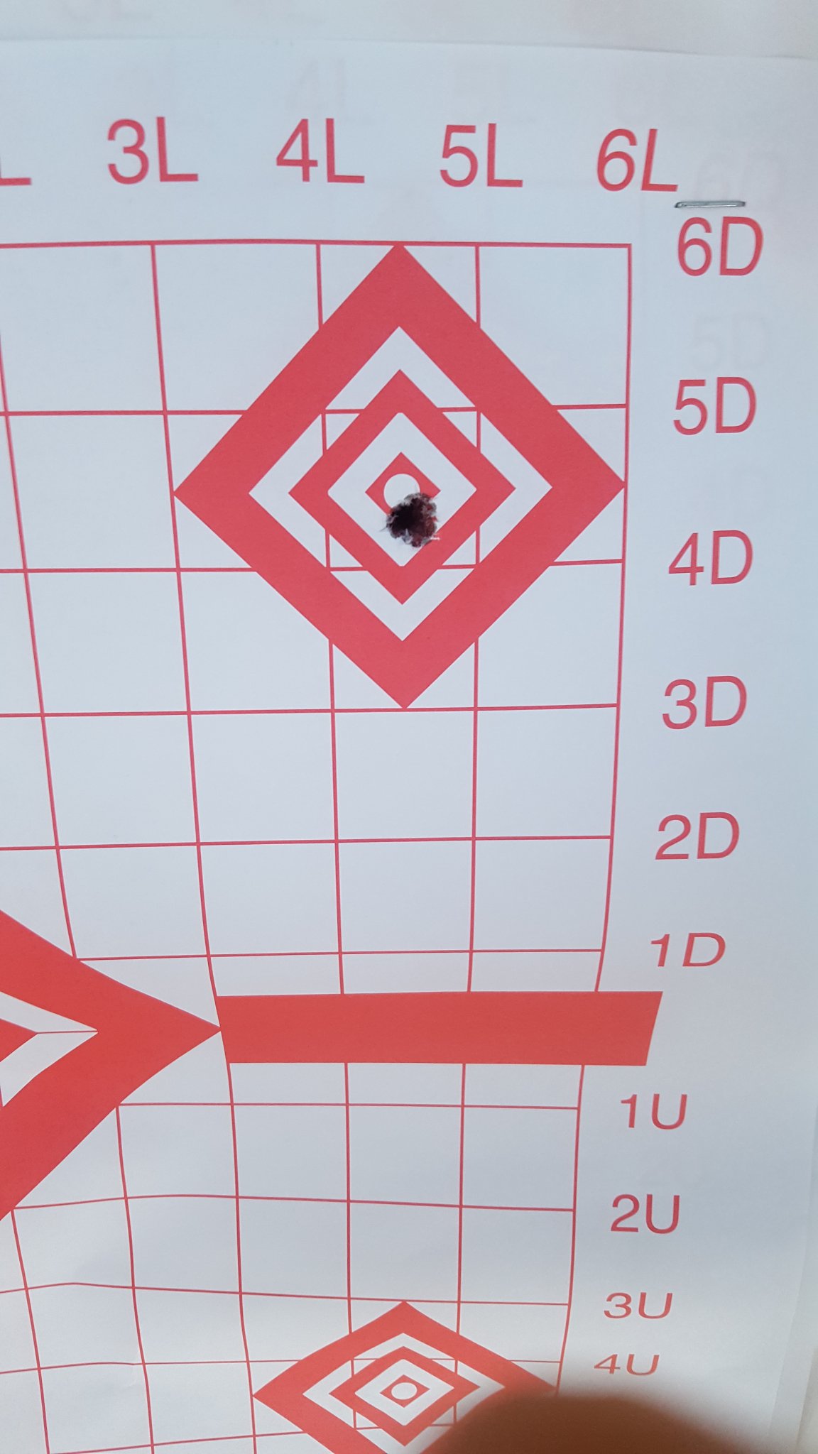

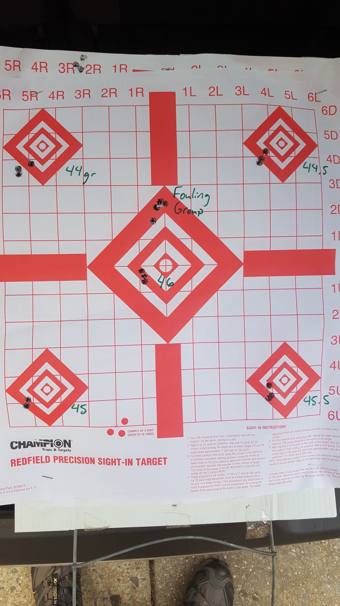

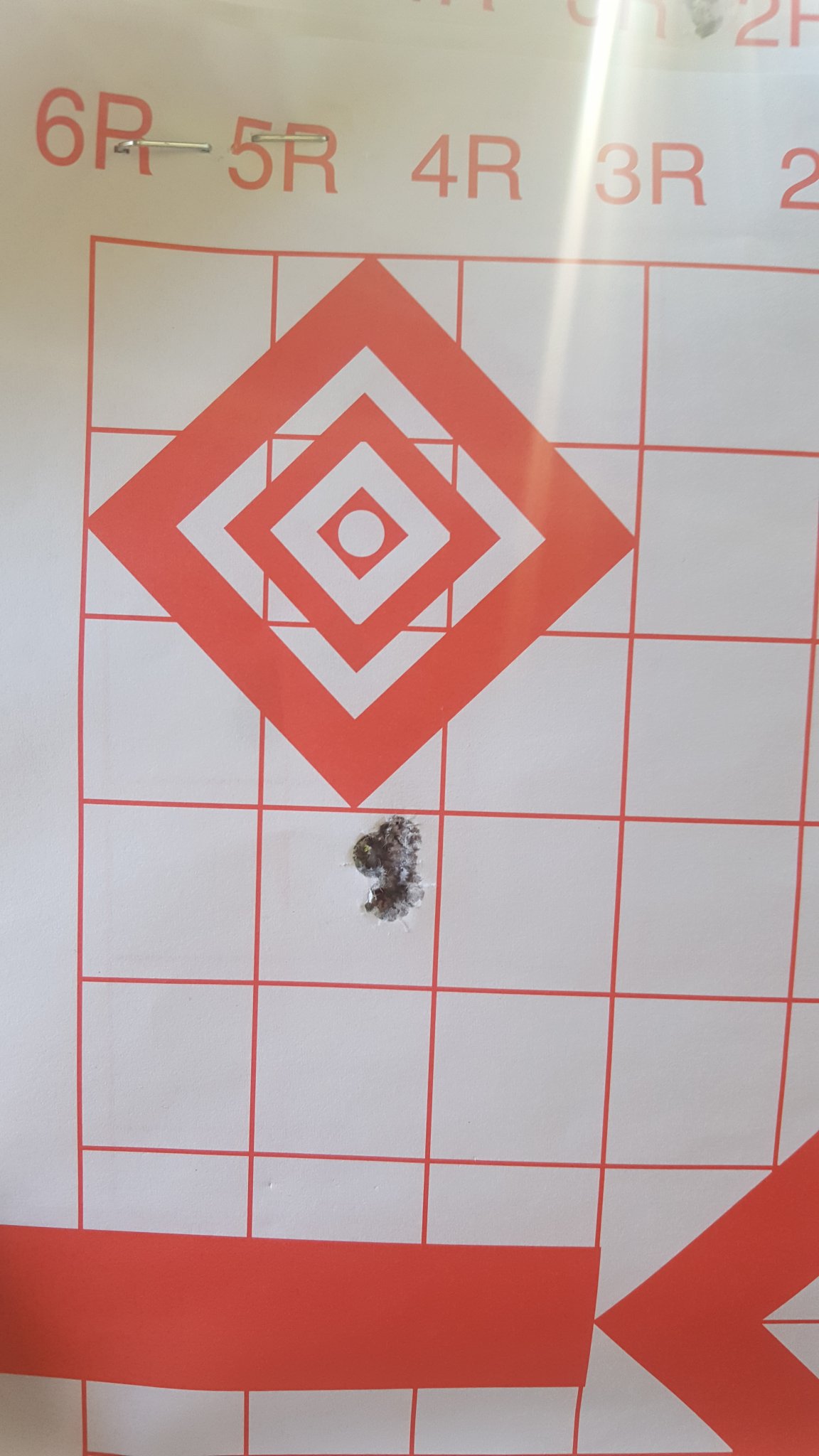

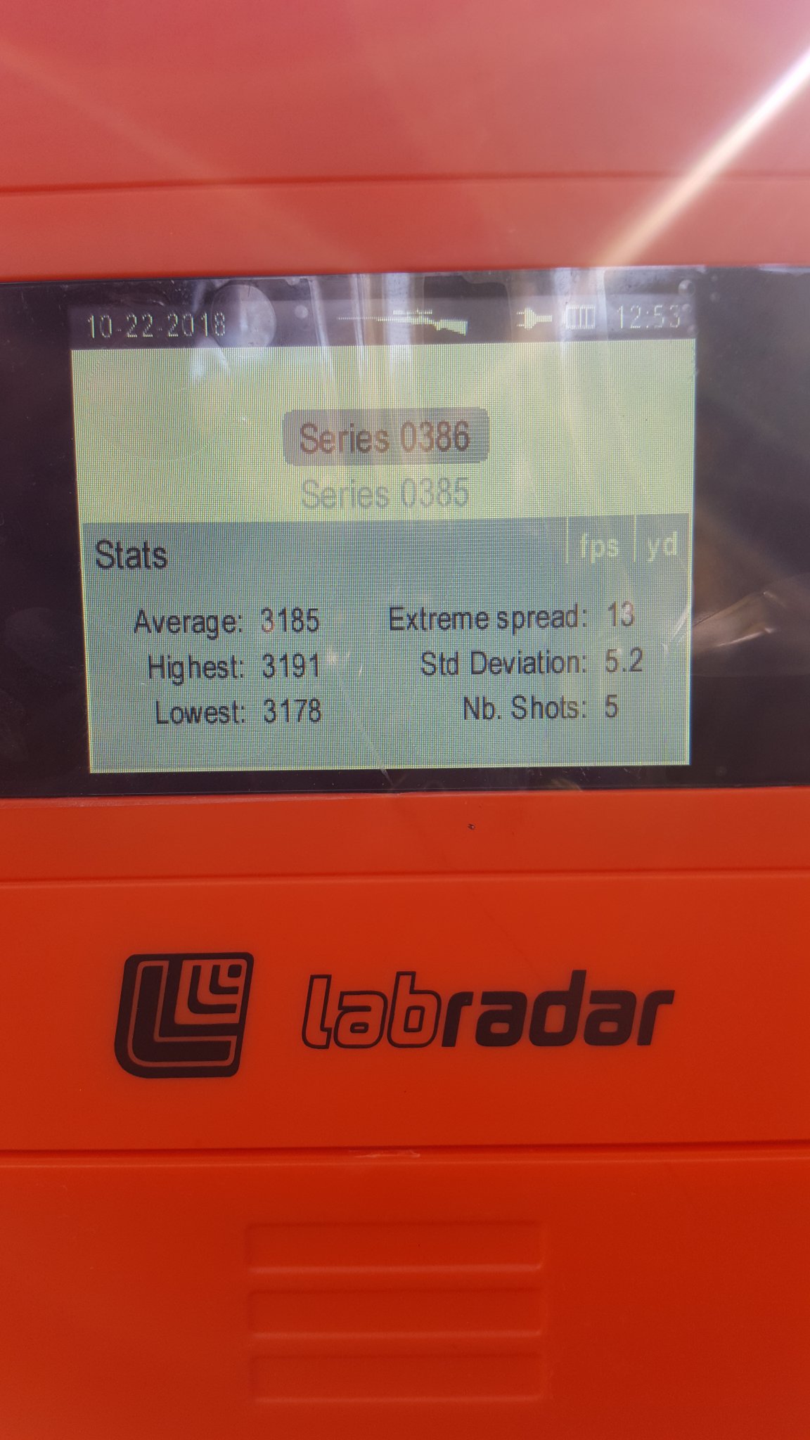

So I bought some of these out of curiosity. I just guessimated around my 130gr Hybrid load and started with touching the lands. Warning* Don't assume that these loads are safe for your rifle.
Pressure test:
45grs at around 3100fps showed a lot of promise but I didn't get any pressure signs from any of the loads. So I came back out the next day with just 5 shots of 46.5grs and got this result:
I was pretty damn happy with that but wondered if it was a fluke. So I loaded up 3 more rounds of the same and came out the next day and shot this:
Needless to say they seem to be very accurate. Especially when you notice that during the pressure test that the POI of 44.5-46grs would make around 1" group. I'm impressed so far.

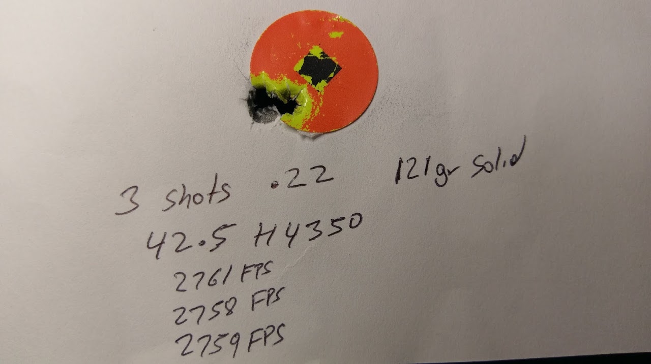

So bought some of the 121s loaded 3 with 42.5 H4350.
They do show promise, although spotting hits at distance may be tough.
Pressure test:
View attachment 6960622View attachment 6960623
View attachment 6960632View attachment 6960628
