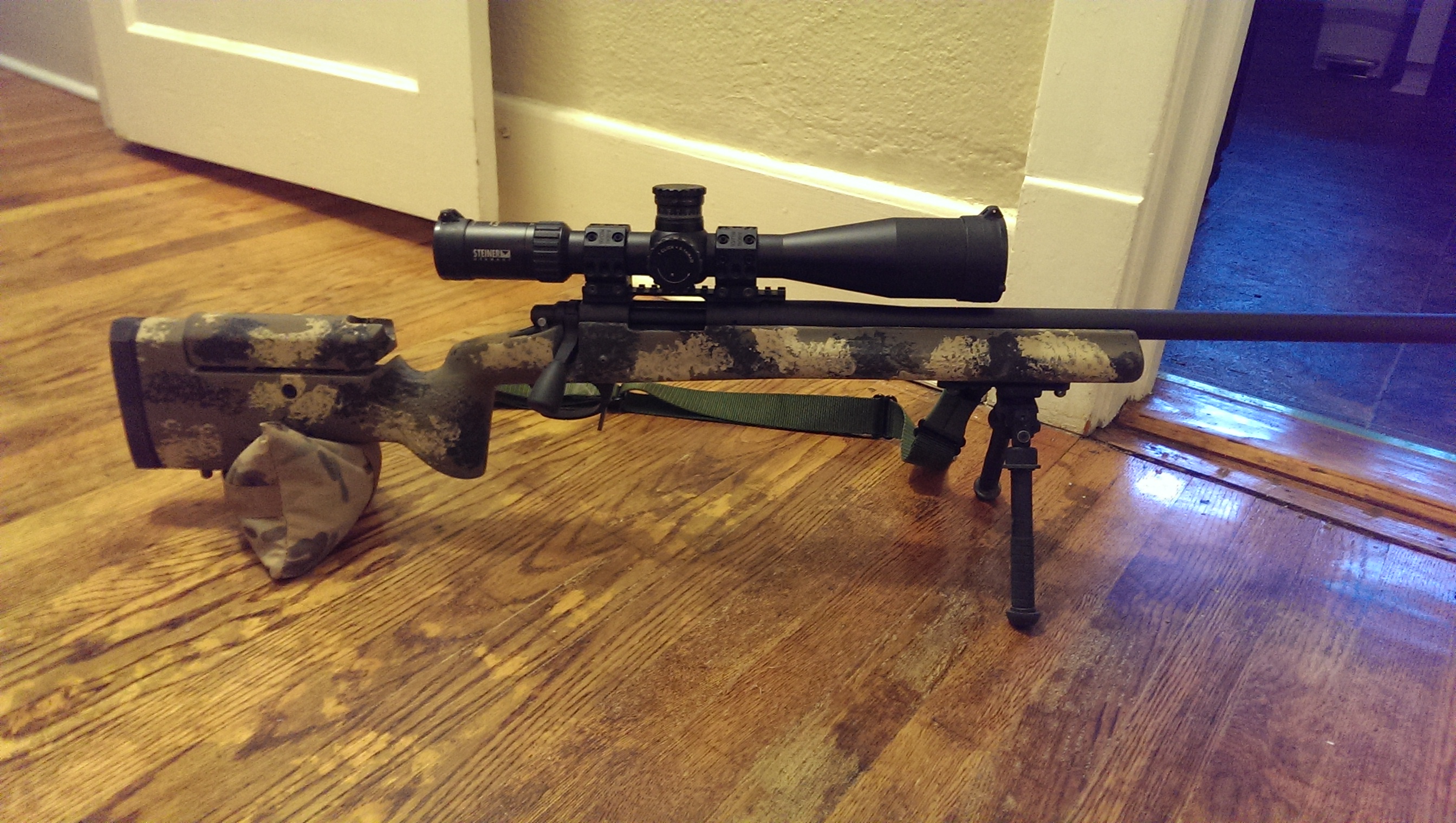

Only thing I would change is trim the barrel down to the 24-26" range and thread it with a contoured badger thruster. Everything I have read is that 24-26" is the sweet spot for the creedmoors. I am having mine done to that length. Go ahead and get the barrel threaded in case you want to get a can later on and while the rifle will not kick much already, the brake will help you spot your shots easier. If you plan on shooting F class with it, no brake. As for the stock, they are such a personal feel kind of thing. That said, my preference is a manners T4a. Here is my latest build. It is on a rem 700 and a 6 creedmoor though. I am very happy with the results. Very well balanced, minimal recoil, and if I miss, it is my fault.
