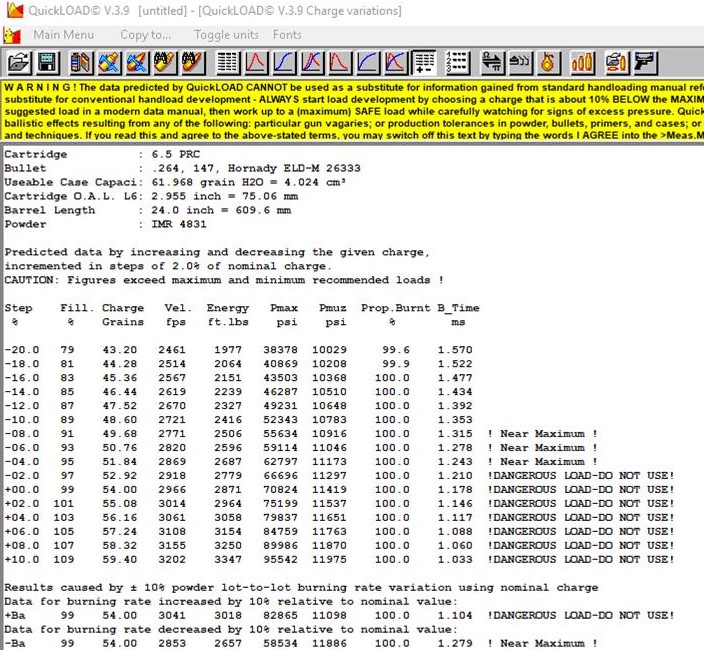

OK, here some numbers to help you with your 147 ELS for your 6.5 PRC using IMR-4831(this assumes a case volume of a fired case at 68.6 gr H2O that my Lapua cases have trimmed to 2.020" ):

I'm not sure what I'm looking at there? but I do appreciate the info. I found this on the Hornaday site?
I could live with the 2950 for a start? at least till I figured things out. Sound OK?
Hornady highlights 2950 in red because that is their tested max. IMR4831 is generally too fast for 147ELDM. You're welcome to start at 2950 but that is a max charge and likely unsafe. The QL data above says 2869fps is over 62kpsi. As I said above, 4831 is better suited to 130gr and lighter bullets.

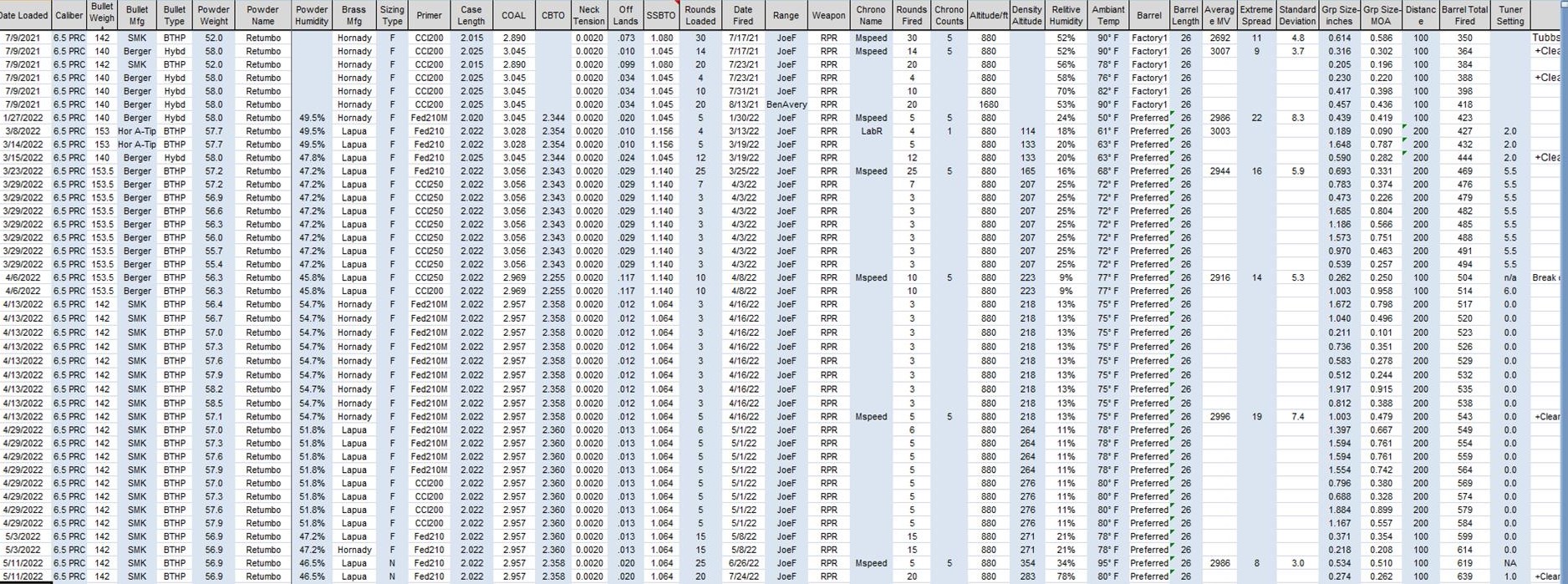

I've been using Retumbo in my 6.5 PRC for everything from 140's to 153.5's and it has worked really well (includes 142 SMK's, and Hornady 153 A-Tips, but not 147's).

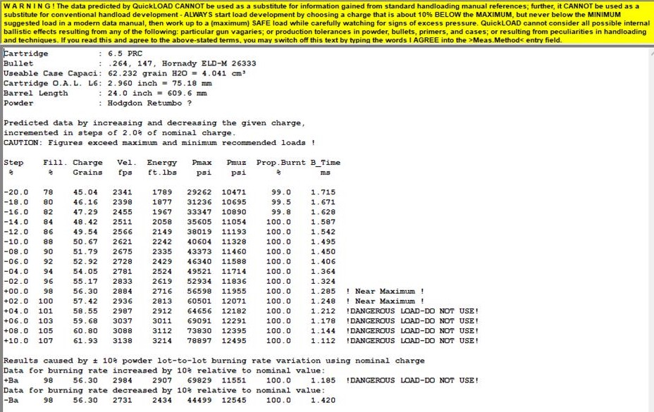

I would load 56.3gr Retumbo. But, here's some numbers for Retumbo you might find helpful:

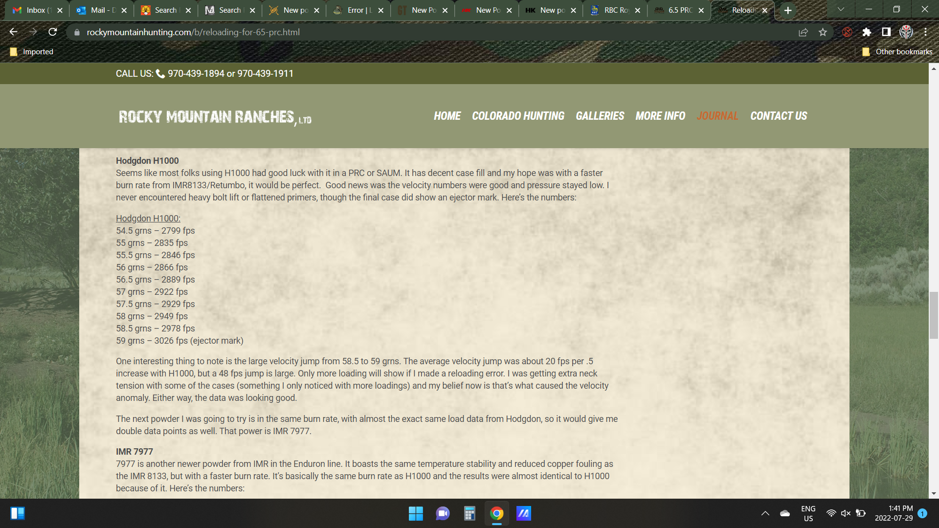

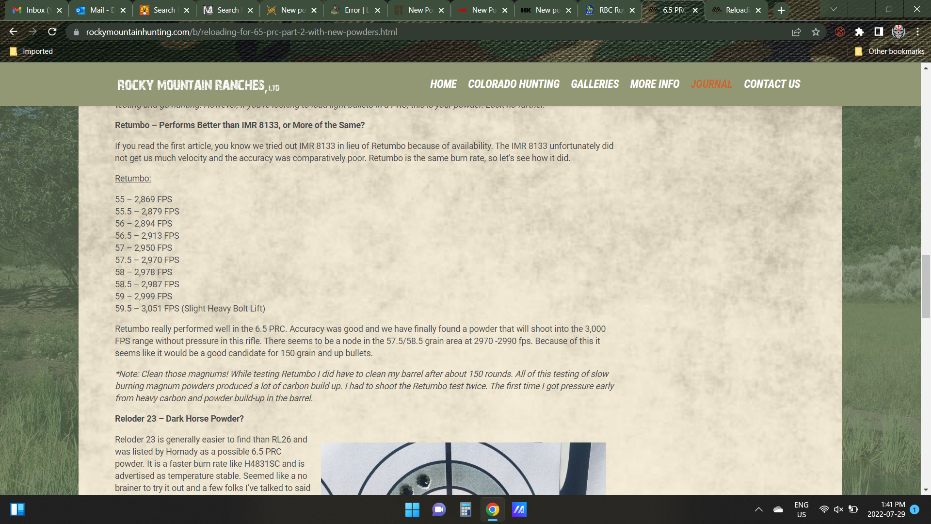

Just curious for the H1000 and Retumbo users? how do these #'s look? I pulled this from an internet review?
