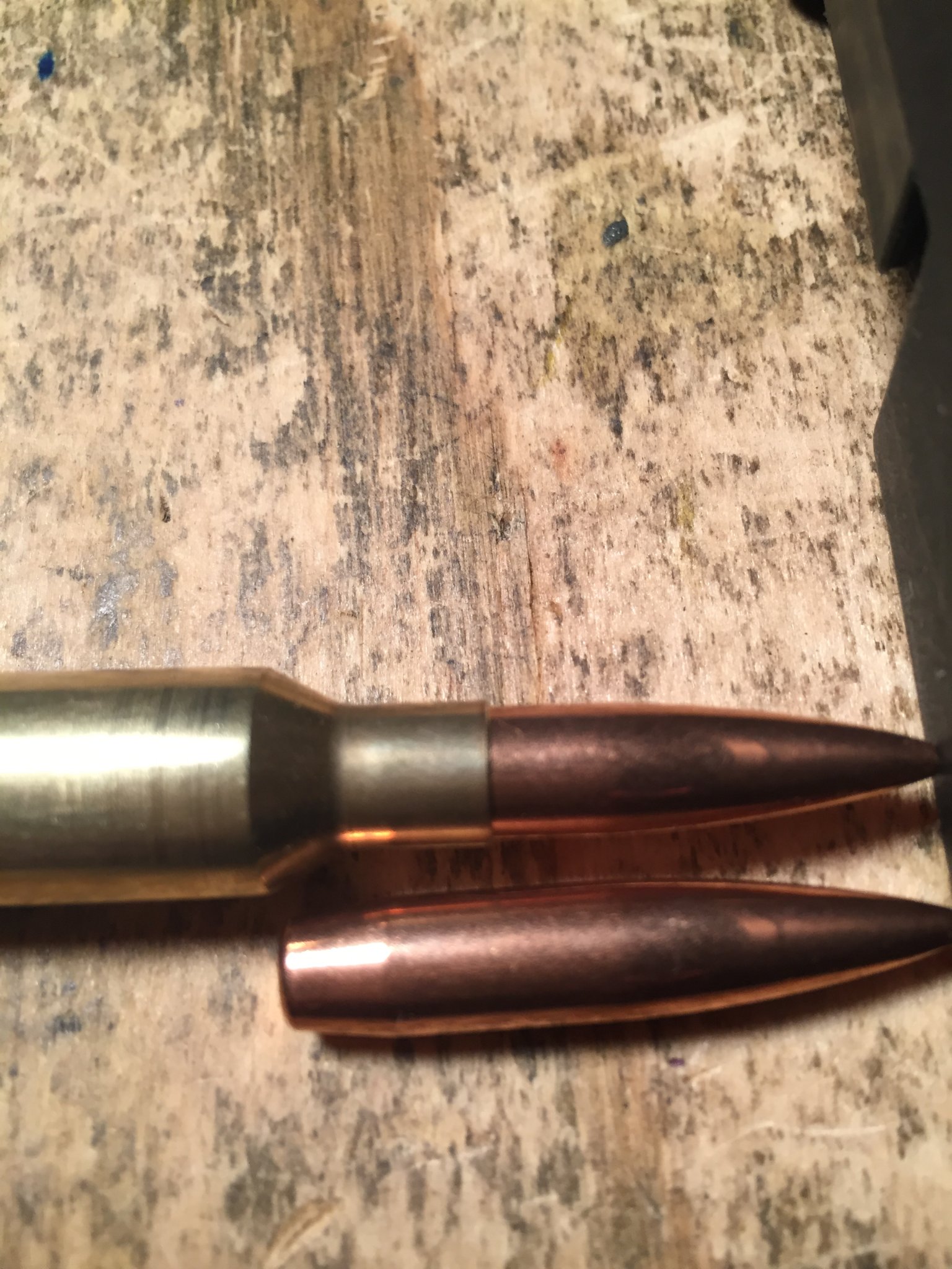

This is a 123g lapua seated .010 off the lands with .167 freebore...

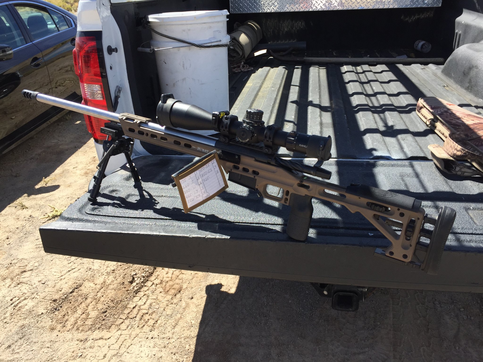

Can you share your 47 specs? Playing the which 65 to choose and was looking at the 123-130s. Thanks.
8 twist 26" hawkhill heavy palma
area 419 brake
curtius custom axiom
bix n andy 2 stage tac sport
MPA comp chassis
varget with a fed 205M and what ever bullet you want to shoot but the 123Ls are pretty impressive at 3025 and i can get another 50-100fps if i wanted to lean on them.

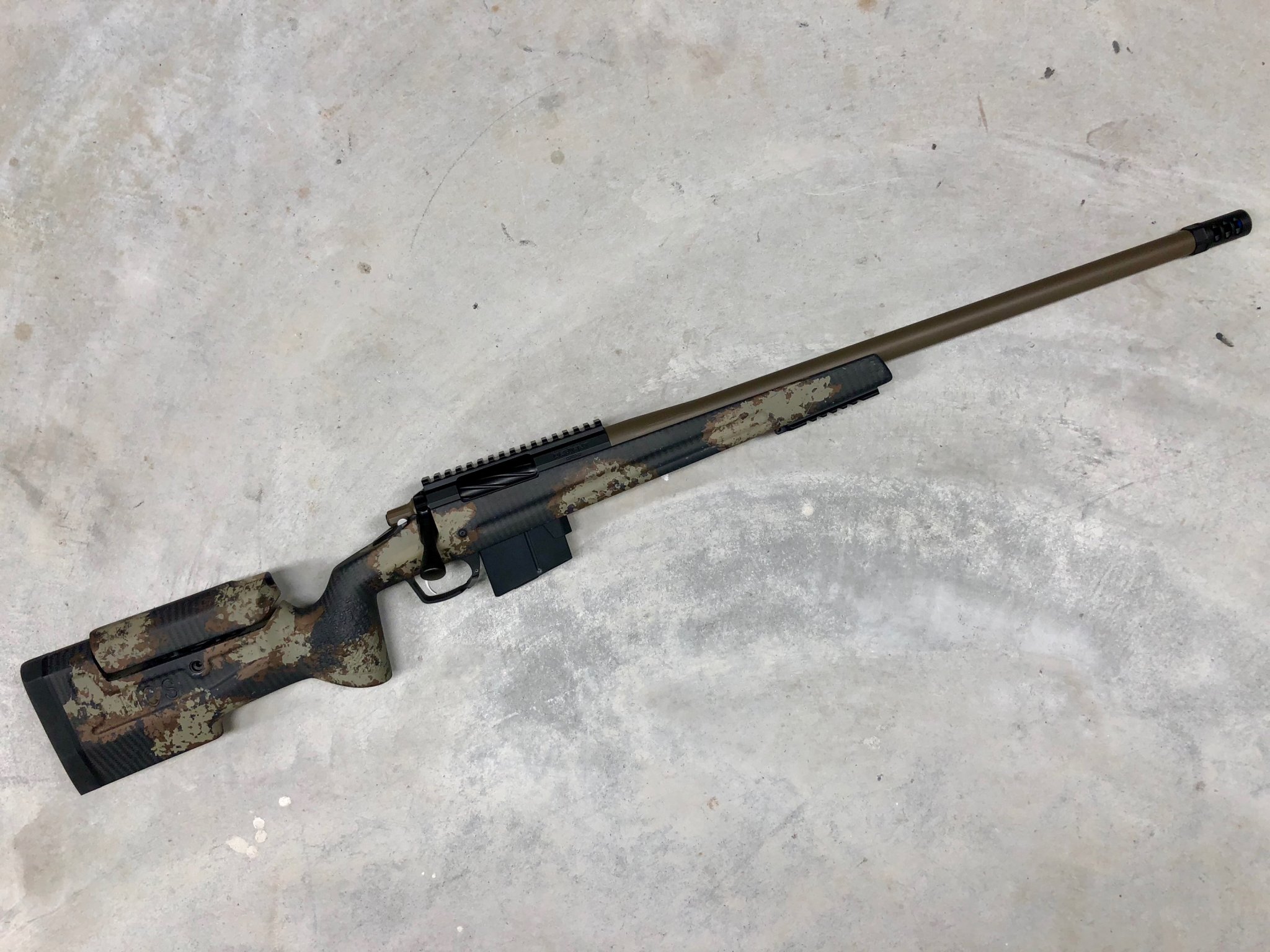

Well moving forward with 6.5x47 build. Just ordered my reamer from Pacific tool and gauge will take 6 - 8 weeks to get it. Talked with gentleman by the name of Pete, recommend 127fb since I will only be running bullets 123 - 130. Did not go longer on the free bore do to only going to shoot the range of bullets specified. This rifle is not built to do matches, I use my 260 Rem for that. So there is no need to shoot premium longer bullets like Burger bullets .
When all said and done this rifle will be:
Defiance Deviant med action :
Left bolt right port( custom) :
Bartlien barrel 26", 5R, 1:8 twist , with custom break :
Manners tactical stock MCS-TA:
Nightforce atacr 5-25×56 sf , 6 hole tactical NF rings:
Atlas bipod with cant, quick detach
hiker i would recommend you go with the .167 FB reamer from grizzle...its a PTG reamer but cheaper and no waiting...ill post a pic of a 123g lapua next to a loaded round that is ,010 off the lands with the .167 grizzly reamer.....
Actually after just doing some measuring I’m right at .050 above the neck/shoulder so .123 is going to put you right at the N/S junction so .135-.140 would probably be about perfect for the 123s
