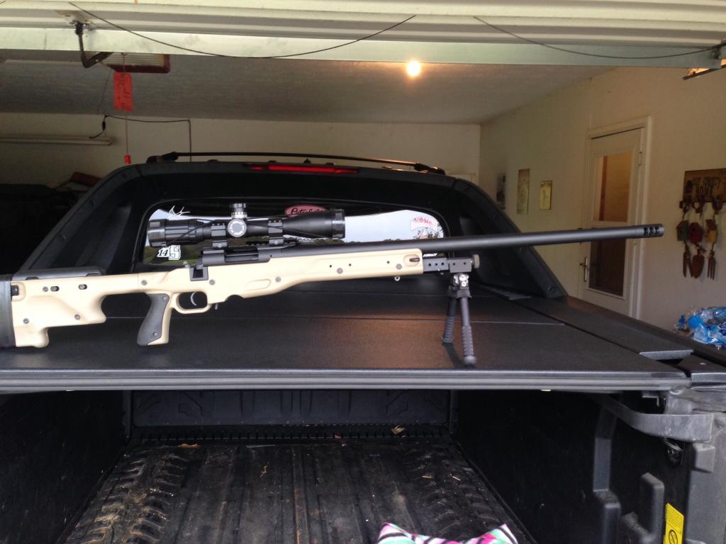

BAT VR PIC 28" Bartlein MTU 720 G-Hog

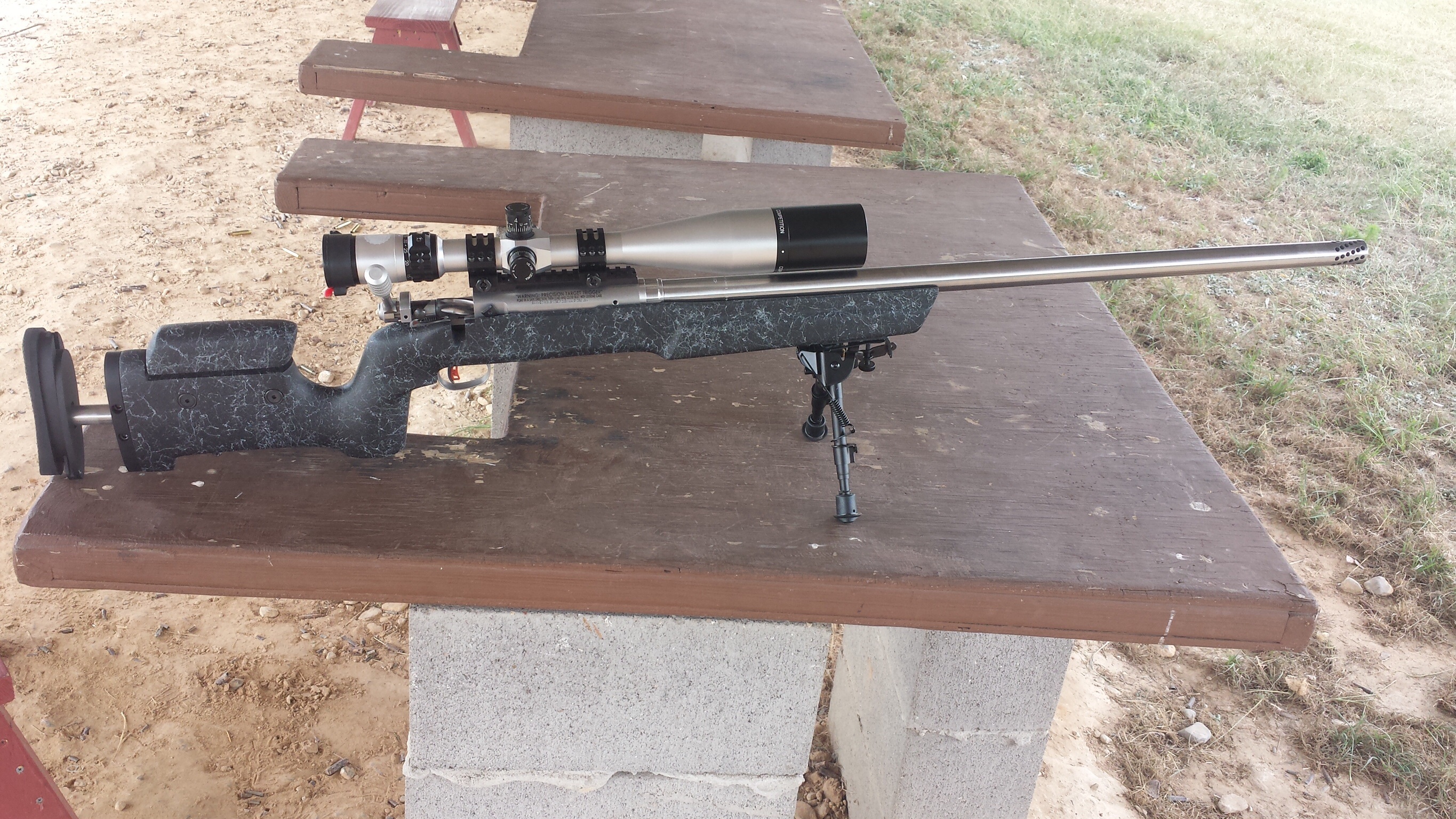

Jon just recently chamber this 6.5x47 for me. Bighorn action/Mark Chanlynn medium palma 24" barrel. Finish load work up on it today. 37.3 Varget/140 Hybrids jumped .010/CCI450's shooting very well. Also tried 4350, little more velocity but not the accuracy. Two friends also shoot Beanland built 6.5x47's 22" and 24" barrels, both also shoot very well with Varget/140 Hybrids.
Shooting it next weekend at a local steel match. Been shooting 6x47's (Jon also chambered), went to a 6.5 for longer barrel life. Will be fun to see how I do with it next weekend compared to the 6x47's.

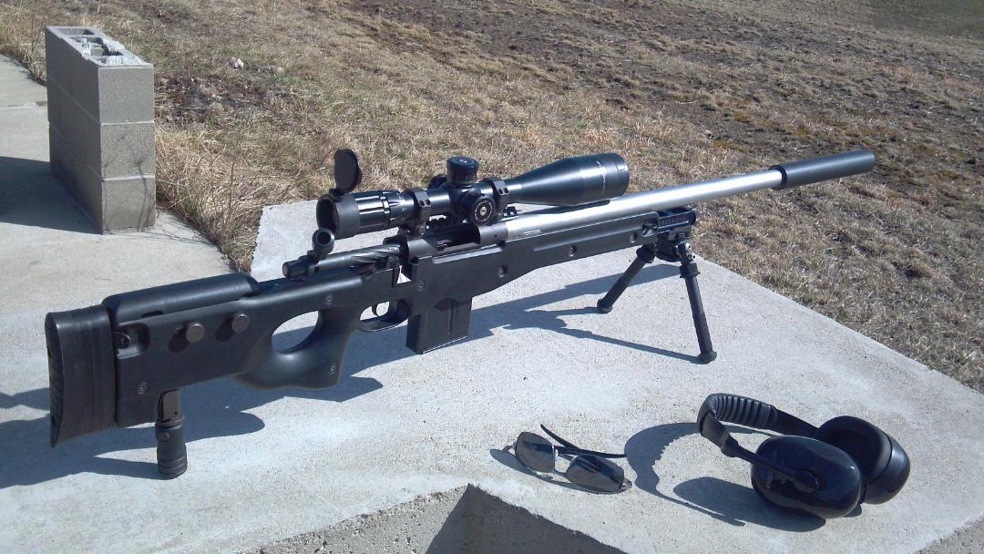

This is mine that Jon built. It runs with a can all the time now and has a Premier in place of the NF. Loves 140 hybrids jumped and 40ish grs h4350. Mine hammers and I'm sure yours will to!

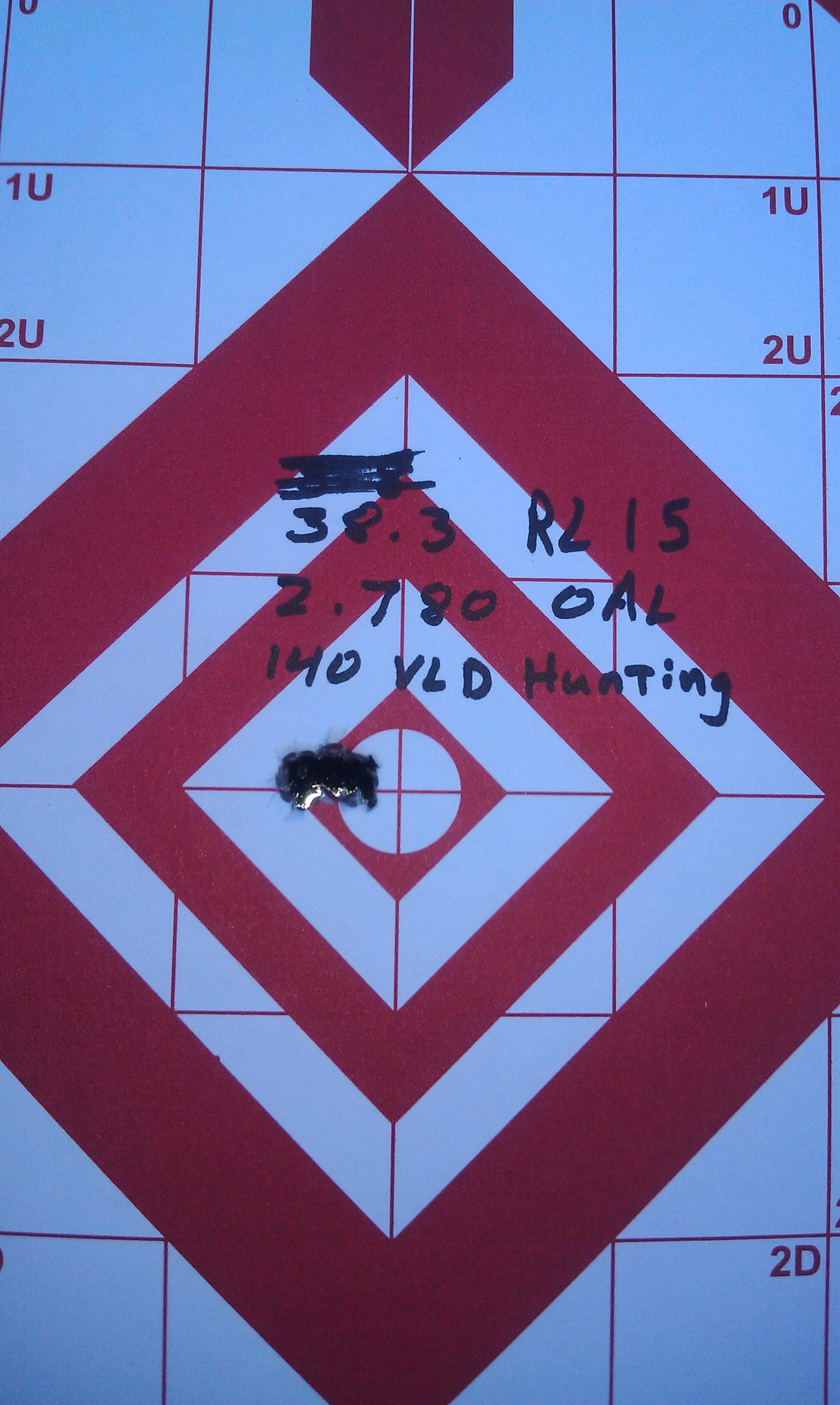

Chad Dixon spin one up for me. M7 action, Mullerworks tube. It's a hunting rifle, #4 contour. Talley LWs holding onto a VX2 CDS...
It will toss the 130 AB at 2850 with a stout dose of RL-17. And they print pretty well. I will be field testing on some deer this fall.
You need a beautiful wood stock for that rifle! Very nice groups.

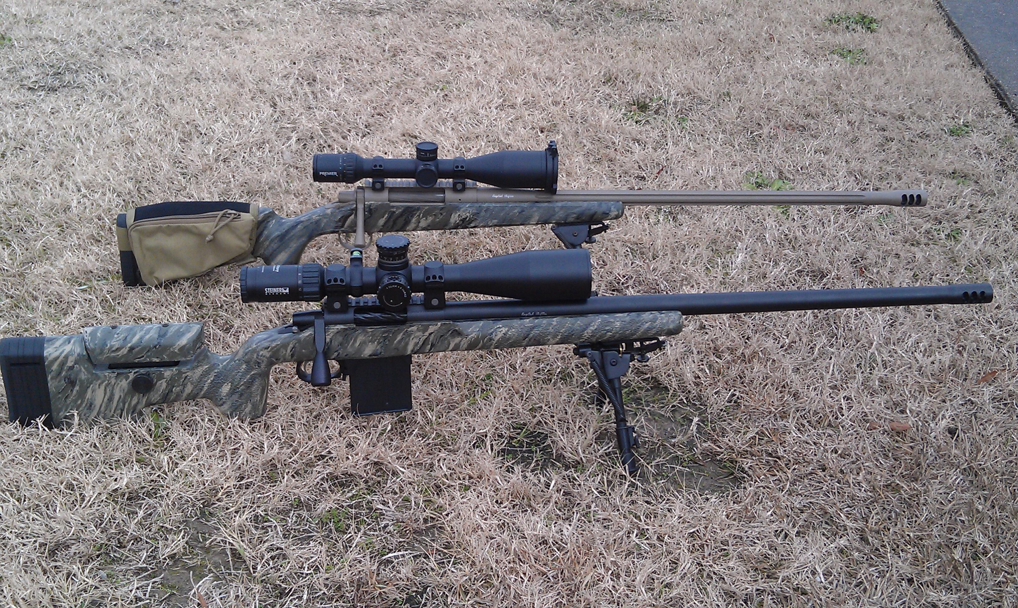

Both rifles were built by Dana English, who I highly suggest. The rifle in the front is the 6.5x47. For whatever reason, I haven't used the 140 VLD's since shooting this group almost a year ago. It is very friendly caliber to reloaders. I know Robert Gradous is very high on it as well. I now shoot it suppressed with a Thunderbeast 30BA and it is as quiet as my AR suppressed.
