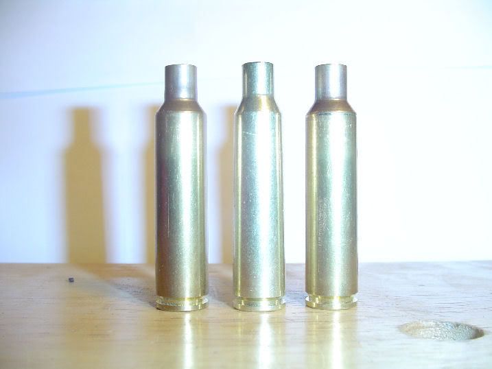

6.5x55 in the middle, 6.5 AI on either side
