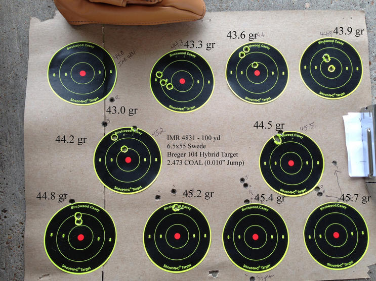

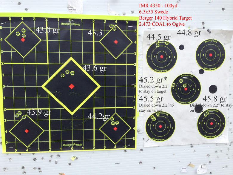

I tried two powders: IMR 4831 and IMR 4350. I had a little better luck with the 4350...

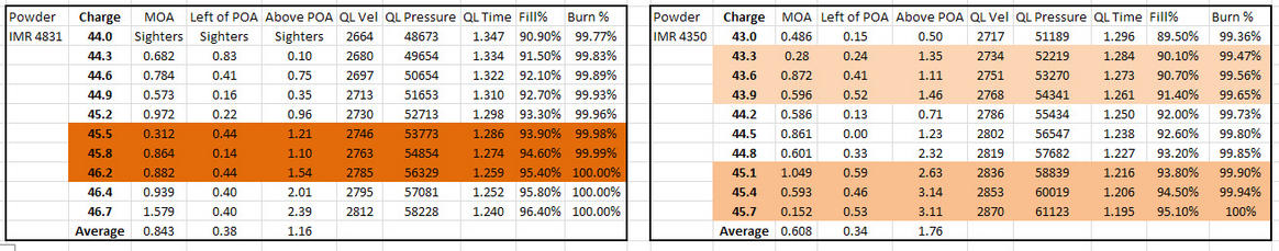

I added some calculations from QuickLoad in there for comparison, and highlighted where I thought the nodes might be. I saw not signs of pressure, so I may work it up a bit hotter to see where it goes. What do y'all think about the nodes I highlighted? I guess my next steps are to fine tune the powder charge a bit more and play with seating depths. What have others used for hybrids? 0.020" + jump?
Interesting that the barrel times almost match for the node 45.8gr 4381 and 43.6gr 4350... maybe gives some credence to the optimal barrel timing concept.
