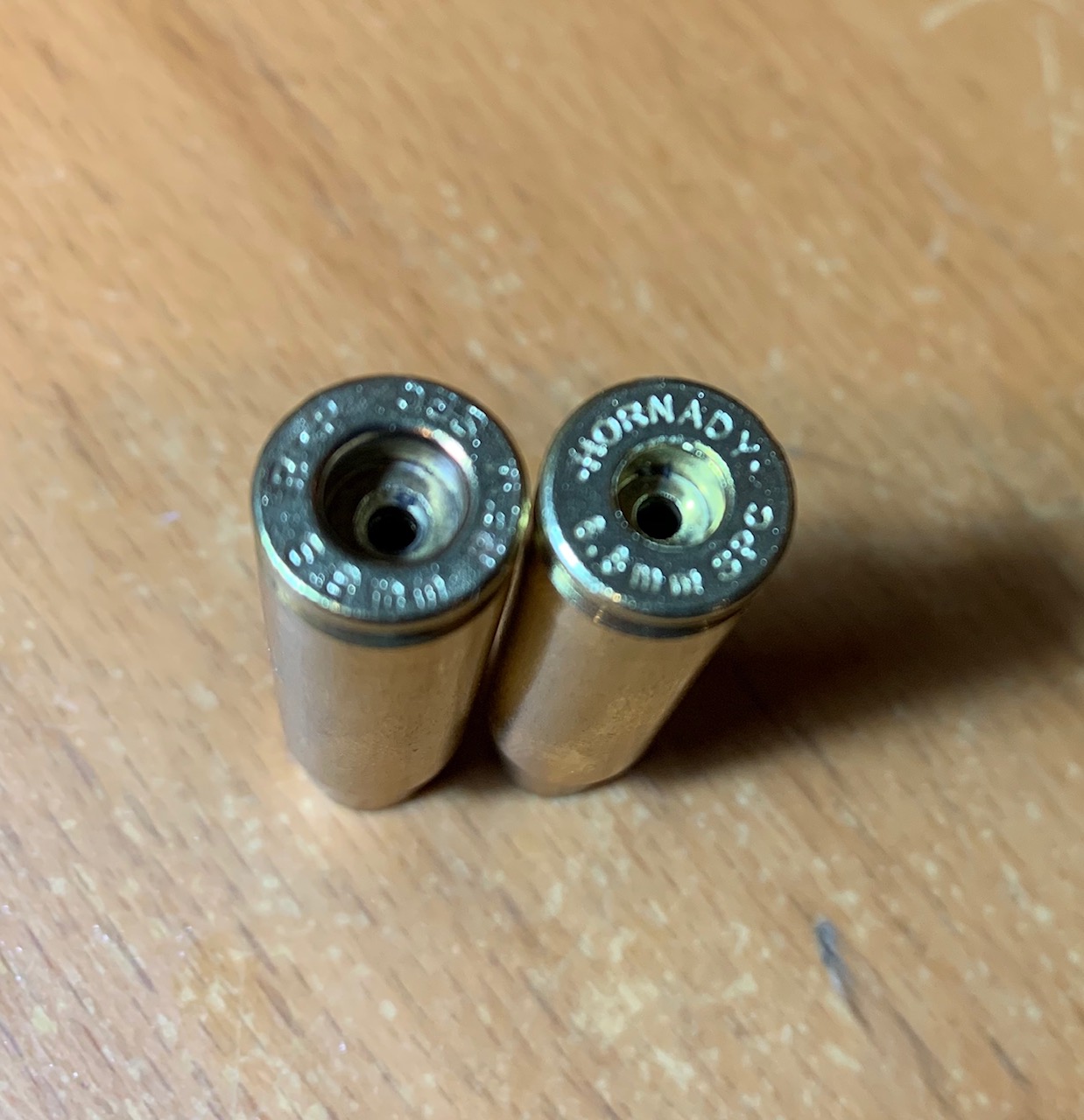

If you start loading the 6.8, know there is a lot of difference in brass. Hornady made brass and Hornady had brass made by S&B. The S&B has a larger capacity. CBB normally sold S&B new primed brass but it is sold out with possible expected delivery sometime next year. If you look on 68 Forums people say they are loading to higher that published max with A2200 & 120SST's. Proceed with caution and all loading practices. If you use PRI mags you can also load to about 2.295" with SPCII.

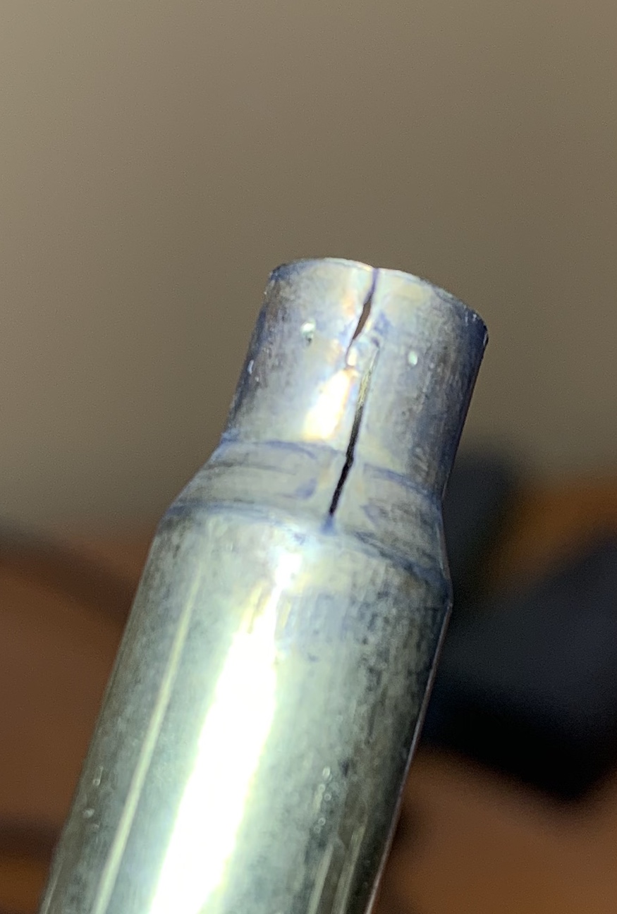

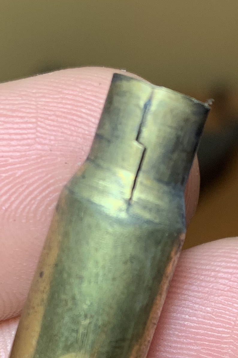

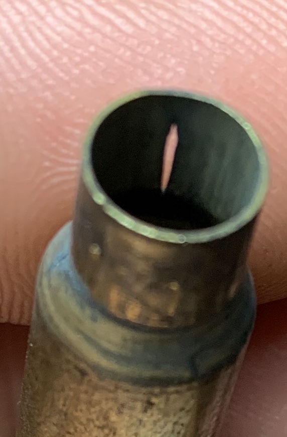

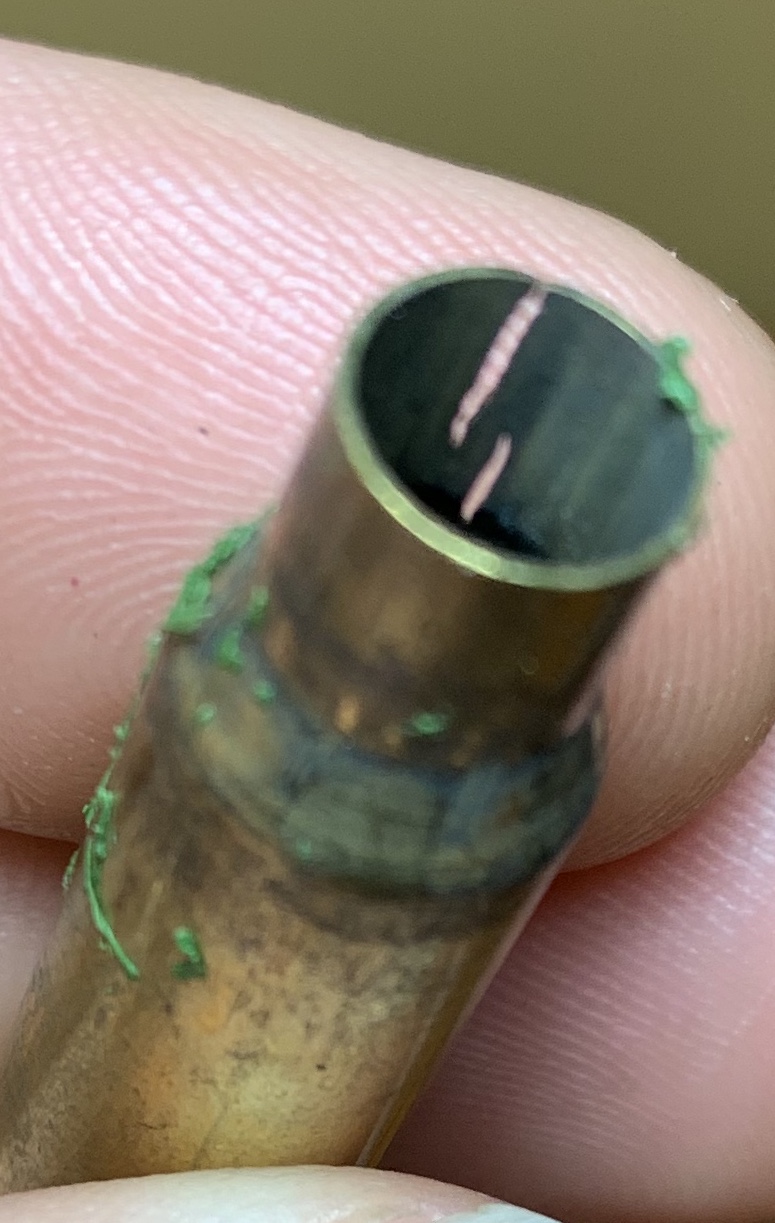

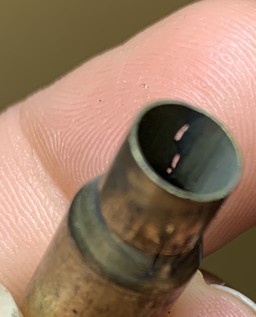

On that 68 forum everyone seems to like the SSA brass, but the examples I have are complete garbage.
Once fired factory SSA 115gr HPBT = not one single piece of brass is reloadable from the box I checked today.
This crap was fired from a Black Hole 16" 10T SPC2 chamber.
Junk brass.........all 20 had cracked necks & some had as many as 3 separate cracks
