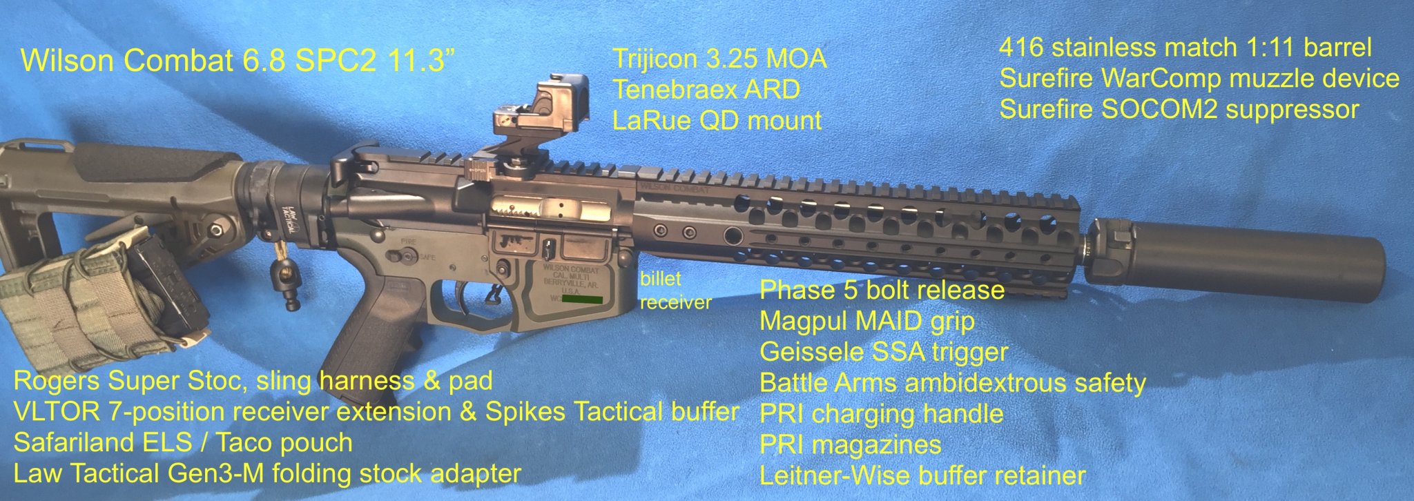

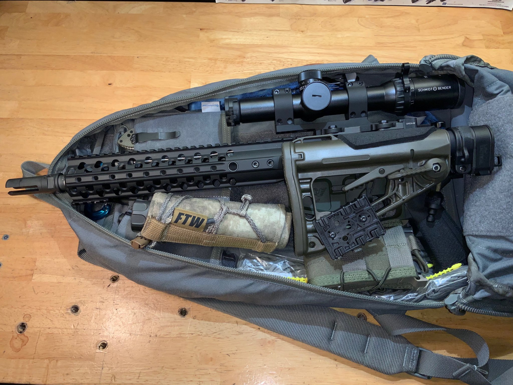

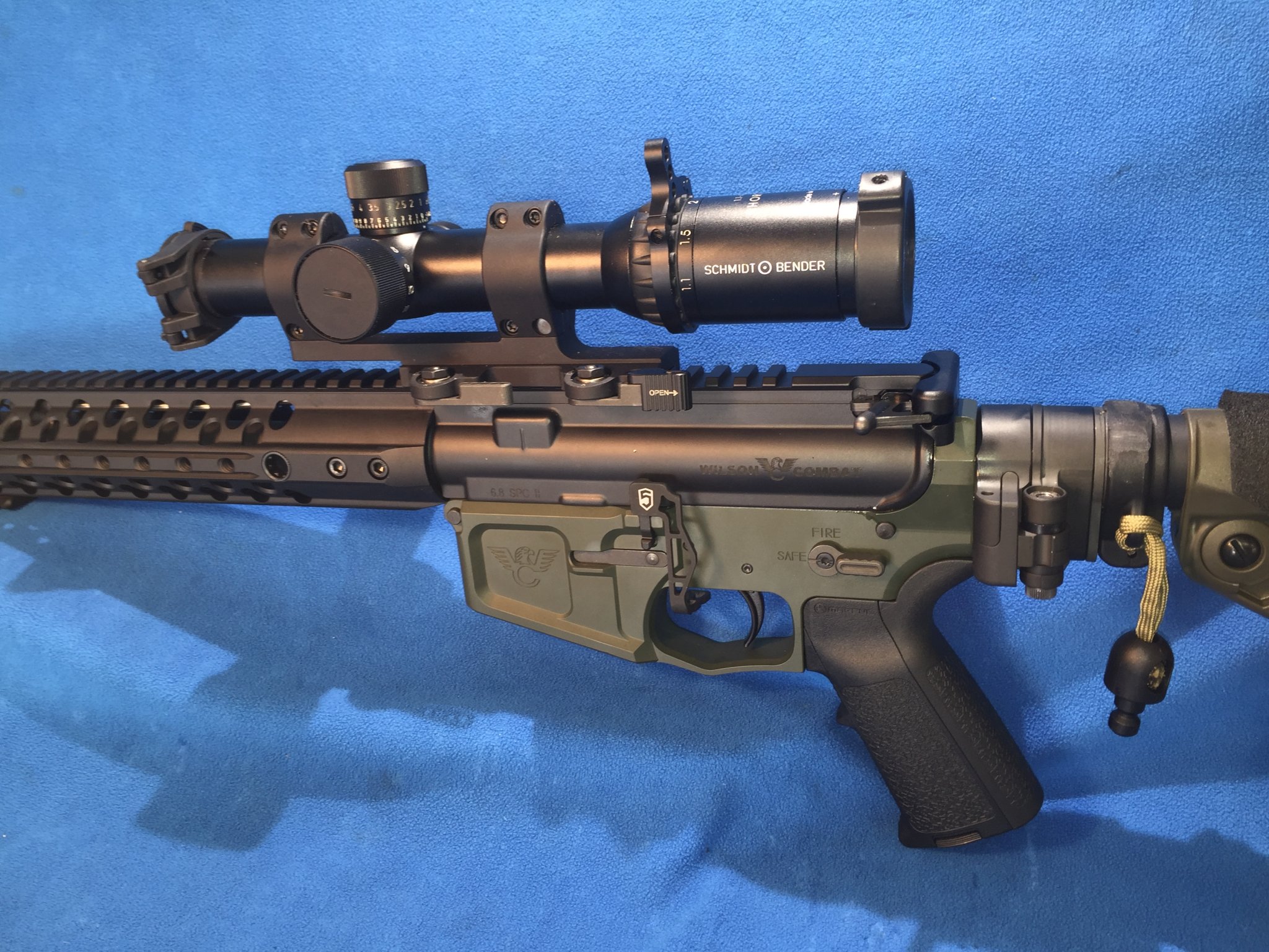

I built this WC 6.8 SBR with NP3 bolt carrier group in 2017 hoping to mount the then promised S&B dual CC 1-8 scope. Now waiting for its revised Feb 2019 arrival date. Since then have used the red dot and S&B 1-4 short dot. Mostly hog, some deer hunting. Easy to carry in small backpack.
