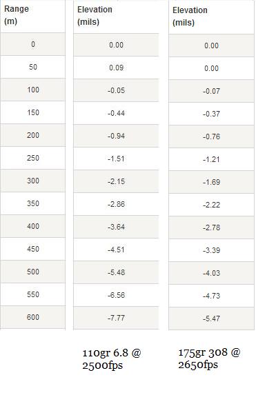

The answer is "sorta". Bryan Litz is your ballistic friend:
If you'll shoot fast 85s or 95s, I'd guess it would match a little better until you get to 400ish.
Edit: The mystery was too much. A 95gr @ 2750ish is VERY close to 300yds and less than .3 off by 400.
