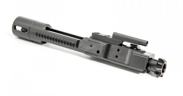

That is a carrier, do you know the difference between a bolt and a carrier?

None of your links include "adjustable bolts". Proper terminology is important when discussing technical matters.
Understood, however my take on the original question is that the OP means the group, not just a piece of it.
