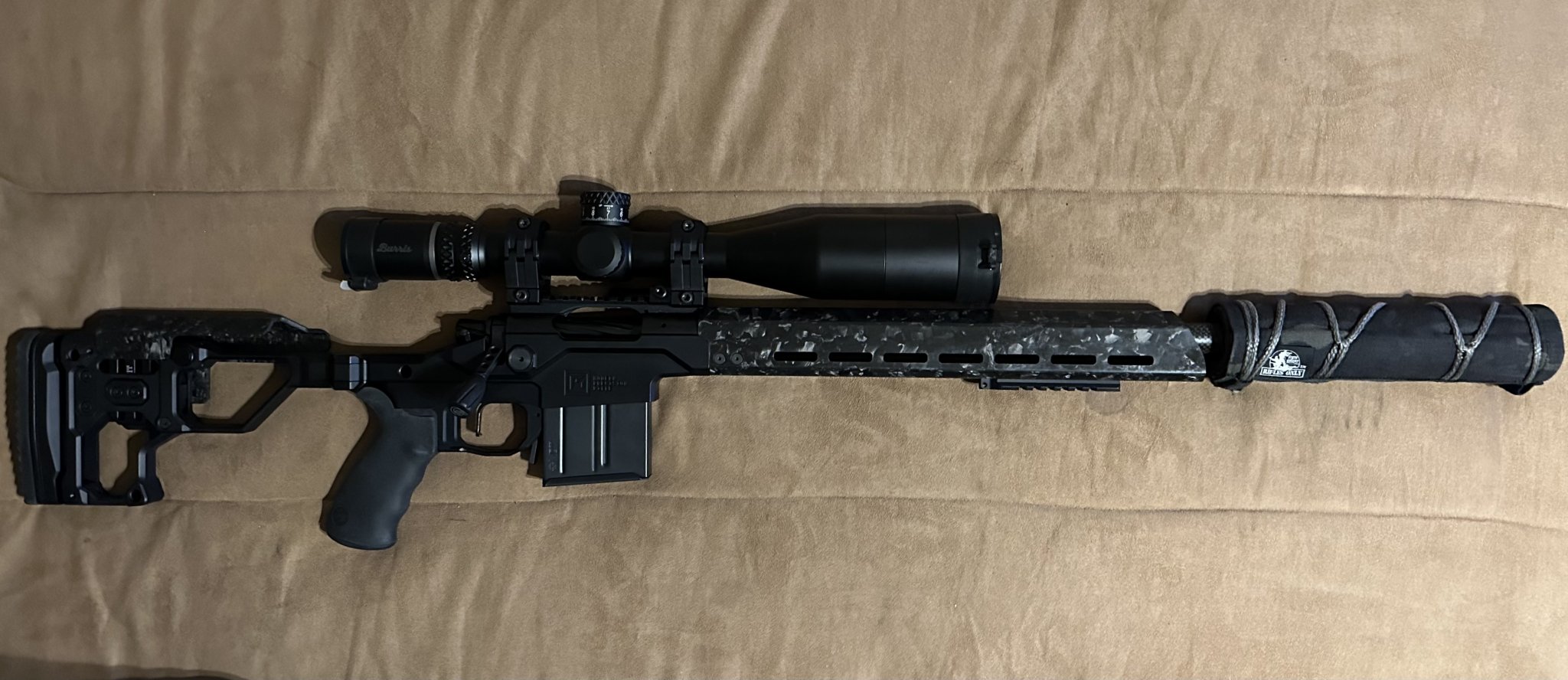

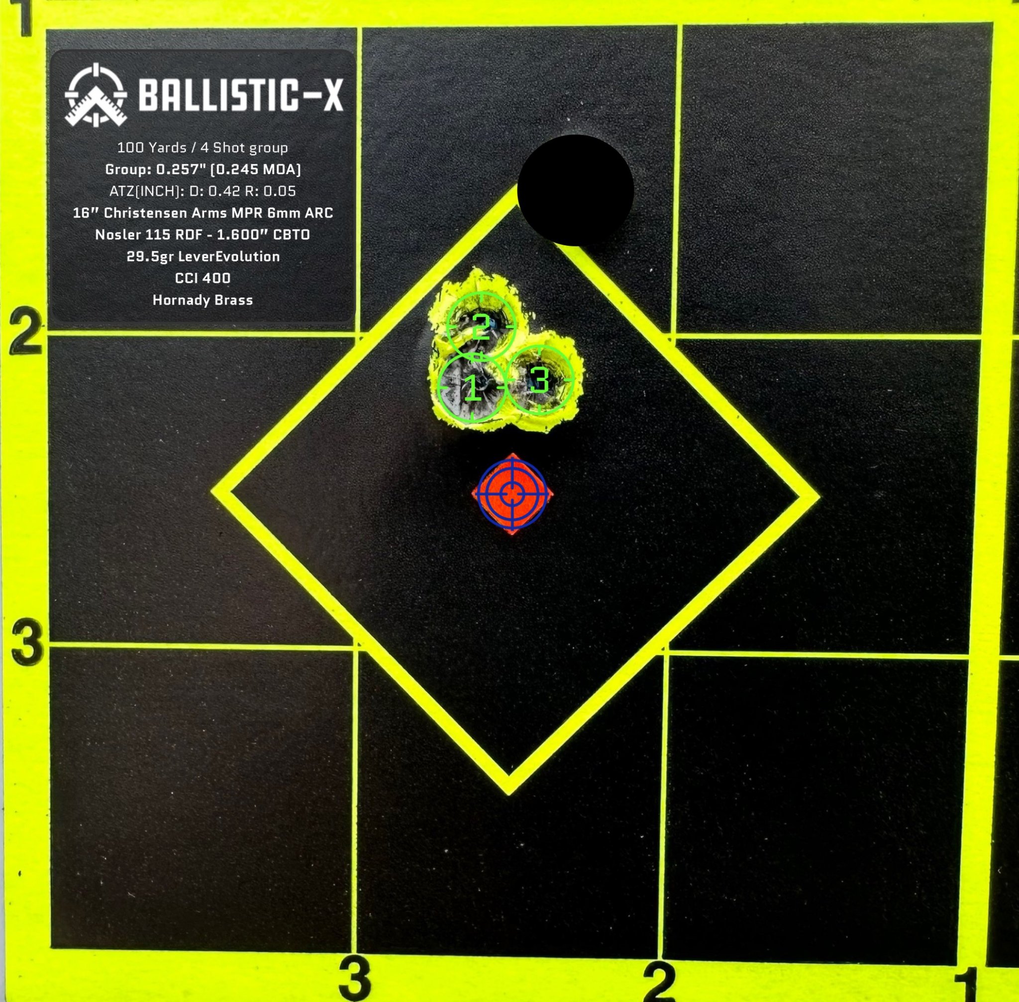

    I don't have one in an AR, but I have a 16.5" bolt-action 6mm ARC and I really like the little cartridge. I was a diehard 6.5 Grendel fan since the very beginning of its existence in the very early 2000's. But I was skeptical about the 6mm ARC because I am not a 6mm fan, but I also had no idea that companies were offering 110-115gr 6mm bullets now. Once I found that out, I figured I'd try one. I have plenty of AR's, but didn't want one in an AR because despite having a DMR rig (AR) in 6.5 Grendel, I always thought the cartridge would excel in a bolt-action platform. Then I found out that @christensenarms makes an MPR in 6mm ARC, and my local store had one in stock, so I bought it. It's really grown on me, the more I mess around with it. ZERO recoil, and flat-shooting. Not to mention the ballistics are phenomenal with the high BC of a 115gr Nosler RDF that leaves the muzzle at almost 2,600 FPS. I wouldn't have a problem shooting whitetail deer at a couple hundred yards with it.
    I handload for everything, so I'm running Nosler 115 RDF's backed by LeverEvolution powder, in Hornady brass with CCI 400 primers. Runs great for me. I'm pushing them up around 2,575 FPS MV. MUCH hotter than an AR can handle, so don't attempt to do this in an AR. There's a reason there's AR data and Bolt data separate. The AR can't handle that much pressure without a CF.

    Like these...
    Black, Brown, or Tungsten... Take your pick...
    For now it has a Burris XTR-III 5.5-30x56 SCR2 MIL, but it will soon have a thermal on it...For coyote and varmint hunting.

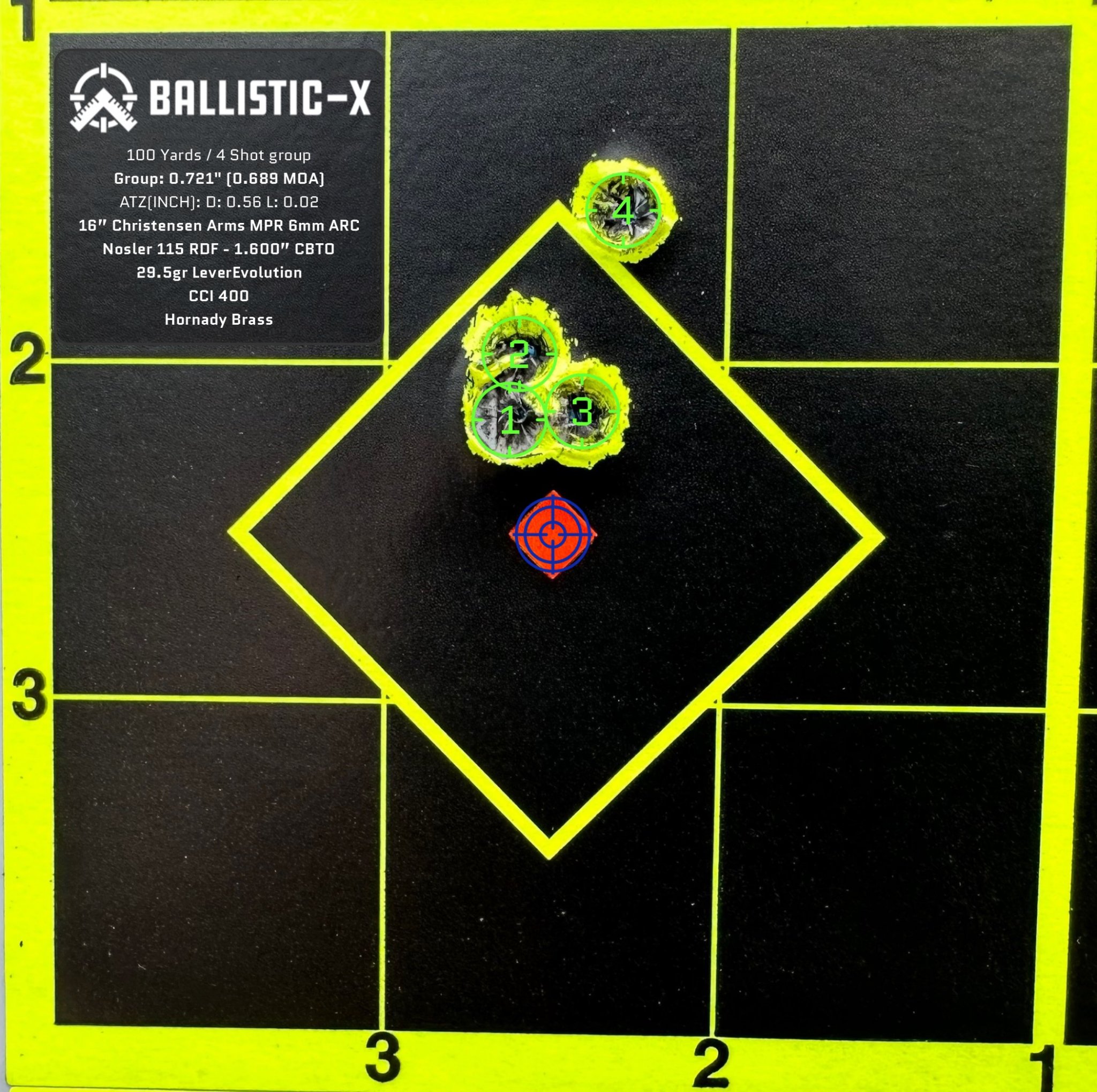

    Same group, with and without the shot I pulled (my fault, not the gun's)...
    Ballistic-X-Export-2023-08-20 20:04:01.499027.jpgBallistic-X-Export-2023-08-20 20:04:40.495123.jpeg

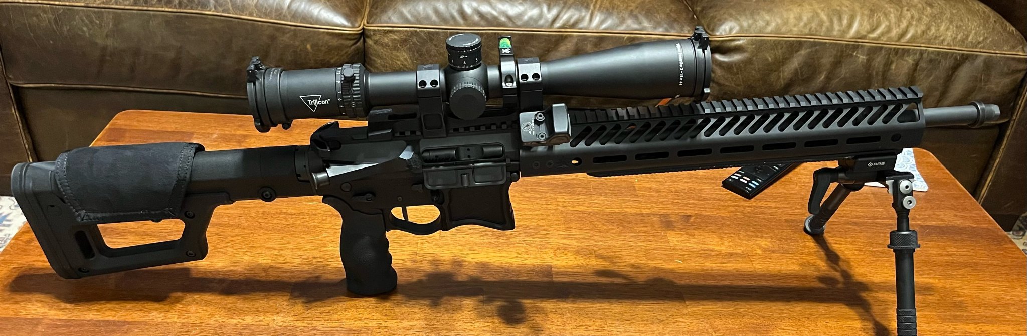

    No ragerts. Love that i replaced my 6.5G barrel with 6 arc in my AR and will upgrade that one to a proof CF.
    Next build after that will be a 6 arc bolt gun. Hopefully on an aero solus if they ever release that bolt face.

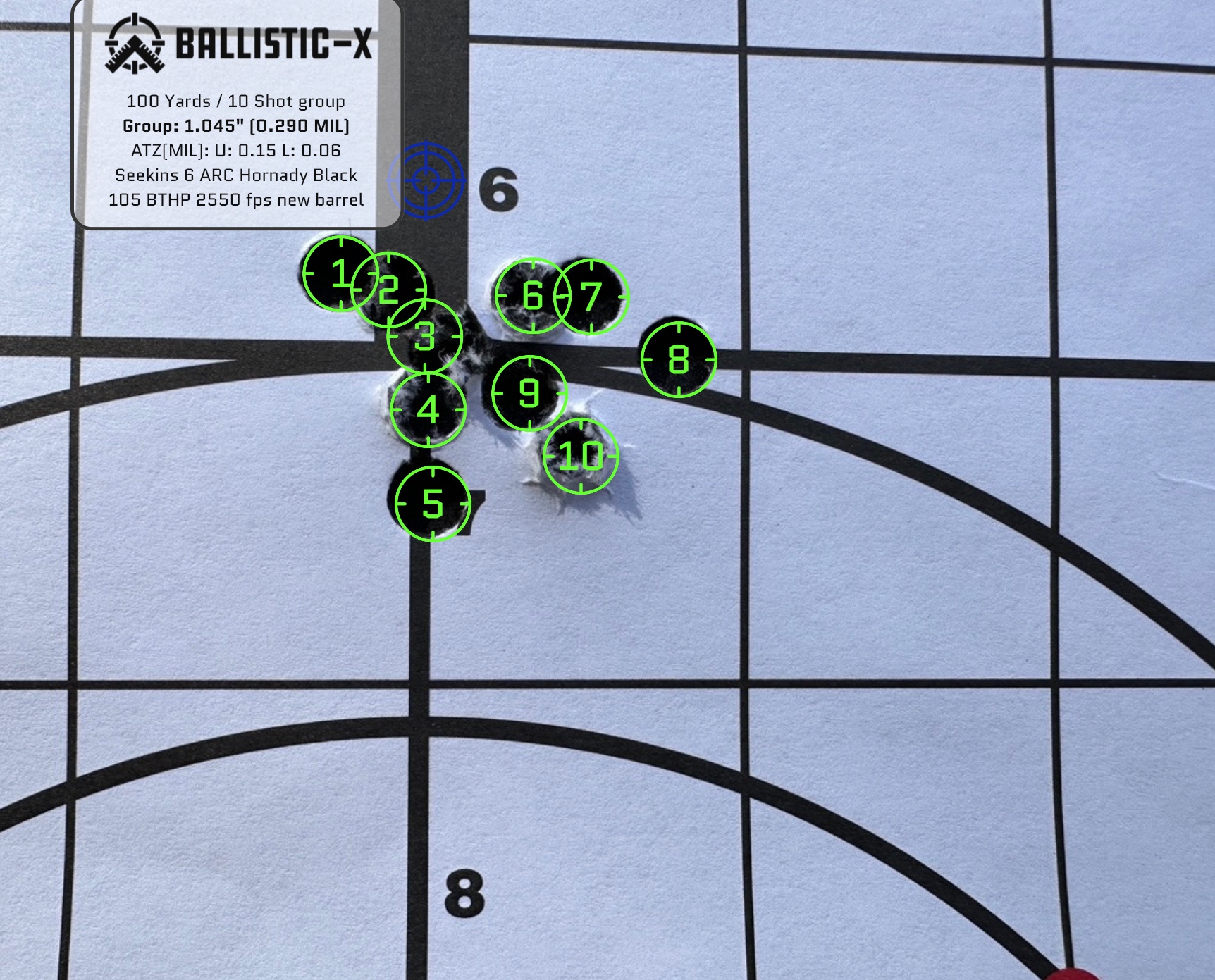

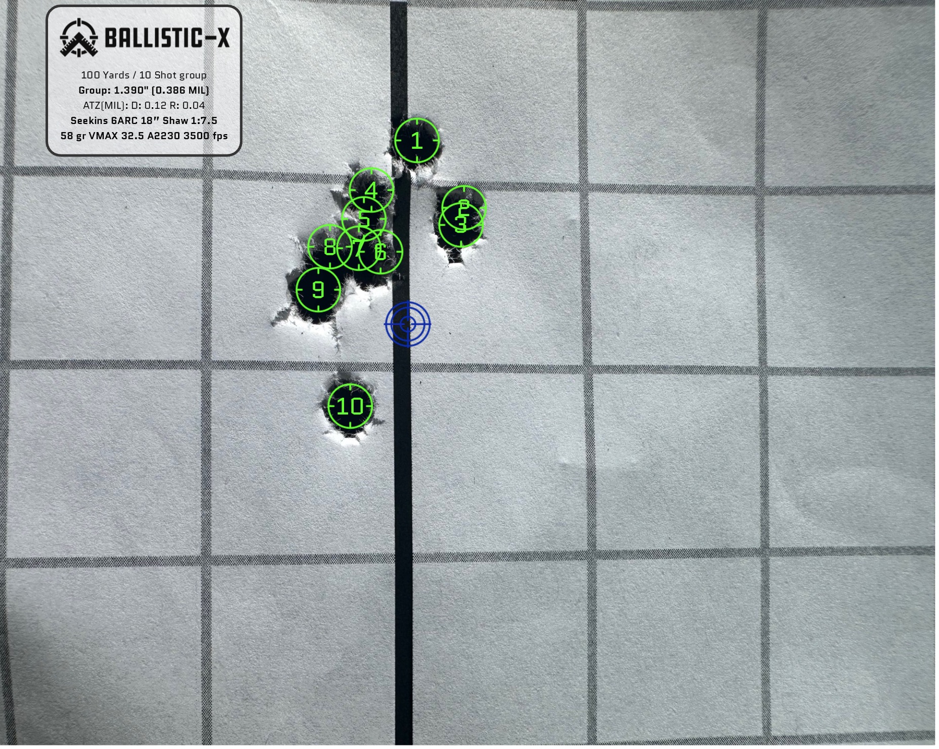

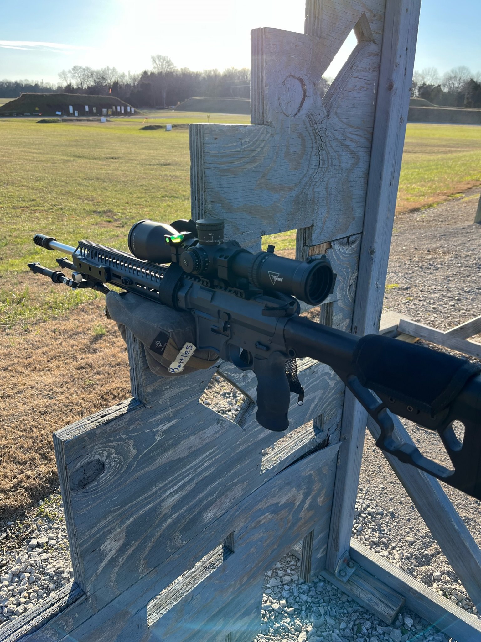

    If you are looking for a compete setup, check out the Seekins Precision DMR in 6ARC. Reasonable price and a quality build out of the box. You can buy Hornady factory ammo 103,105,108 and all shoot well. I load for it and shoot Berger 95 VLDs with Lever power. I upgraded a few things to my preference, but it doesn’t need anything. The 20 rd ASC 6.5 Grendel mags work well and allow me to load longer rounds.
    I have the same rifle from them in 18” 223 Wylde and the 6ARC is ballistically superior in an AR platform. Both are below. I have some suggestions on what I changed if you are interested.

    Seems right. I get 2670 with 29.5 LVR and Berger 108’s from my 18” Seekins gasser.
    3500 w/ 32.3 LVR and 58 gr VMAX 🤩

    I’m extremely pleased with my 6ARC AR-15. It’s pieced together using a 16” BSF barrel, SLR adjustable gas block, and JP BCG/SCS in an Aero Enhanced Upper, and ADM lower. I’m using both ASC 6ARC (Red Follower) and 6.5Grendel (blue follower) 10round, and 25 round mags at full capacity without any functional issues in 500 rounds. The rifle shoots 0.7 MOA groups with Hornady 108gr ELD-M.
    If I was starting over I definitely do the 6ARC AR-15 again. I use it much more than my 6.5Creedmoor AR-10. In fact I’d probably do the 6ARC AR-15, skip the AR-10 completely and get a bolt in 6.5PRC.
    Reactions: hseII and rlsmith1
