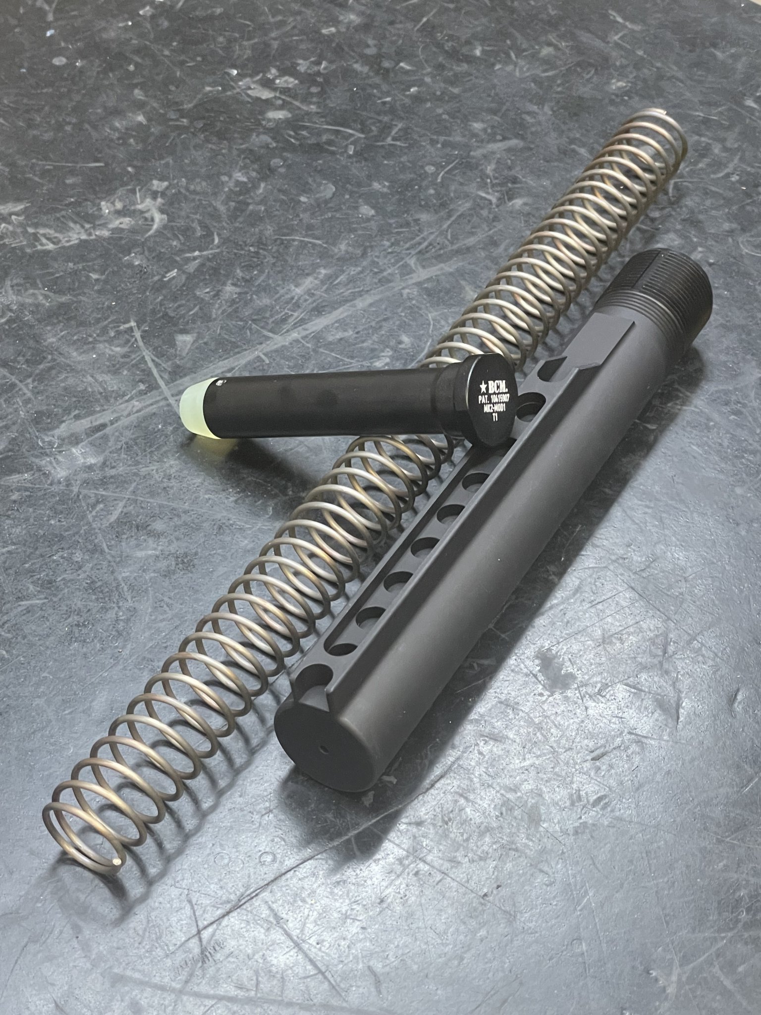

I'm not smart enough to answer this, but I know the guy who designed the Vltor A5 recoil system, or the newer, upgraded BCM MK 2 recoil system.
The big advantage of the is the plain old rifle length recoil spring. It lasts infinitely longer than a carbine length recoil spring and just plain works better.
Secondary but also advantageous are the springs on either side of the buffer weights than both reduce apparent recoil and minimize bolt bounce.
I find the H1/T1 weight buffer works well in almost everything that's not over-gassed, to include the 6mm ARC.
This. I find very little reason to use anything but the VLTOR / BCM system on any AR15 these days unless you're going rifle length.
