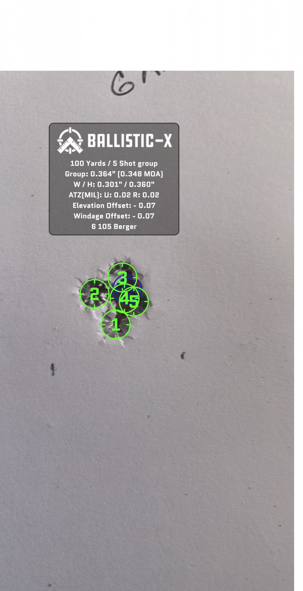

    Mine is shooting close to .300

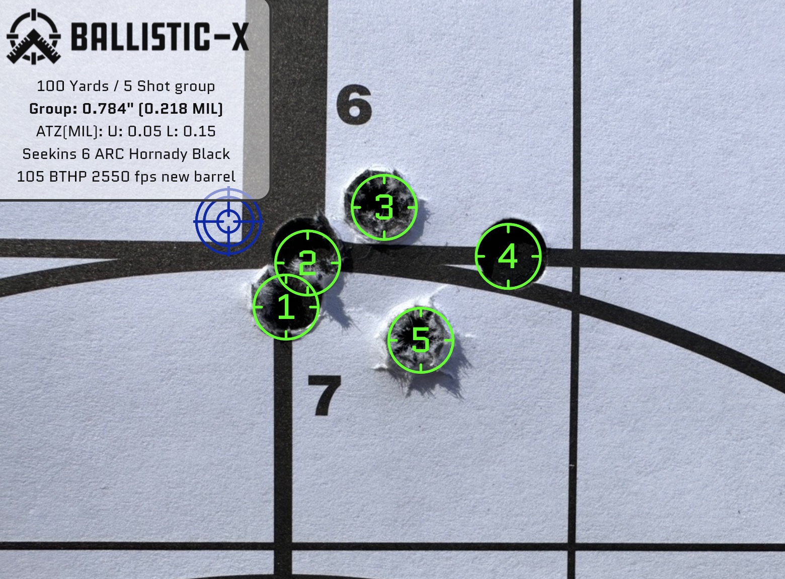

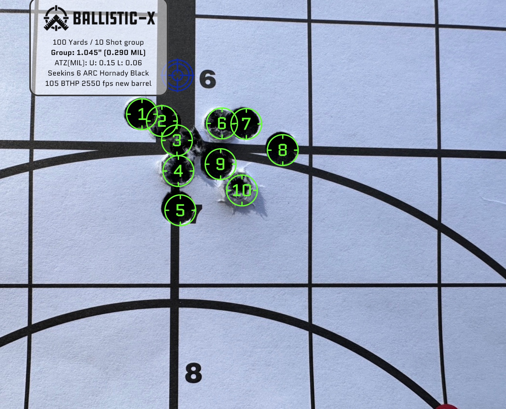

    Broke in a new barrel and it’s shooting very well with just factory ammo.
    Seekins w/ Shaw 18” SS 1:7.5
    Omega can
    Magnetospeed V3
    Hornady Black 105 BTHP
    2550 fps, SD approx 14
    Edit to add:

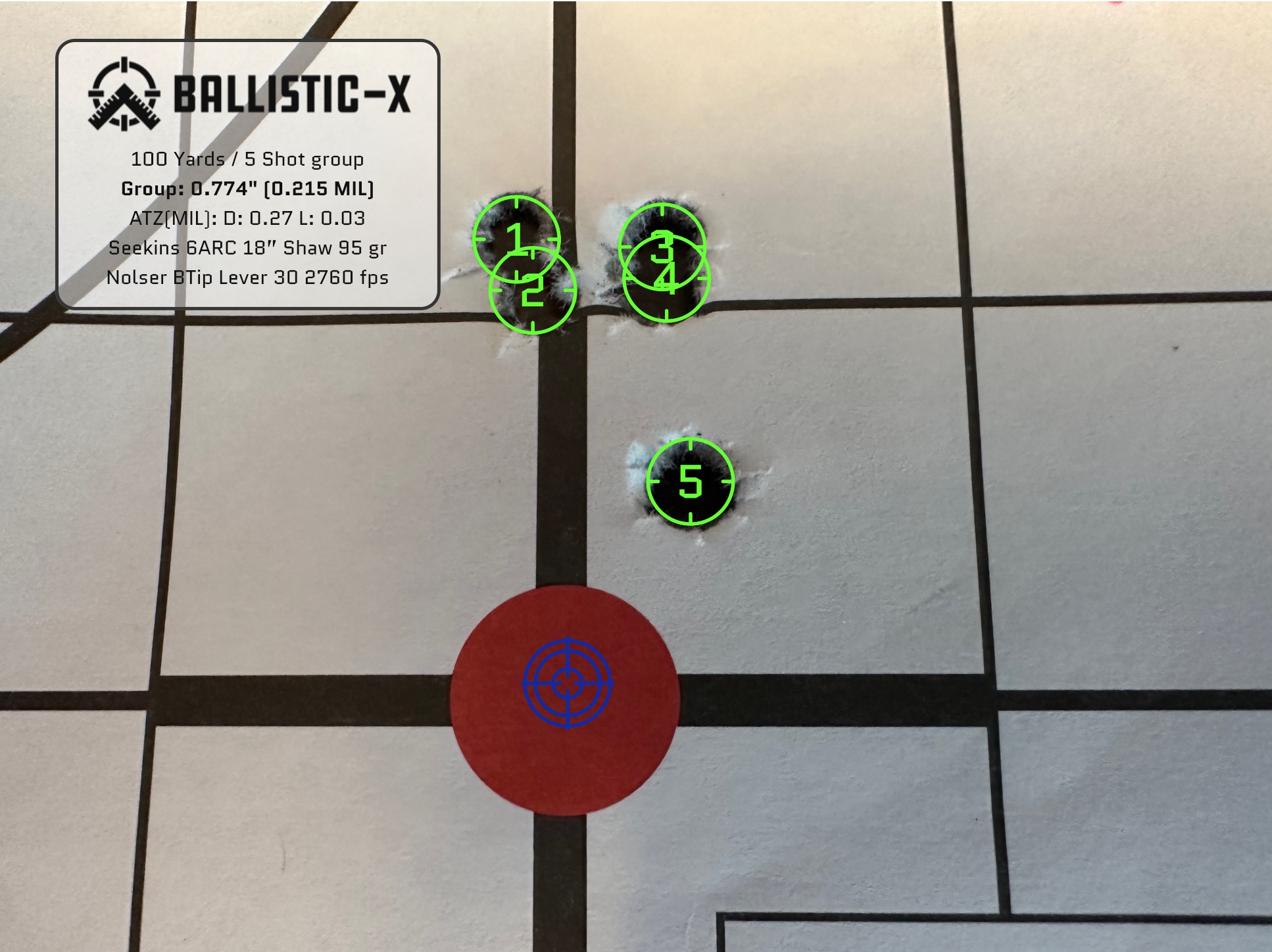

    Nosler 95 Ballistic Tip 30.0 Lever 2760 fps

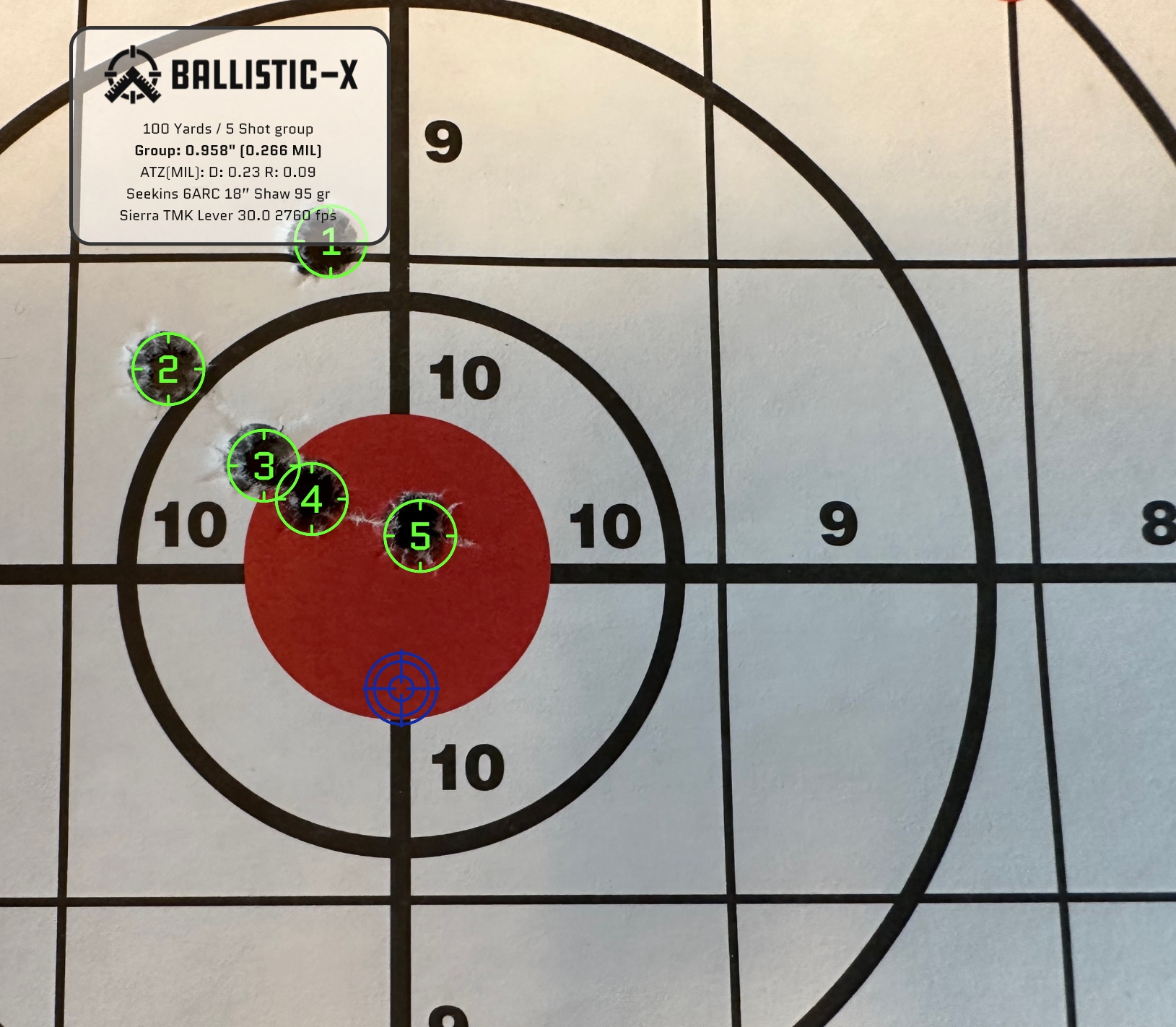

    Sierra 95 TMK 30.0 Lever 2760 fps

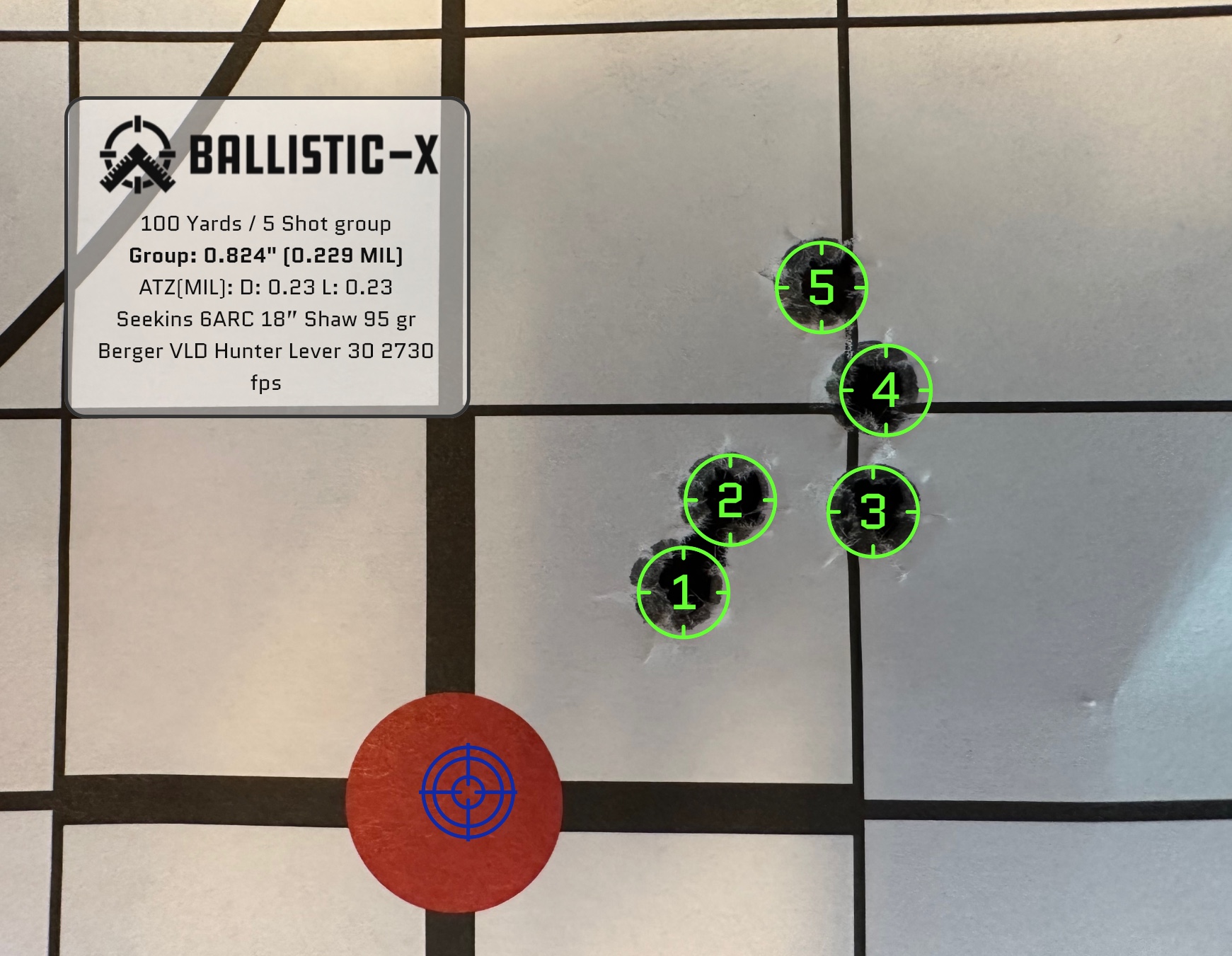

    Berger 95 VLD Hunter 30.0 Lever 2730 fps

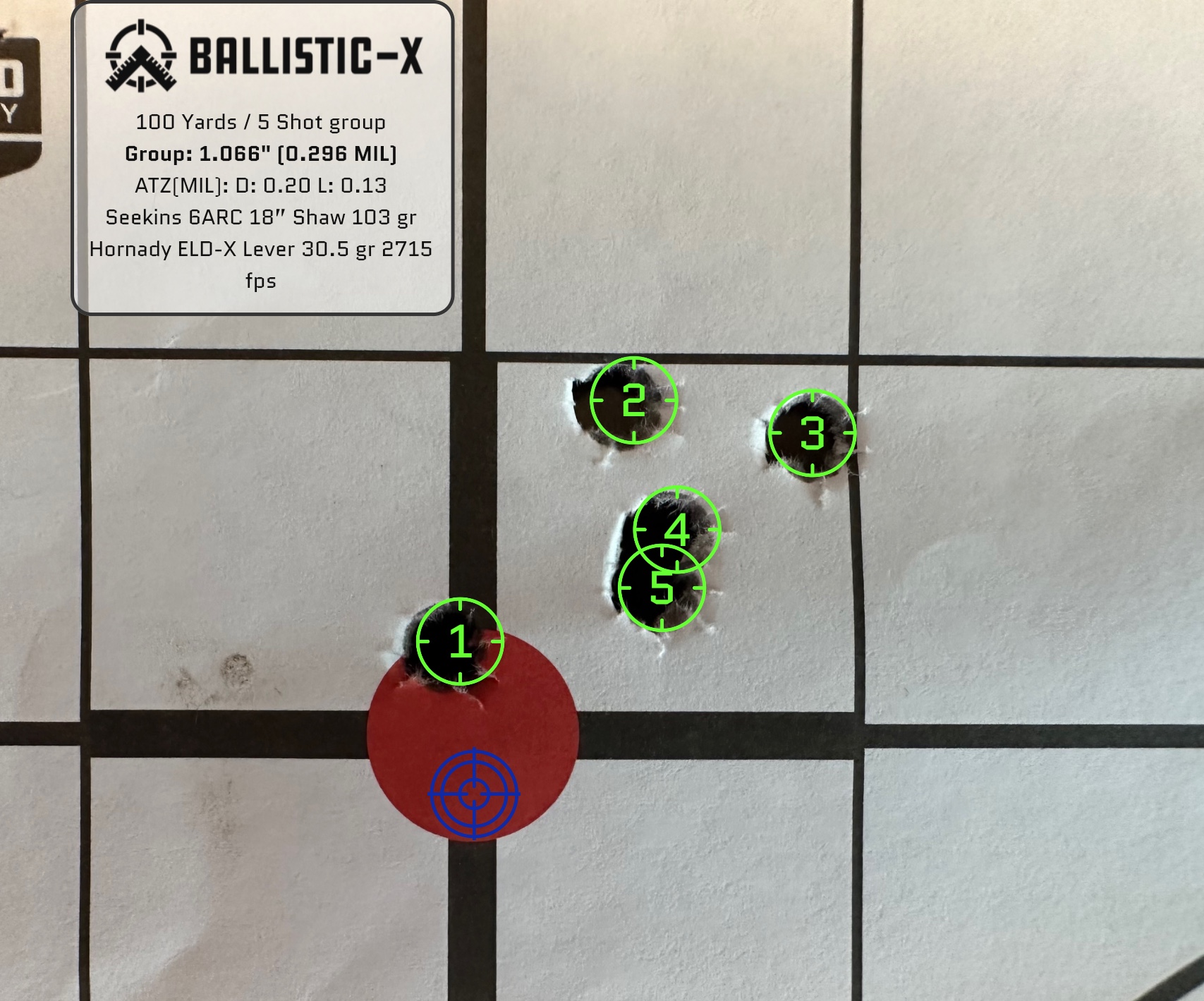

    Hornady 103 ELDX 30.5 Lever 2715 fps
