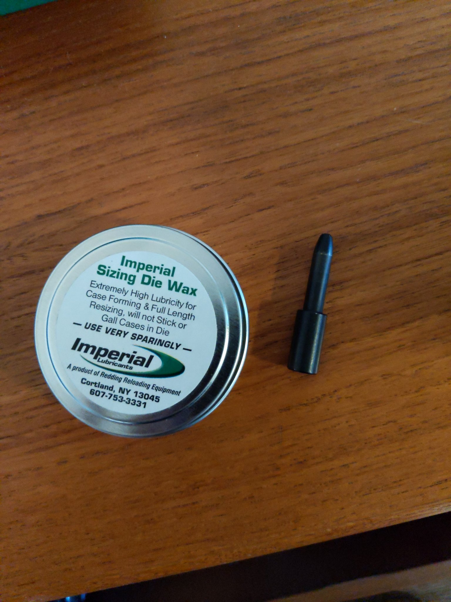

I picked up a carbide mandrel to set neck tension. After how many brass shells do you re apply the wax? I am using imperial sizing die wax to lightly coat the mandrel and then resizing the necks to for uniformity. After about 5 I start to notice a little bit increased in resistance. Is that ok? Should I be waxing every time?
I wouldn't use the wax, it will cause inconsistent neck tension.
Your mandrel might be picking up some carbon off the inside of the necks.
Just wipe the mandrel every so many pieces with a cloth. That should help.
Reactions: bross412
I would absolutely still use the wax. If you feel it in 5 then wax it in 4. Or even better a spray and get them all evenly.
The lee collet, which pinches, is nothing like the expander mandrel, which swages, in operation.
If that’s a 21st Century mandrel, I don’t think it’s carbide. I think that’s their black Nitride.
Yes that's correct. Thanks for catching my mistake... I was looking at the materials and I misspoke before. Does that change the need to lube? If so, what lube and how much.
Wax won’t give you enough inconsistent neck tension to matter.
You’ll have to decide yourself if you want to lube or wax the necks.
Check mandrel periodically. If there’s buildup of brass, knock it off with very light steel wool.

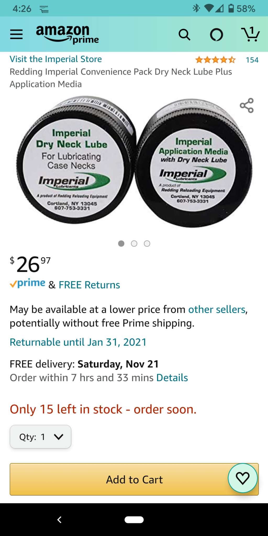

Thanks for all the advice. I picked up some dry lube from Amazon. I will put it on the inside of the case neck and then run it down the mandrel. Should I tumble with dry media after to get rid of any excess lube?
